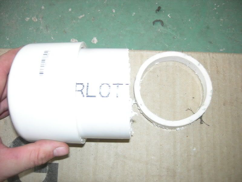

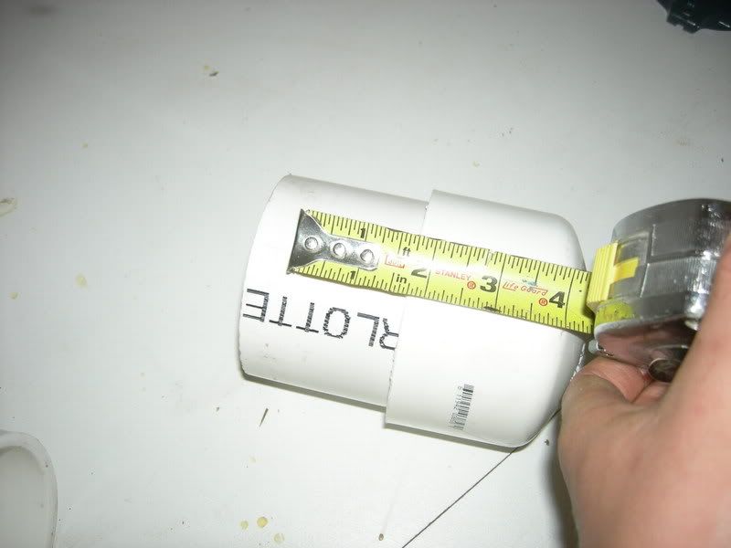

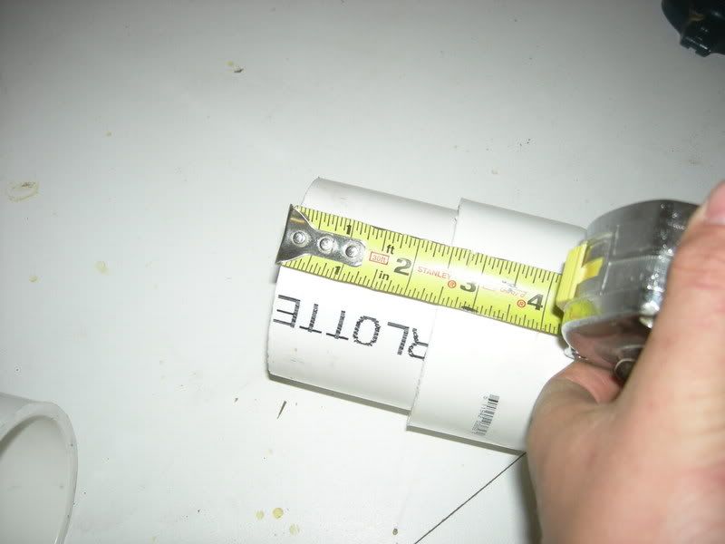

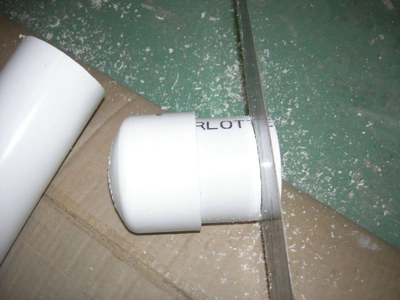

2. Figure out how close you want your caps to be together. They go in about 1 3/4-7/8".
3. Mark and cut.

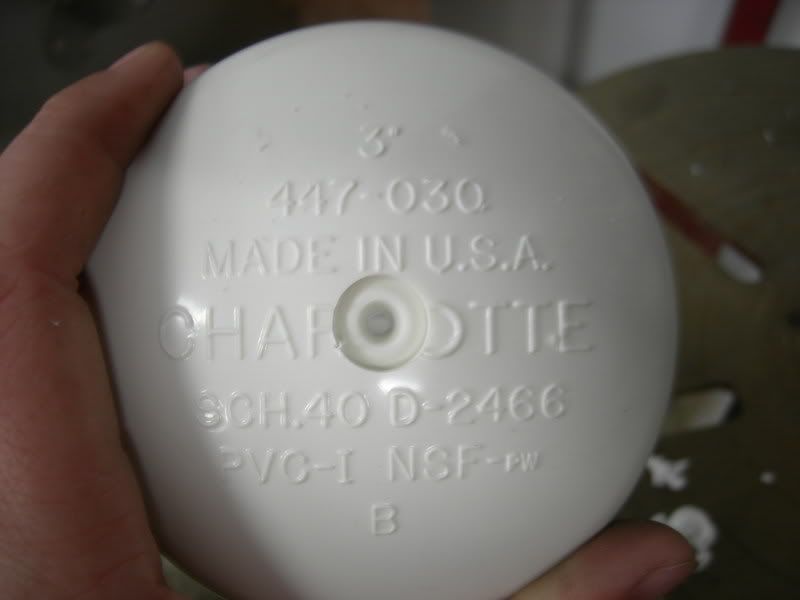

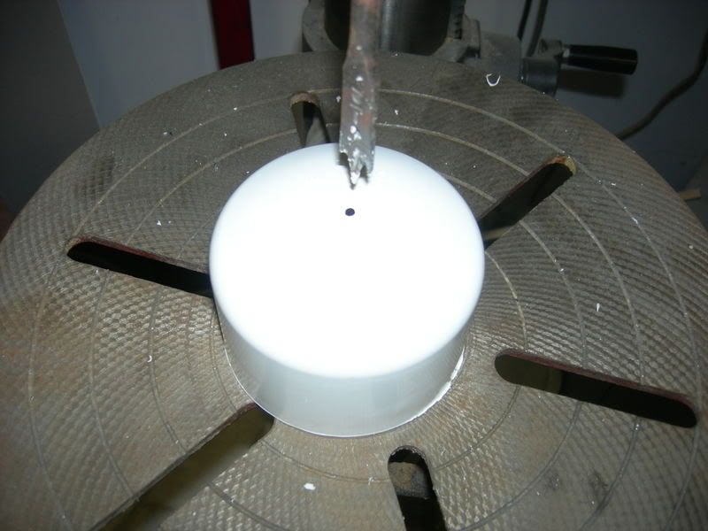

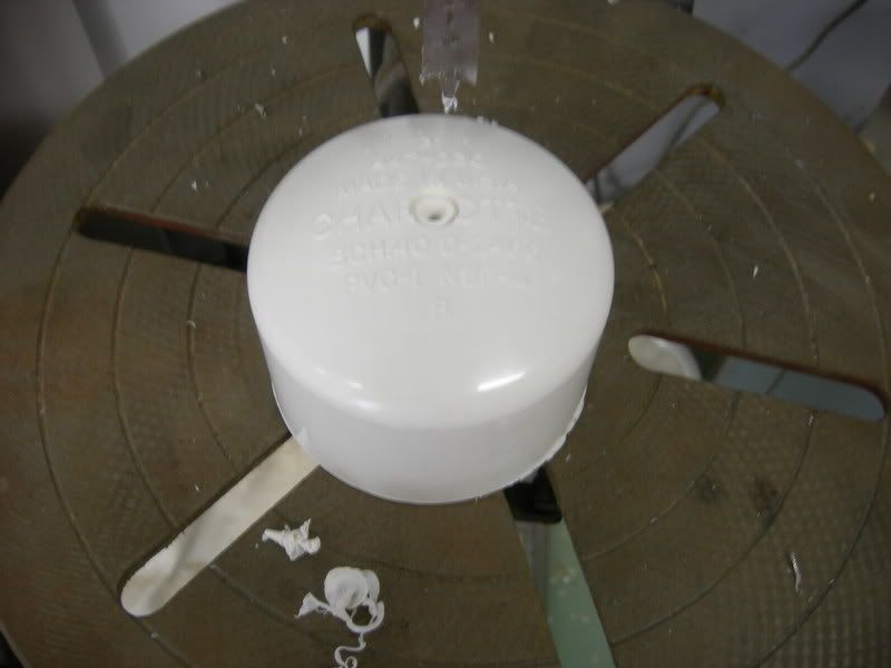

4. Mark the center of the cap on ONE of the caps(the top cap. for ventalation.
5. Pop a small hole in the top. Only about 1/8" is needed.

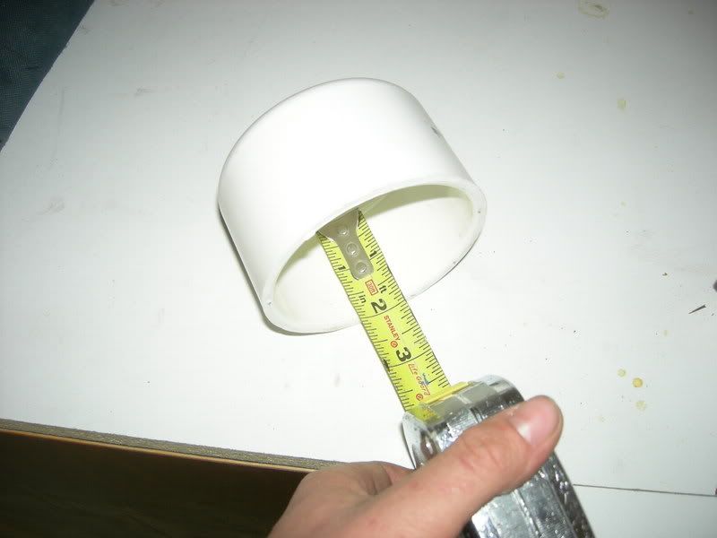

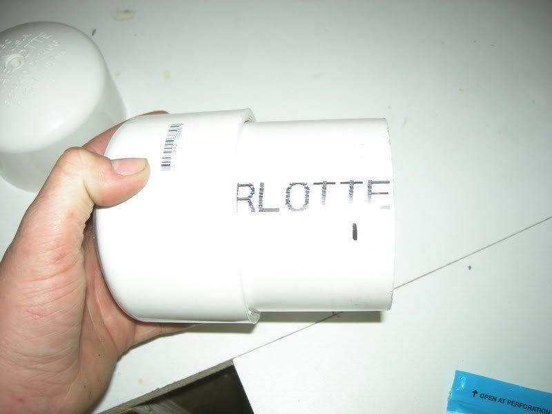

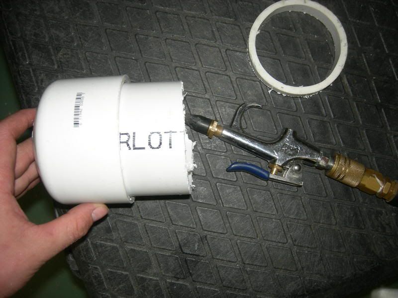

7. Measure the inside of the cap again, and measure the remaining piping from the capped end. This comes down to personal decision- How much gap you want in between the caps.
On this can, I opted for zero gap. So I marked it, and cut accordingly.
8. A quick blow job to remove the shavings. ;)

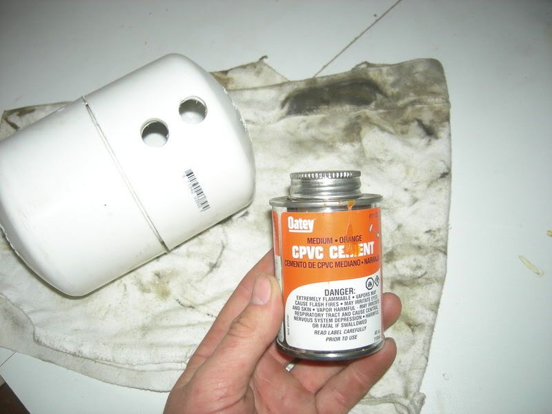

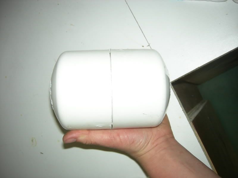

9. Then, again if you want to cement it- go for it, slip on the the other cap.

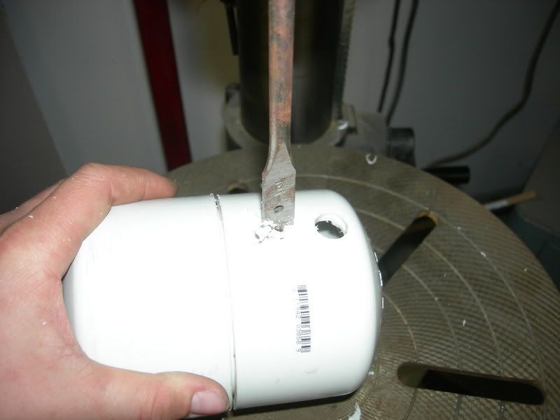

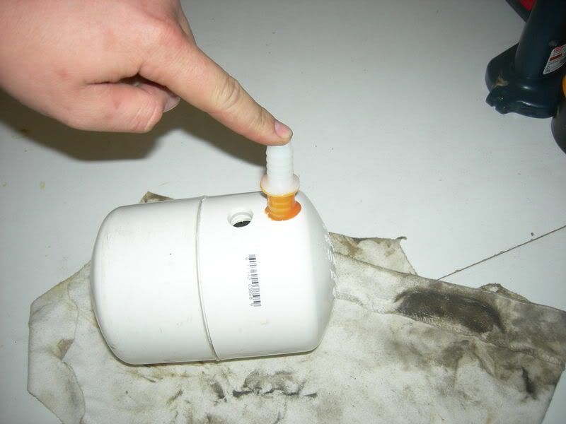

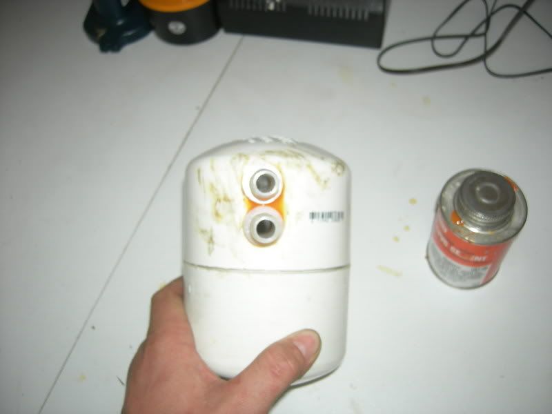

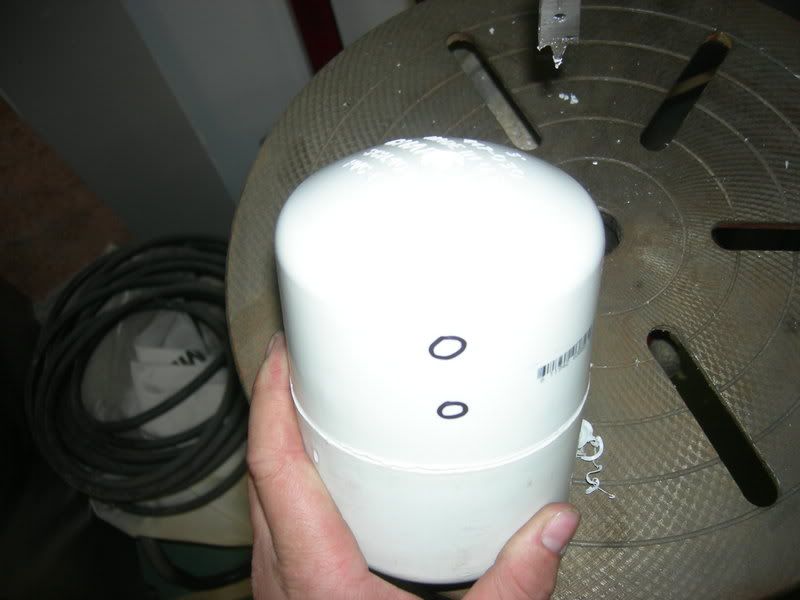

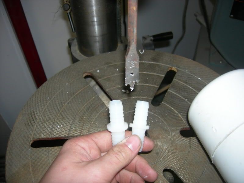

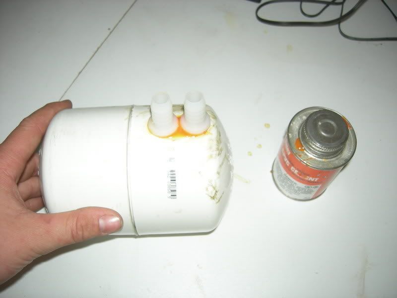

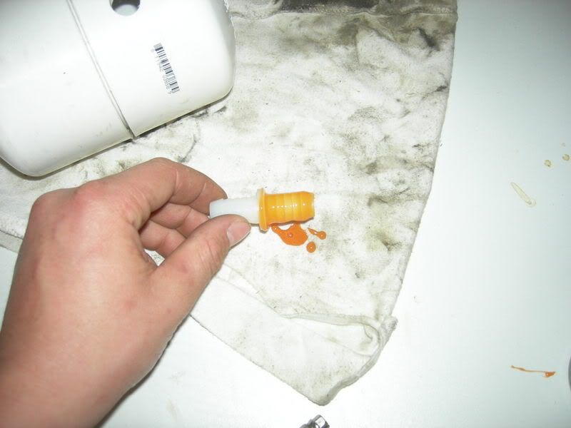

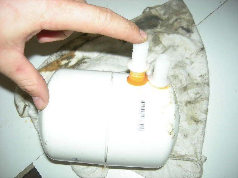

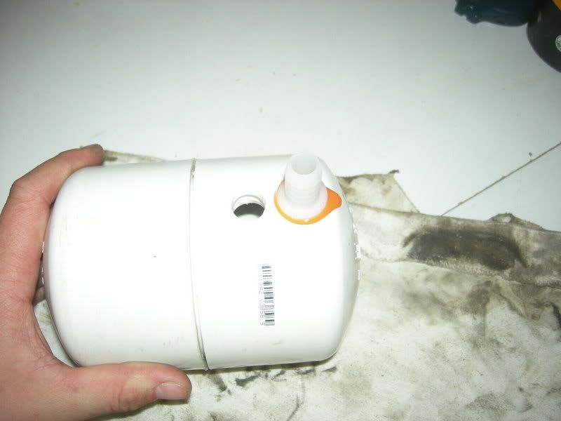

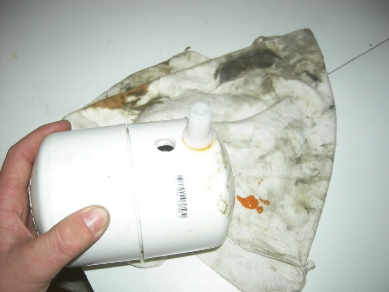

10 Bust out the hose barbs, mark the can where you want them to go, and drill them out.
461 Posts

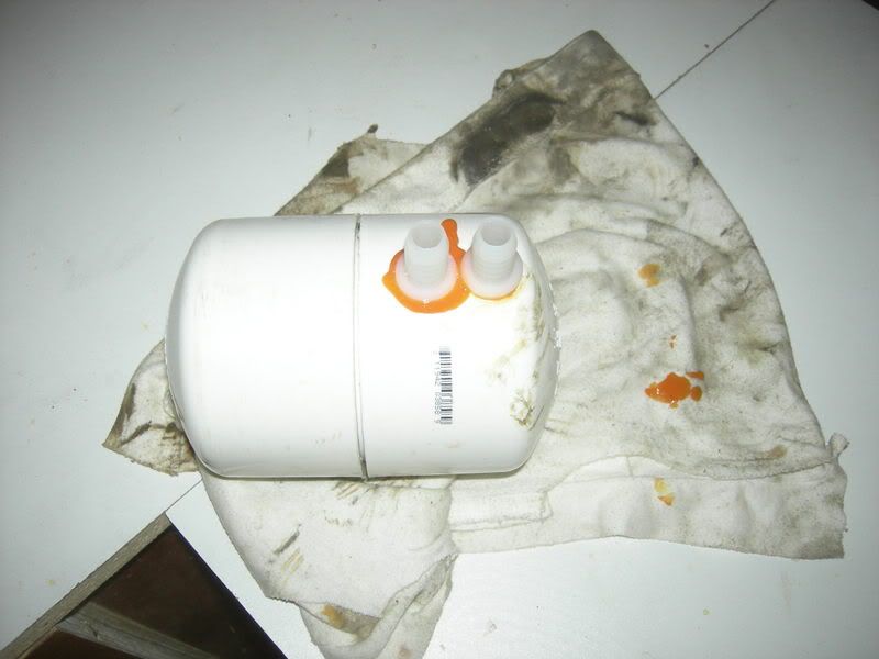

12. Clean it and your done with the construction!

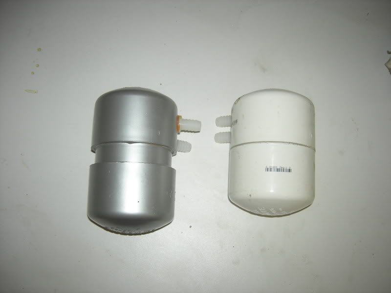

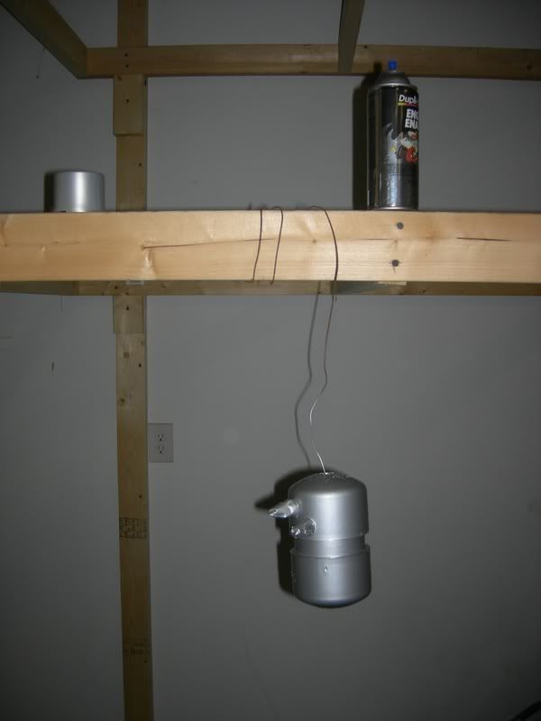

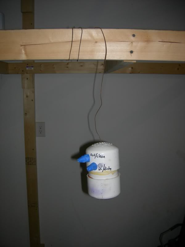

13. If you want color, tape off the barbs, hang it up(I just shoved some wire in the vent hole.), and spray it with lots of thin coats.
14. Final product. Heres the 2 models I've made so far.
I can make anyone a can with any design/paint you choose. PM me if interested.
Comments welcome.
