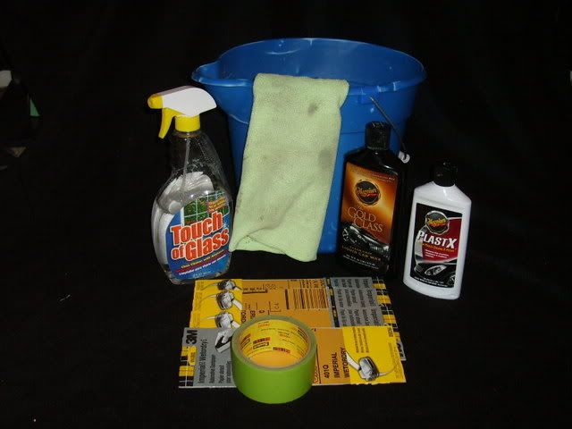

This how to is for renewing your hazed cloudy headlight to like new condition. heres a list of items youll need:
maskin tape (not needed if you remove your lights from the car)
bucket -O- water
superfine grit sandpaper packs (800, 1000, 1500, 2000, 2500)
spray bottle with water(i did this at my apartment) or a garden hose
some type of headlight polish (mothers, meguires, ETC)
your fav choice of car wax
your fav choice of wrags or cloths i prefer micro-fiber
heres the before pic
-first begin to tape off the area around your lights to avoid scratching your paint or remove them but i was lazy and kept them on the car
next get your bucket and fill with water cold warm hot whatever you fell comfortable with and throw in the 800 grit sandpaper let it soak for a couple minutes
-then fold the sandpaper in to thirds and get to work. spray down the headlight with water begin wetsanding lightly at an angle / completly then at the opposit angle \ .make sure to keep the surface wet while sanding. this stepp is just to remove the roughness from the hazing and oxidation. and throught the wetsanding process you will notice the chalky mess and the headlights will look the same
-now throw the 1000 grit in the bucket and let it soak for a few. then fold into thirds and wetsand in the same cross pattern and making sure the surface is wet and gets completly and envenly sanded.
-repeat this same process with the 1500, 2000, and 2500 grit sandpaper.
-after that wipe down and wash the wetsanding mess off the car and or lights
-apply your headlight polish and let it set for a minute or 2. then buff off with your wrag cloth or what every i used micro-fiber cloths cause i love them. you may need to do one or more times to get the shine you desire
-now your seen some results, apply your choice of wax to the light and let it dry to a haze the buff off and clean up any excess off the ligths and or car. step back and check em out
heres my after pic
sorry but these were the only pics i took during this process. thanks for lookin
