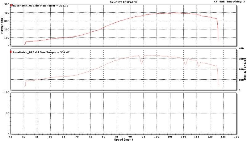

Set-up as follows
Stock y7 head w/ valvetrain Skunk2 IM B16TB
3Bar map
Greddy profec-b old style
rc750 injectors
autoworks a/c turbokit w/ log mani
2.5"-3" Dp ebay 3" catback
57trim T3/T4 turbo w/ 38mm tial (14lb.spring)
innovative trans and motor mounts
XTD stage 4 clutch and flywheel
eagle/vitara combo 75mm
arp head studs oem headgasket
tuned on crome
268hp/[email protected] pump
340/[email protected] 116race
Think thats it. May be forgetting something

i think if you switch to a cast manifold if your worried about AC or something better you will see a pretty decent gain. The SS log like you have is a really nice piece but only so far. Id also look into a bisi 1.2 cam for no/minimal head work or a 2.4 for a worked head. With the cam alone you could probably see a really nice gain.
