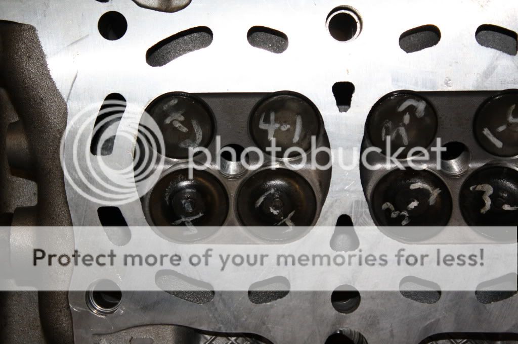

Here's some progress pics
Vitara piston out of the hole .005
Still some clay on it from checking the valve clearance. Plenty of room for a bigger cam later.
