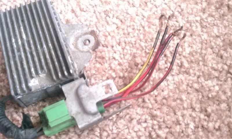

Ok... i just bought this resistor box from a guy on craigslist for 10 bucks. i think it was a good deal. but the question is how do i connect it to my injectors and ecu?? i read and searched but couldnt find any answers so i decided to register here and see if anyone can help me. so... this resistor has 4 red and black wire and 1 yellow and black wire. i read that other resistor had 4 yellow and black and 1 red wire. but this resistor is the opposite. do i wire the red and black to the injectors and the yellow and black to the ecu? thanks. I posted up picture of the resistor box.

yellow/black gets 12 volts switched and the 4 red/black wires go to the yellow/black wires on the injectors.... you need to find the injector power wires and cut them to add in the resistor box....
