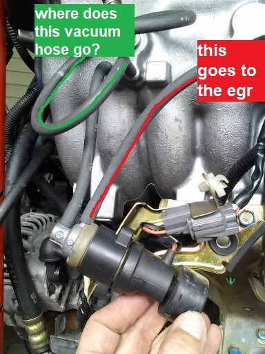

i have a d15b 3 stage stock p2j intake manifold 3 wires iacv and i need your help to know where each hose goes
I modified the photo so that you can understand what I need to know
* where does hose 1 go, the one that is over the thermostat?
*where do hoses 2 and 3 of the iacv go?
*where do hoses 4 and 5 of the connecting pipe go?(I don't know if the connecting pipe with 2 nipple is the stock in the d15b 3stage or if it uses another one with a single outlet?)
Where does the hose that comes out of the intake go? the one marked in green (or maybe it is not used in the d15b 3 stage considering that it is jdm?)

I'm pretty sure it is not part of the D15Z7 IM system, but if anyone else knows better please correct.
According to the vacuum schematic on page 11-B-106 of the Portuguese service manual it does not seem to connect that line to anything. But I only have that chapter translated, so there may be something else going on.
