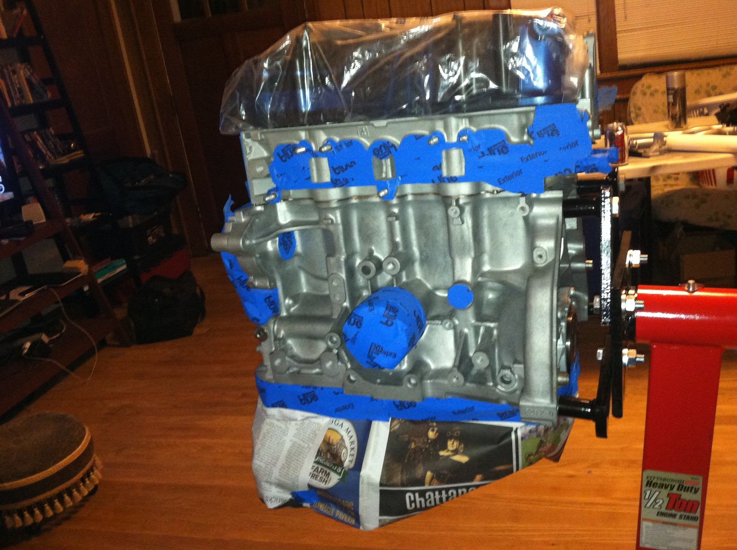

z6 block/crank
D16 eagle h Beams
SRP A6 pistons -2.9 dish
ARP Studs
.066 cometic head gasket. i know its pushing it.
y8 head with y7 internals
ferrea 5000 valves
SOHC ZC trans with LSD conversion (rebuilt by whoopdee doo racing)
action clutch 2Md if i remember right
custom 0bd0-1 conversion harness (by 2JZdreamin)
innovative mounts.
rebuilt starter
130 amp alternator
skunk2 intake
OBX headers
HKS exhaust
completly rebuilt shift linkage.

Seeing the cleanliness of the engine assembly makes my balls wet. Good job on that!

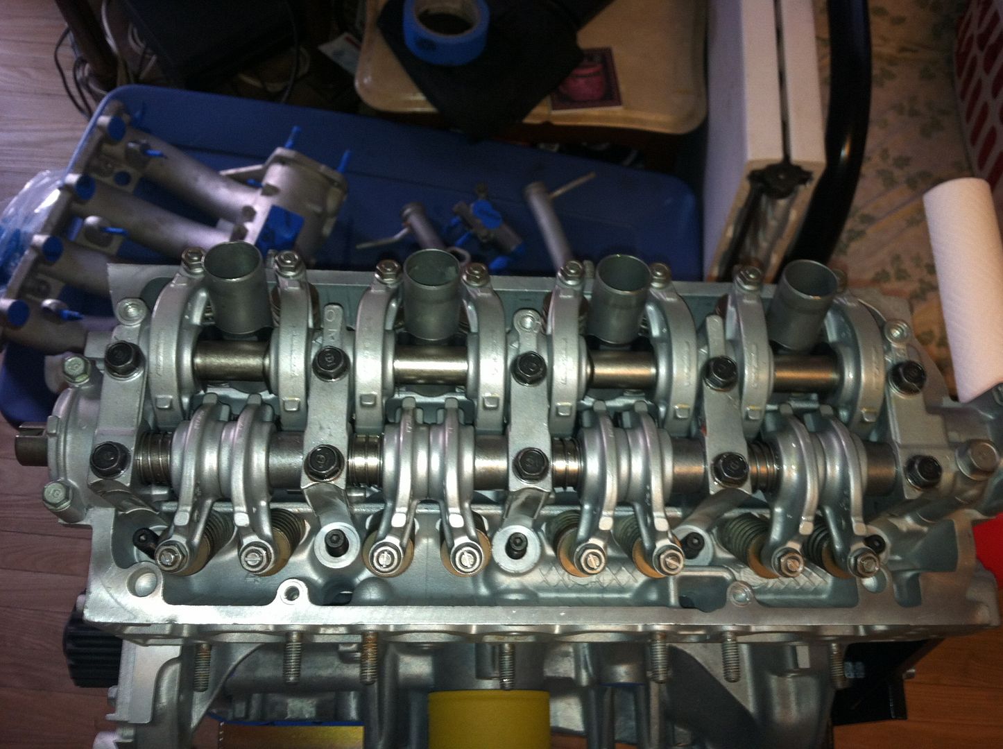

That HG in the pic doesn't look like the cometic I used, judging by the coolant holes. Who knows, maybe they stepped up their game and followed the design if the Y8 HG holes
And yeah, header wrap is a pain in the dick. You'll learn real quick to wear a mask , gloves, and a long sleeved shirt!
Hopefully this is just a toy and not a DD as that header wrap on the downpipe can easily lead to rust and corrosion if it seems any amount of water on it

hey thanks man... i was really trying to build the cleanest little d-series i could. the HG is a true cometic, i didn't even notice the holes until you said something. i watched a bit of a tutorial before i did the header wrap
it really helped getting the basic concept down, but i still got ate up by the fibers on my arms. itches like a bitch! good looking out on the rust on the wrapped header i didnt know that. +

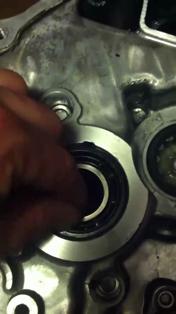

when i got the clutch to engage the right wheel would not spin, but the driver side was good. thought it was a stuck caliper so i smashed it down. nope so i tried to use a breaker bar for leverage and applied light pressure to turn the axle. nope, didnt budge. i stopped at this point because i didnt want to ruin it any further.
https://www.youtube.com/watch?v=W6B4hQyDzfA
