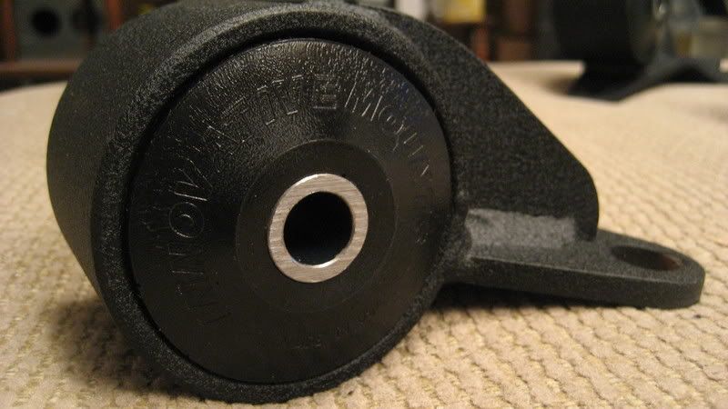

Innovative motor mounts

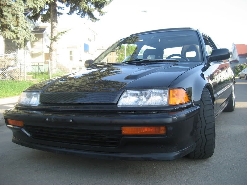

Vis ZC Carbon hood
amber corner and bumper lights

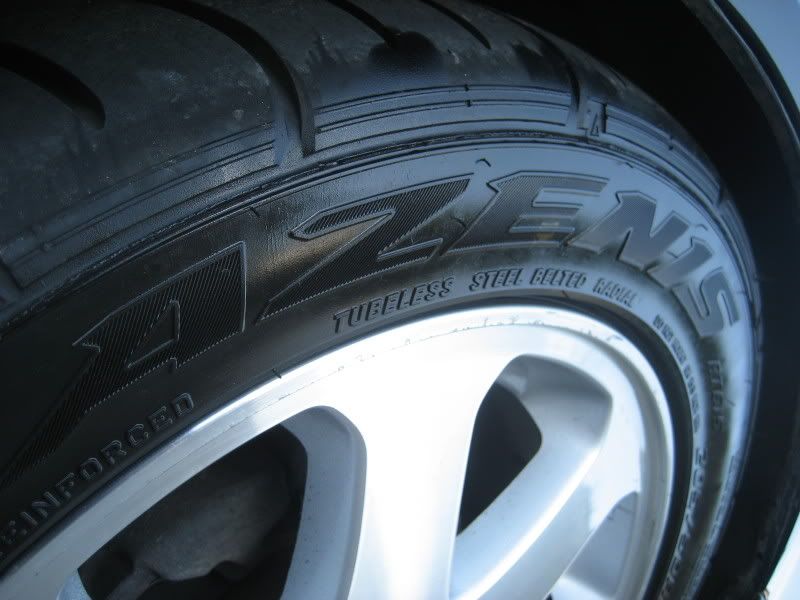

99/00 si/sir wheels wrapped in falken azenis 205/50/15

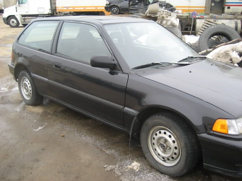

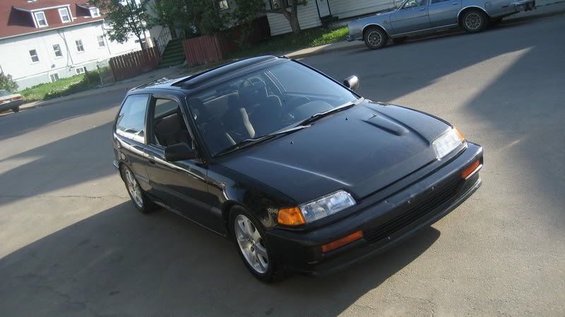

i originally picked up a beat up 90Si hatch in june 06 and drove it up until april 07, at which point i found another minty, essentially
much rust free 90Si hatch instead, so heres what she looked like when i picked her up.
Nasty ass wheel gap!

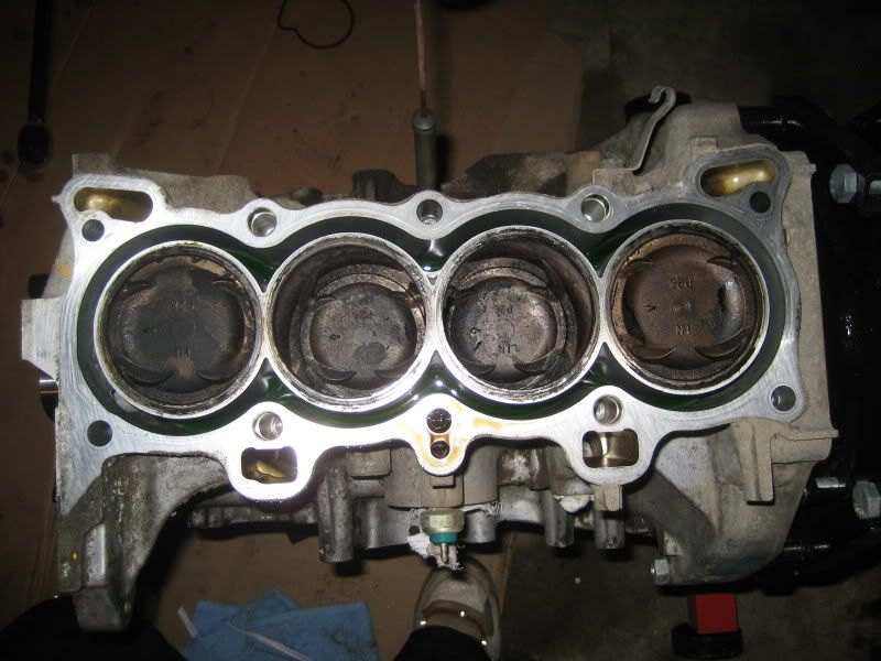

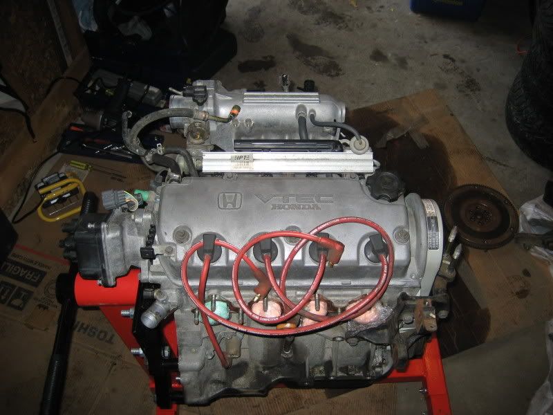

The engine on a stand, about half way through the tear down, as the swap came complete with a hydro tranny, harness, dizzy etc...i wrote up a little power point on what i did to tear it down, as i didnt know fuck all about engines. all i had was some basic tools, the manual a digi cam and i wrote down exact instructions on how i took everything apart. I also wanted to do the entire rebuild myself, but i decided against it, as it seemed pretty hard and i didnt have the time, tools or patience to do it all.
Behind the block
Valve cover off, the engine had about 200,000km's on it when i picked it up
Head off
Intake mani all dirty
Fresh outta the hot tank!
1990 Civic Si
1,252 Posts

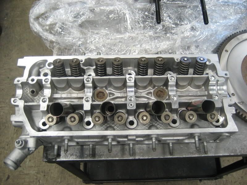

Head also fresh outta the tank! with stock components except for new valve stems

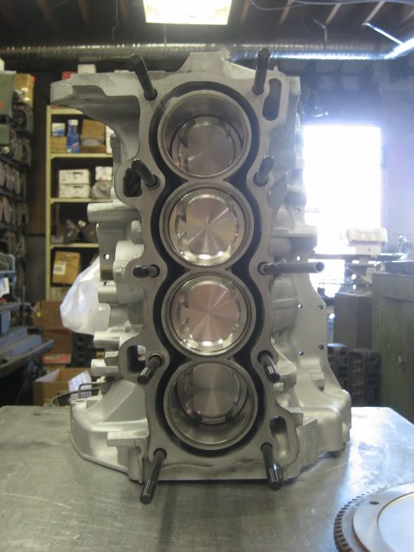

Bottom end assembled, new parts include 9:1 SRP 0.02 over pistons, Eagle H-Beams, new oil and water pumps, timing belt, all new gaskets and ARP headstuds.

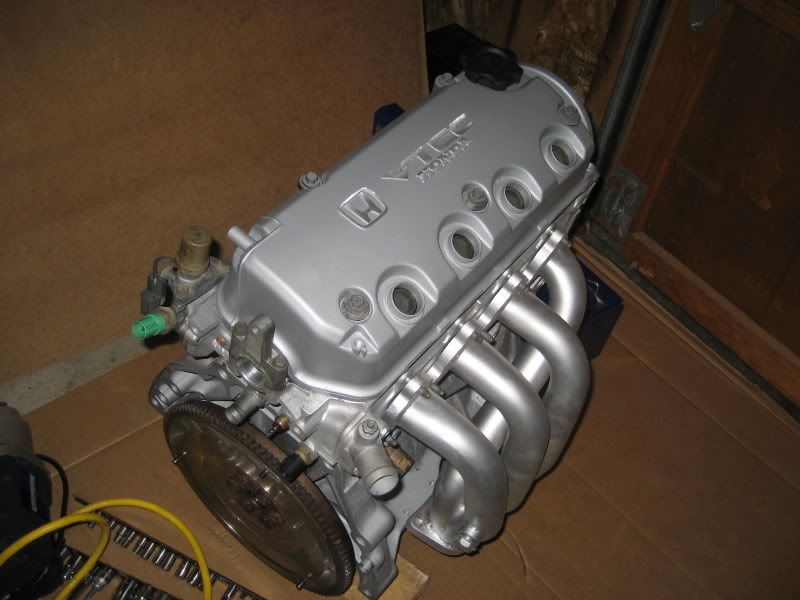

How she looked when i took her home, with fresh machined OEM flywheel,an ACTION 2KS clutch will be mated to it during the swap, and also a cheapy egay header.
Unfortunately i dont have any pics of me and my buddies doin the swap just after it was all finished, i have the nice g-lean goin on lol. Other swap goodies included new NGK wires, NGK plugs, a Rywire OBD-1/Vtec conversion harness, and cheapy homemade intake

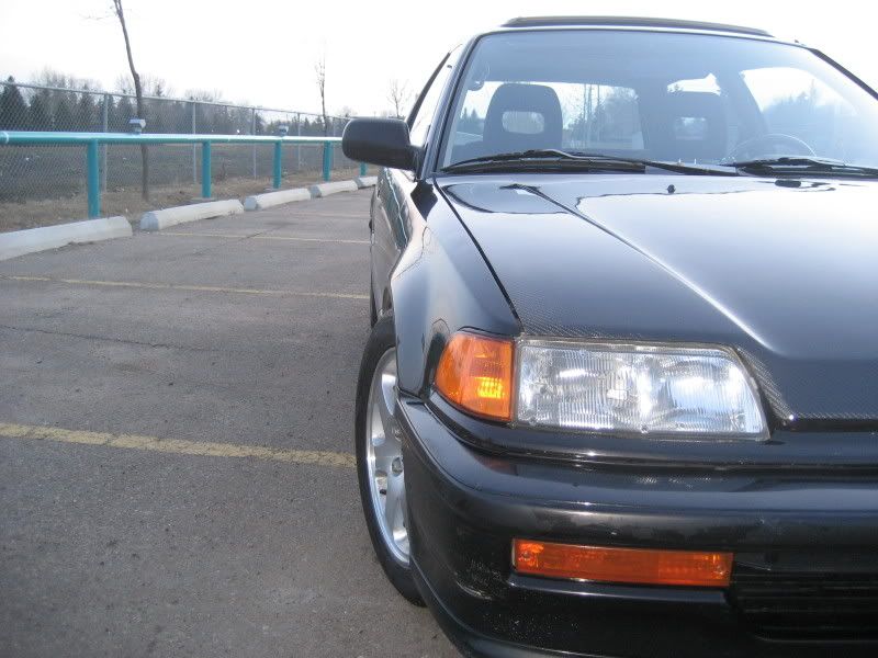

Installed with painted amber bumper lights as well, i used TAMIYA model paint, its called CLEAR ORANGE, i got it in a can for easy application
At night with some Sylvania Silverstar Ultras

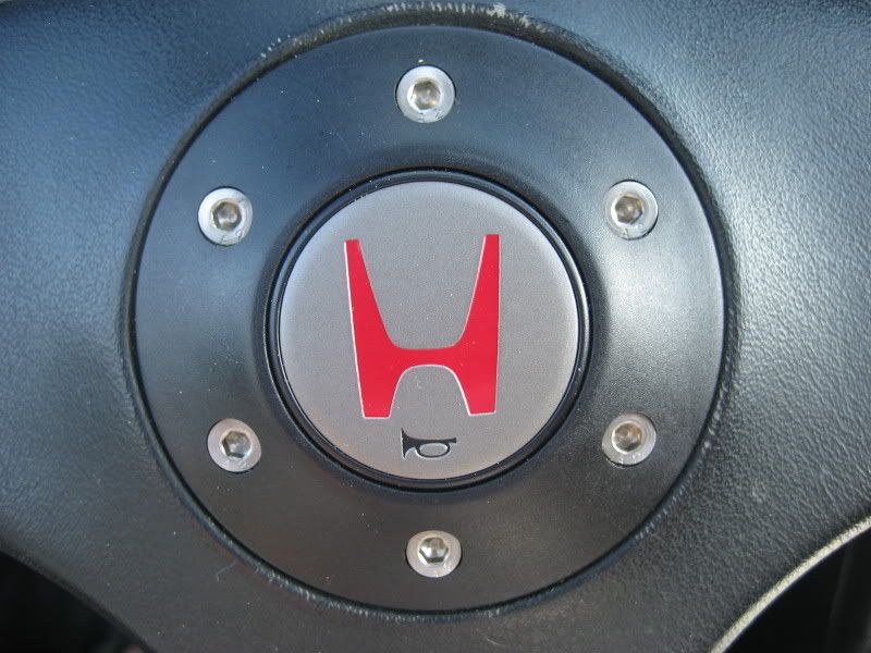

Skunk 2 Weighted Knob, with matching DC2-R shift boot and non-srs wheel with a fresh horn button cause the other one was worn out like a dirty hooker. A side note on the wheel, it fits in with no real issues all you have to do is take out your signal canceller, so you have to turn it off manually. theres a short shifter that came with the car when i got it, i think its a B&M...also just installed some ES Poly shifter bushings! Also found out that my shift linkage was installed improperly when it was converted from auto to manual, but that has been fixed and she shifts so much better now!

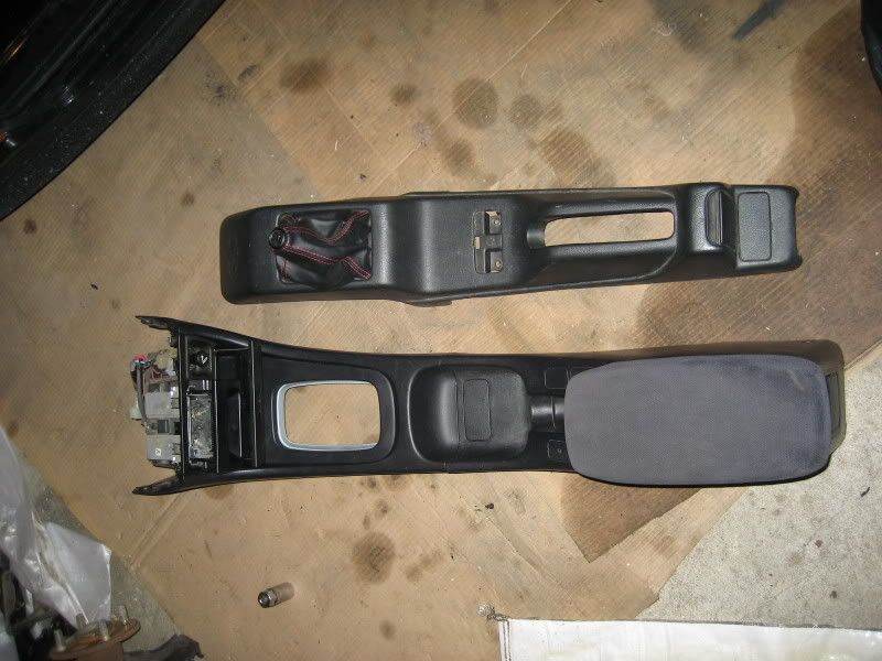

DC2 console! thats right i gots mutha fuckin cup holders and an armrest!
Installed! it bolted up near perfect, the screw hole on the right side fits up with stock mount and i had to drill a small
hole for the left side

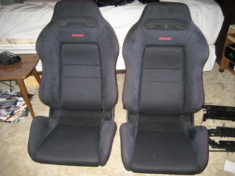

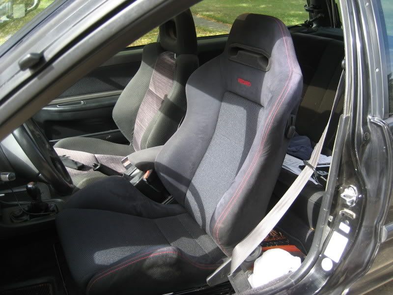

Dc2 Black and red stitched Recaros
Drivers side installed using brackets from Wedge Engineering and universal Recaro rails

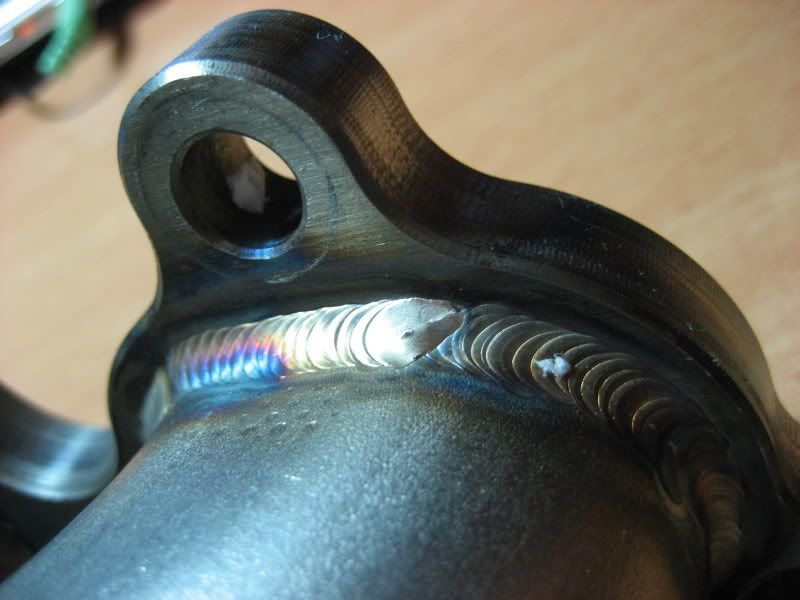

Log mani
Nice welds!

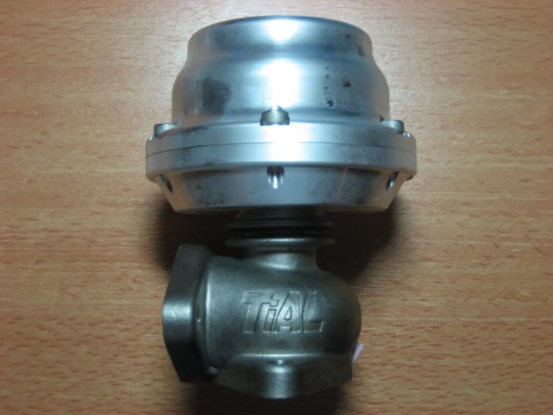

Greddy BOV and Tial WG

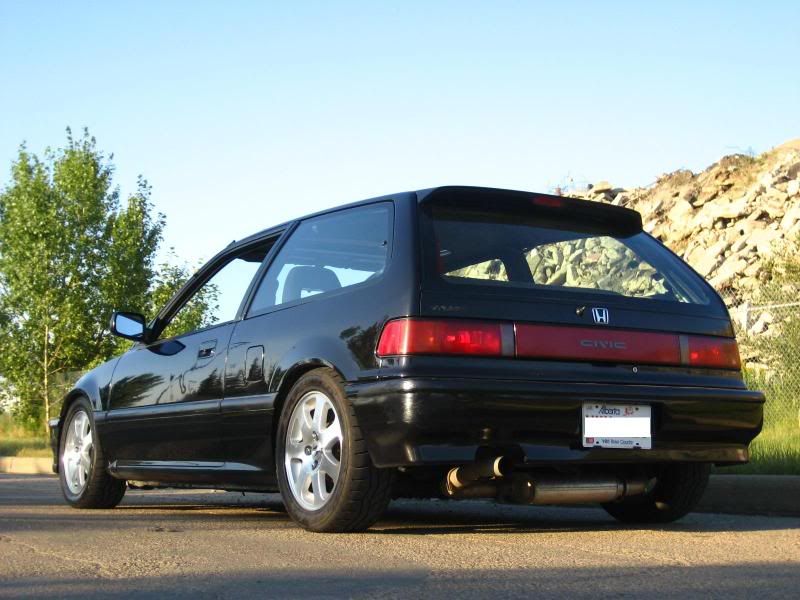

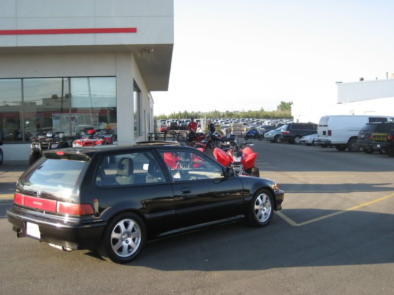

WOOHOO! 500th post! :bong:.....Fresh after a wash and polish, oh ya the exhaust is a 2.5" mandrel bent pipes with a dynomax super turbo
Some other pics....
well i guess thats it for now, ill update this thread as i move along! thanks fo' looking :)

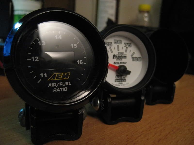

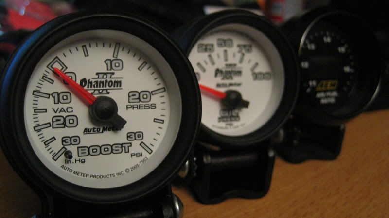

so there was a sale on autometer guages today so i figured it would be a good time to grab a gauge or two. Ended up with a Phantom II electric short sweep oil pressure guage (full sweep was a $100 bones more!), and a mechanical boost/vac gauge, which wont be in till next week. As well a couple more gauge pods. heres a shot with my AEM air/fuel gauge.
i think ill be getting the fuel pressure gauge in a month or two.
my ultimate goal with these is to somehow rig them into my glove box, for a nice stealthy look :TU:

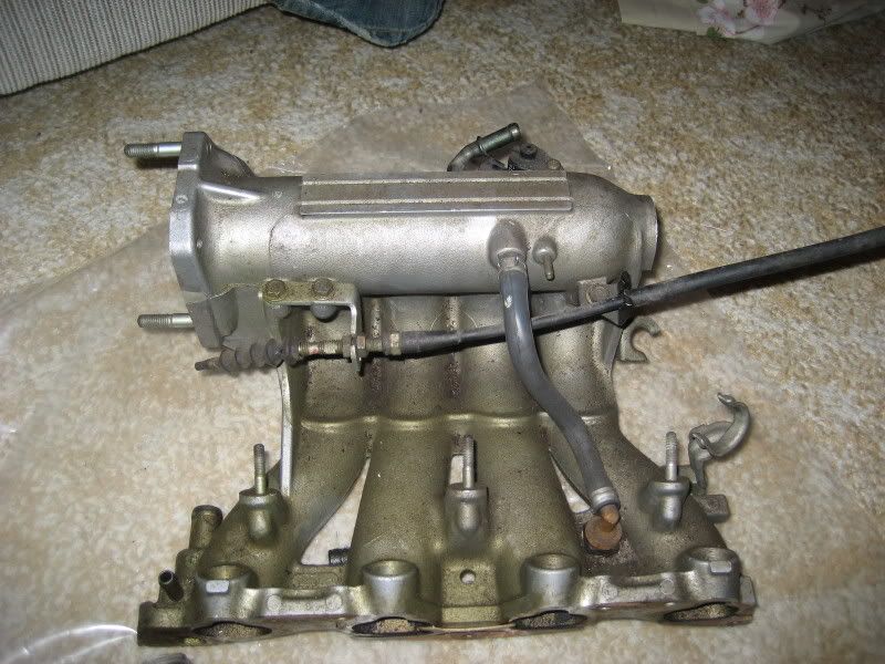

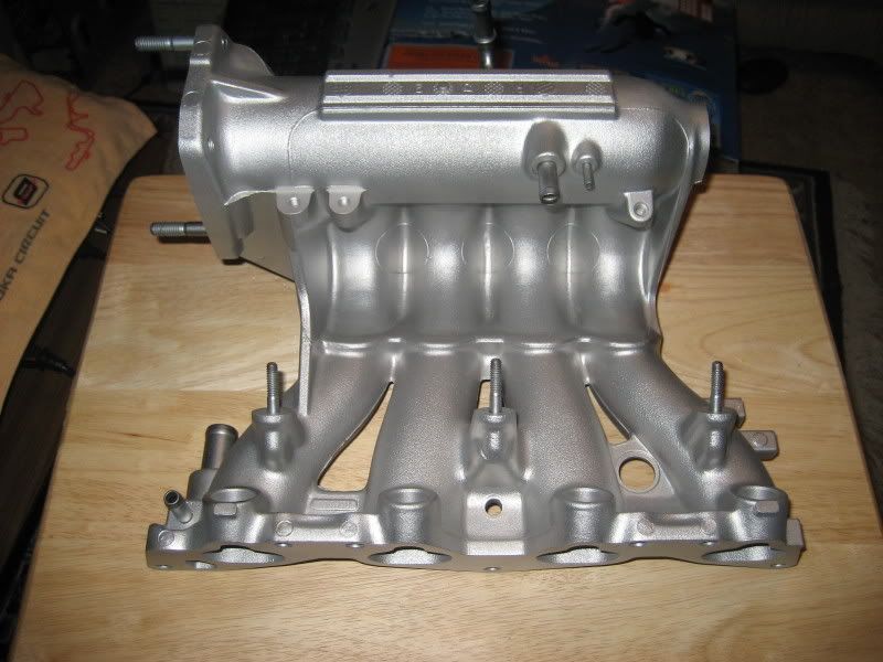

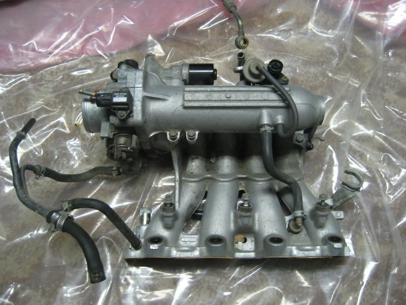

just picked up a spare Z6 head (no valve cover, vtec solenoid is still there tho) and intake mani today, got it for $60 bones!
one of the studs on the exhaust side is bent, and its pretty grimey. i hope its not warped, but the guy said he did the proper sequence to unbolt it....
not sure what im gonna do with it, bought it just so i can learn about how to take it apart and put it back together, i never got a chance to do that the first time round.
maybe down the line go for KMS valve train setup from FJT :TU: and a port and polish...i dunno. anyways i think the learning experience will be worth what i paid

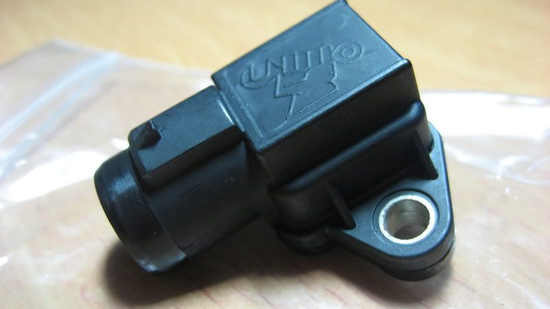

yeaaa! got my Omni 4 bar plug and play map sensor today! thanks to Jason at Rage and also to 4thGEN for setting up the group buy :TU:

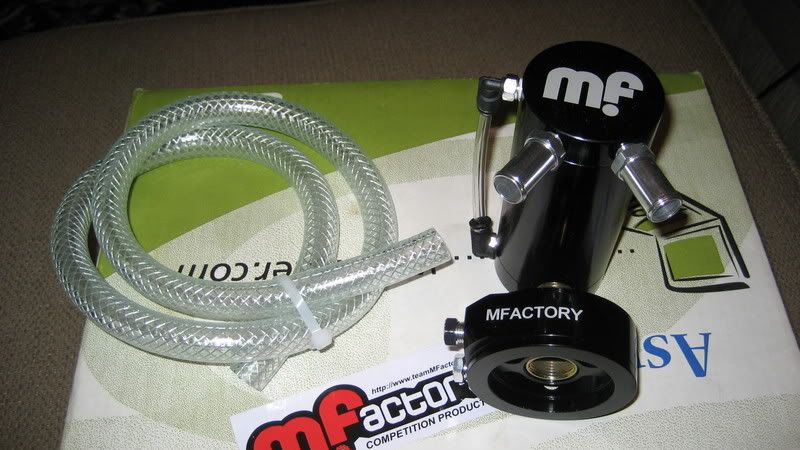

also just put in an order to Mfactory yesterday for a oil block adapter and a catch can, the catch can is on back order so wont be getting it for a few weeks.
