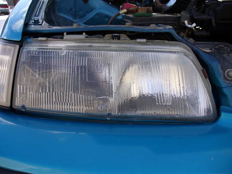

locate your low beams.. so incase you didnt know before, the low beams are on the outside
now pop ur hood and find the bulb
easy right?

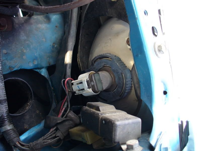

step2:
in the above pic, there is a plastic holder holding the bulb in, grab hold of that thing and rotate it counterclockwise to open it up, dont try and pull it off or anything.
once it is loose, pull the 9006 bulb out. it may take some wiggling. then unplug the clip

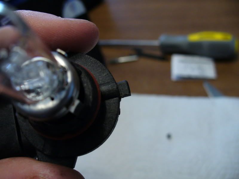

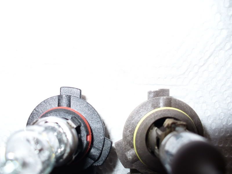

ok now if you look down at the 2 bulbs, they have a slight difference.
uh oh the top tabs are different.. the 9006 is like this so people wont mix the bulbs up, in our case making our lives harder.. so i used this bad boy:
to cut the tab down to fit the holder thing... i used the little bump in the base of the 9005 bulb as a 'guide' sorta

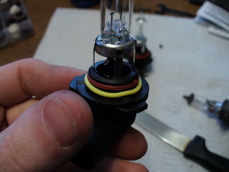

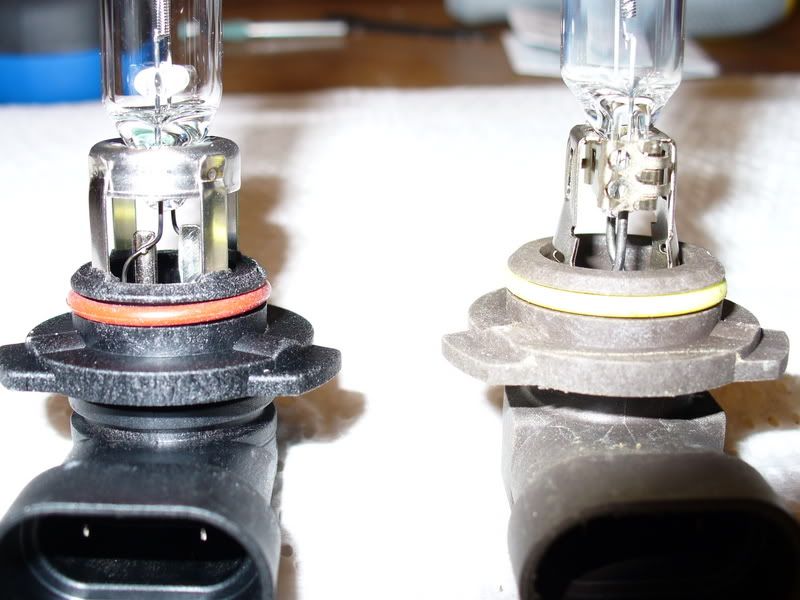

now if you look at your new 9005 bulb and the 9006 side by side:
you may notice the 9006 is fatter than the 9005 is at the base. simply take the yellow o-ring off the 9006, and slide it down over the 9005 to fatten it up a bit:

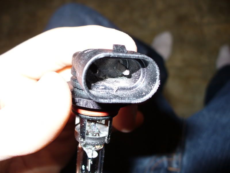

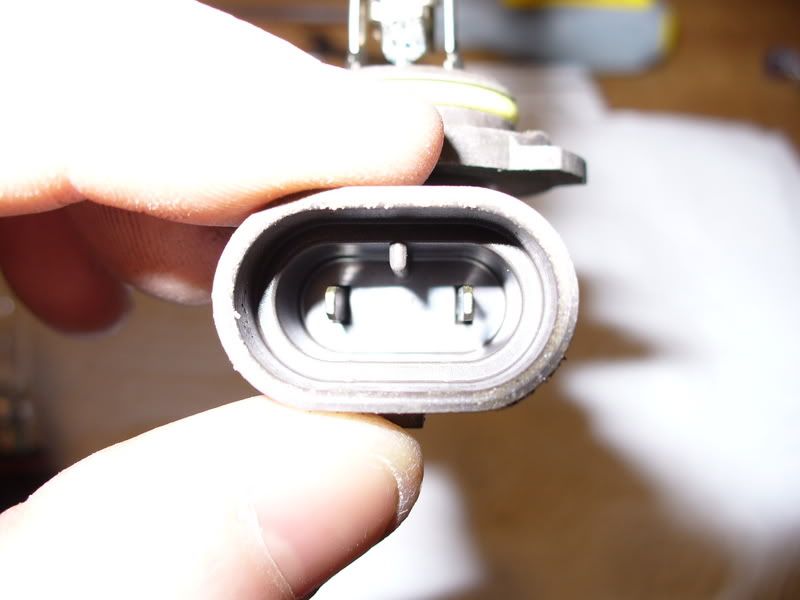

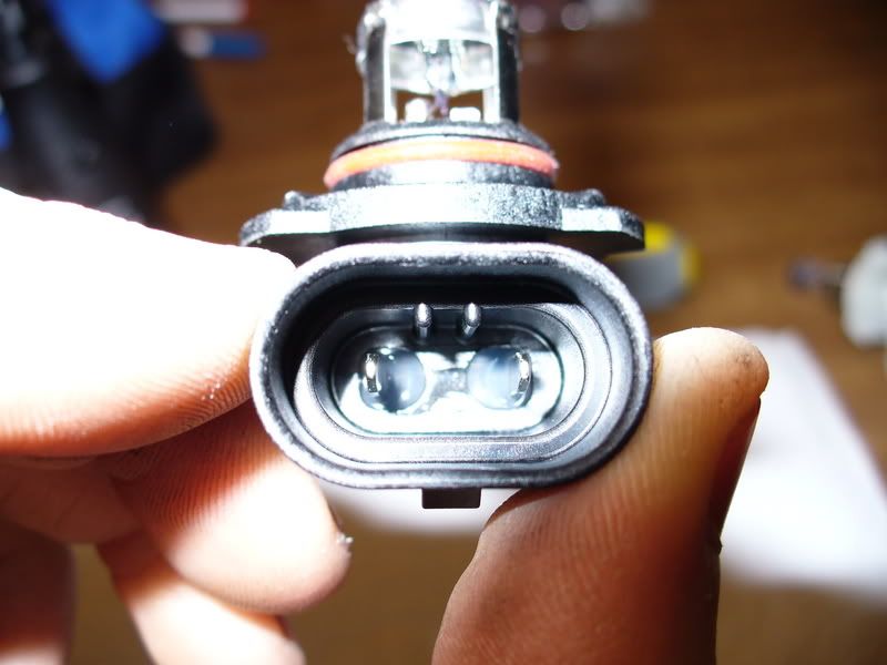

ok now thats done, take a peek inside the clip end of the bulb...
9005:
9006:
see the difference? the 9005 has 2 little prongs and the 9006 has 1, again so people dont mix the bulbs up.
now there are 2 options here. option 1 being go to a junkyard, and get the high beam clips off of another ef and solder them in place, or option 2, cut the damn things out

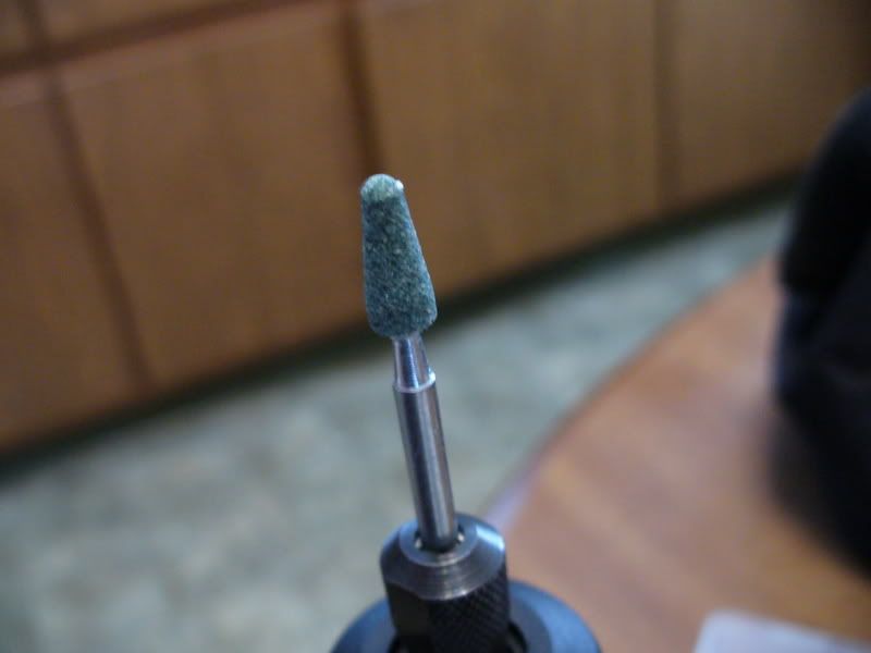

i personally chose option 2 here.. so i equipped my dremel with this:
and then i cut down the 2 prongs to make it like this:
