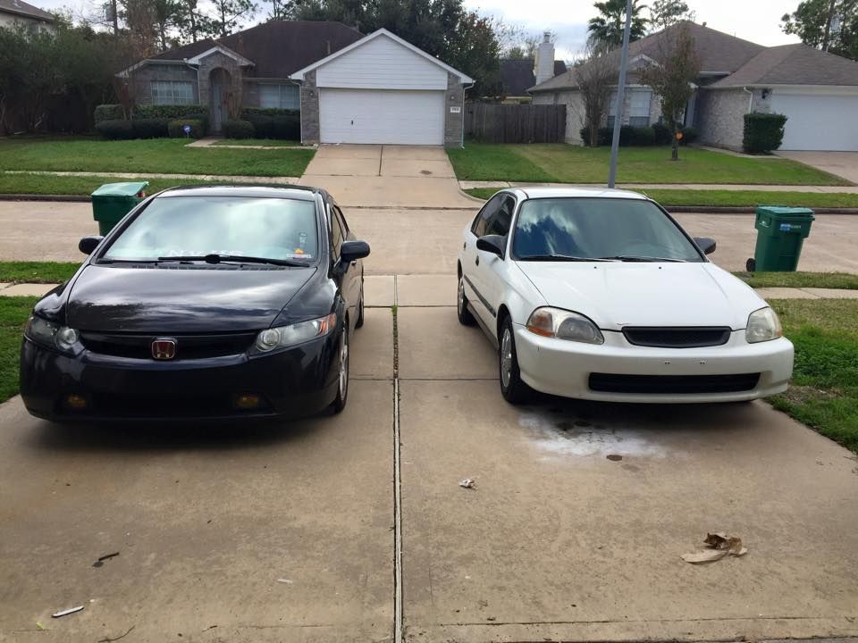

So let me start by saying I have only owned SOHC Hondas. Going on my 4th so far, but strangely first D series. Anyway! It's a 97 civic sedan DX with the y7. It's going to be my DD so I wont be doing anything crazy like engine swaps or even boosting it. The one thing I am going to do is swap the y7 head to a y8 so I can have vtec again. I've already starting finding all the parts I believe I need: y8 wiring harness, y8 head, y8 head studs, y8 IM and throttle body, y8 M/T p2p ecu. Plus the knock sensor. So other than the head swap, lip kit, rims and lowering springs I'm leaving it alone. Here is my ej6 parked next to my fa1 with my wife's cd5 in the garage. If you have any suggestions or tips for making my little ej a more comfortable DD I am all ears! Thanks in advance everyone!
