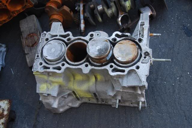

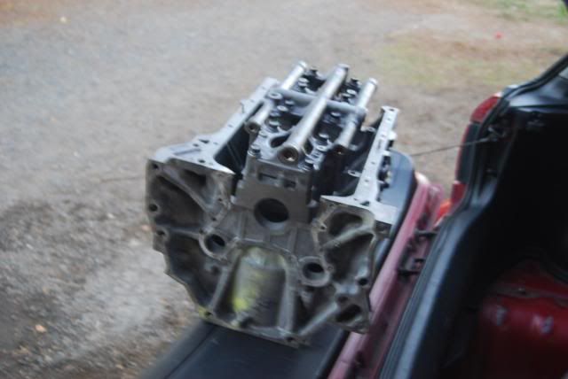

as some know i came across this block for free and well.. ima build it and swap it into the hatch.... so please peoples bare with me im not made of $$:( but hopefully if all goes well my goal is around Jan. so lets start with some pics!!
it was just laying there.... so sad..
Now i took a straight edge and the most i found was 0.005 in a spot. so i dont think im going to deck it.. but idk.

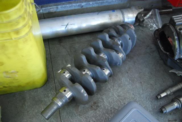

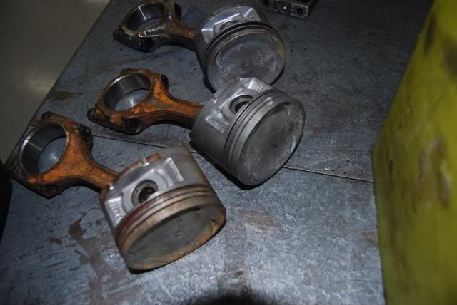

outa the parts was and with a hone i cleaned off some surface rust and got some readings (not accurate because of the rust) witch came out BEAUTIFUL and so on to the crank..... (will post a pic later) BUT IT'S PERFECT!! brand new!! all piston rod journals where the same readings! 1.8895 the main (will post exact measurements tomarrow) where only 0.0001 off. so i think its good.:bigok:

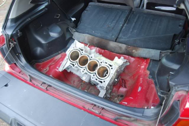

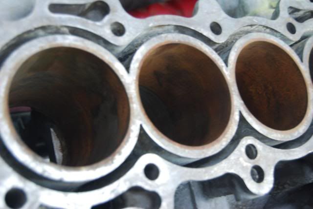

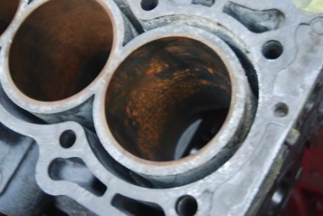

as you can see the iron sleeves are rusted... not bad though! took it to a machine shop and they said we can machine hone it and it will clean it right off!!! SWEET:bigok: so he quoted me 120 for that... that's happening on mond.
and now for a lil sad time...

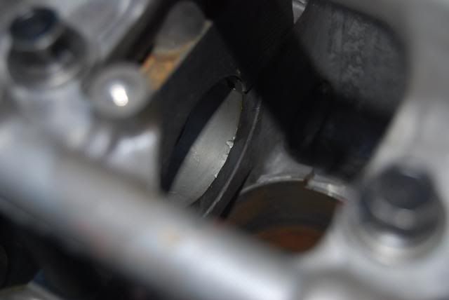

i seen it at first and started thinking dam... ima need him to bore this out... but when i was there he said to just take some fine sand paper and smooth it out.. it doesnt protrude out that much. but enough to fuc* some shit up it i dont do anything about it. so :bigok: im happy! gettin some $$ sunday so will be buying rings, bearing, etc. later but leme know what you guys think!

God damn thats one ugly block. I would like to see it turn out though.
Fuck trying to get that shit clean with sand paper, run a flex hone through it.

oh ugly is being nice.. allready ran a flex hone through it im just going to take it to the machine shop and have them machine hone it.. as for the balance shaft elimenator.... idk.. what's the gian/disadvantage with them? i know its only like 120 but really what's the gain in it?

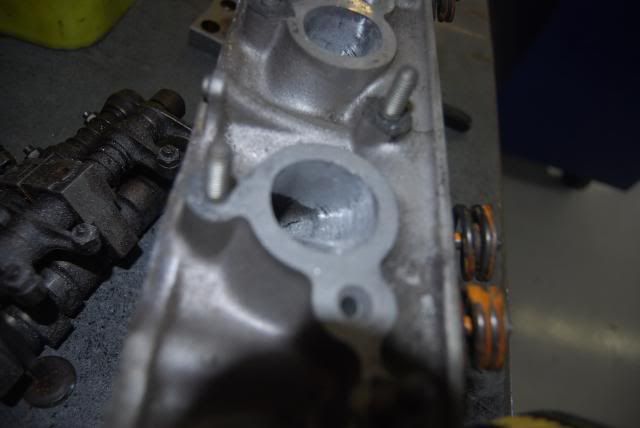

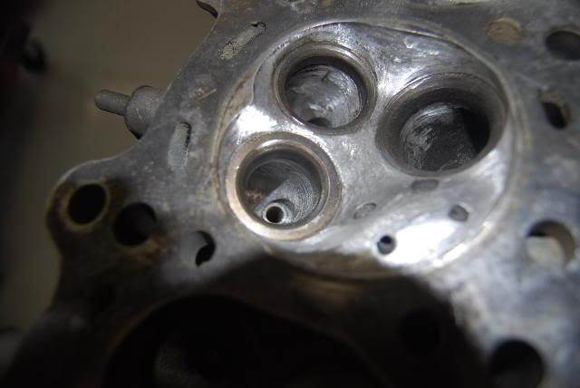

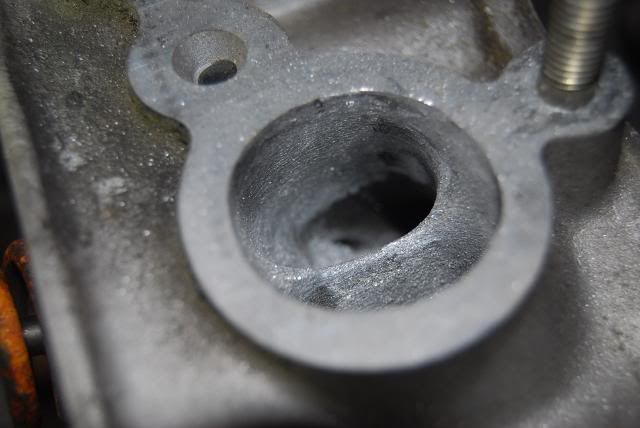

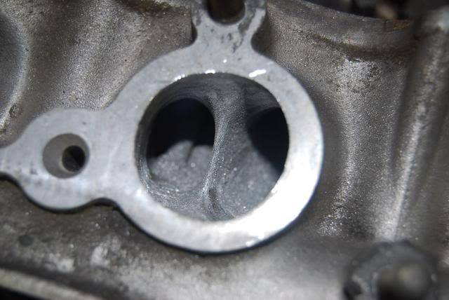

im waiting on a pic of the head that is being given to me... Dnt think it's a a6... but the other head was trash... so idk one thing is for sure.. the old head is going to be my PnP tester! haha so any input on porting it? and is it a good thing to match the heads with the gasket on the IM? any input would be greatly appreciated.

the 90-93 accord head is all the same, minus the cam and IM. pretty sure i already told you that. anywho... balance shaft eliminator kit, asap. its one of the best mods your going to do. gives you a solid 10 psi of oil pressure and the flow with it. the rear balancer gear will be gone, so less hassle putting the engine in the car also.

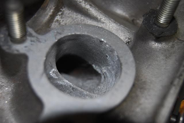

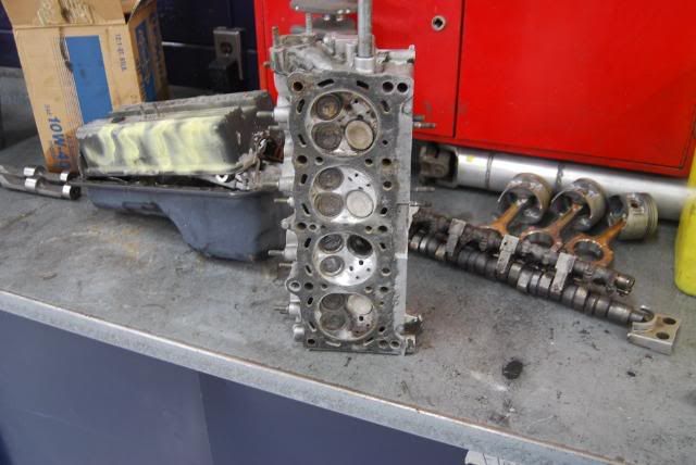

the head i have is missing 2 springs/retainers/clips, etc. and 1 valve. but the head itself has a lot of carbon buildup... so what i wanted to do was practice PnP on that head so when i get mine i kinda allready have a feel for it. Pm will be sent on that list.

im soo stupid:uh:
here's that pic of what i was talking about.. (ima tard i know)
14,661 Posts
that should be fine as long as the face of the bearing receiver is smooth. best to place a bearing shell up against it to see if the back half of the shell is going to get a bunch of oil on it or not.

11,892 Posts

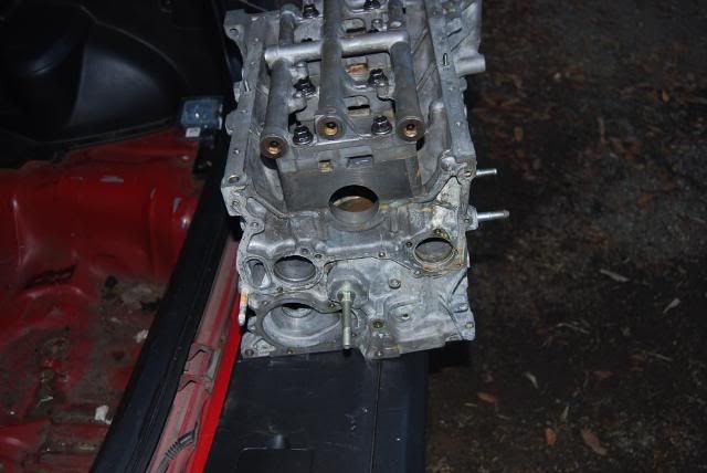

I may be late and missing some of the story but what is up with that spray paint on the block? All CFC cars in the jy here have that color spray paint on them. I know it's illegal but is that a block out of CFC car?
