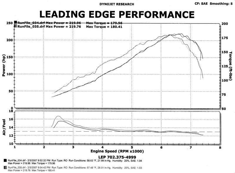

You guys are funny! Anyways I didn't hit 300hp. Only made 220hp with 180tq.
I fuk up forgot to upgrade my wastegate spring , left it at home. Able to push 15psi on a 5lbs spring. (maxed out).Vtec kicks in at 4000rpm full boost at 5000 rpms. My tuner told me there's still room for 75hp safely.That would put me at 295hp.We'll mybe next time!!! I'll post a vid and the dyno graph later tonight..
A single cam with VTEC at 4k? Your tuner doesn't know what hes doing. And yes he's wrong about another 75hp.

x2 i call :bull: on your tuner...
so on a t3/t4 57 trim which you said you had in anothe thread you only got 220 whp at 15 psi? or did you change you setup?
220 at 15psi sounds more liek numbers from a 14b than a t3/t4, lol
yeah seriously. On my t3/t04e 54 trim, im planning on making 270-280whp @ 15 psi................

If thats true that is pretty weak....

The only thing I had changed on my setup was engage vtec.:confused:
at 15 psi with that turbo you should be making alot more whp... people with similiar turbos are pushing 300 ish whp at minimum at 15 psi.....
whats your complete setup?
Here's the dyno graph.....
