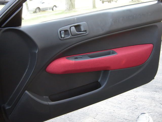

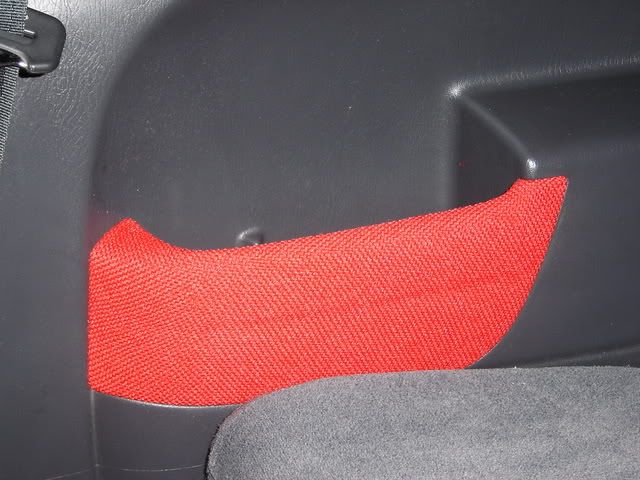

WOW !!! that looks as great as my RED tweed arm rests ...i did them the same way about 3 years ago, But i was to lazy to do a write up

thanks i was going to do the hole red thing armrest , carpet ... but went with black instead new black carpet coming this week:TU:
UPDATE since i did this i change them ones again... for the last time .
