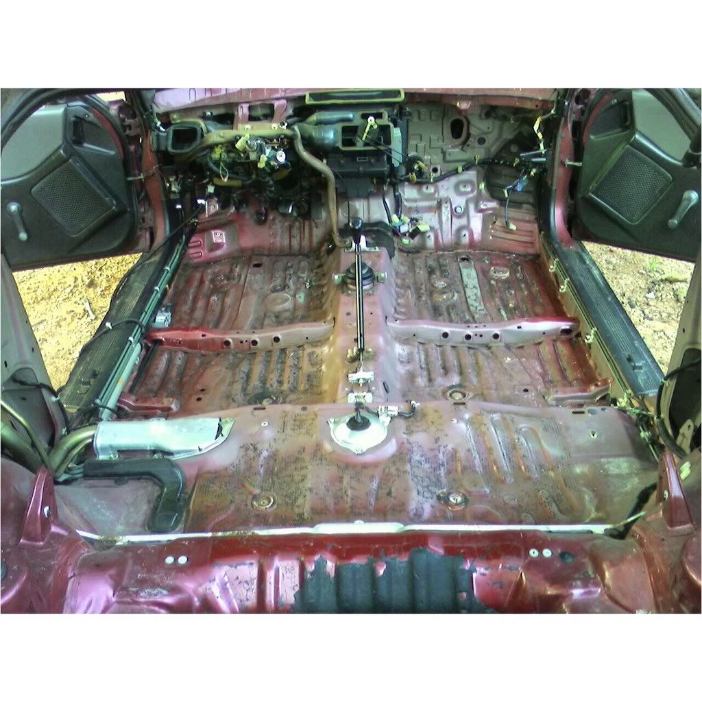

Empty rear of car.. the darker sections in the trunk and under seats that looks like a hard tar is the sound deadening material.
-After removal take your dry ice and spead it out over a section of sound deadening materail, do not do to much of the area at a time and try to cover as much of the materail as you can. YOU WANT THIS STUFF TO GET COLD!

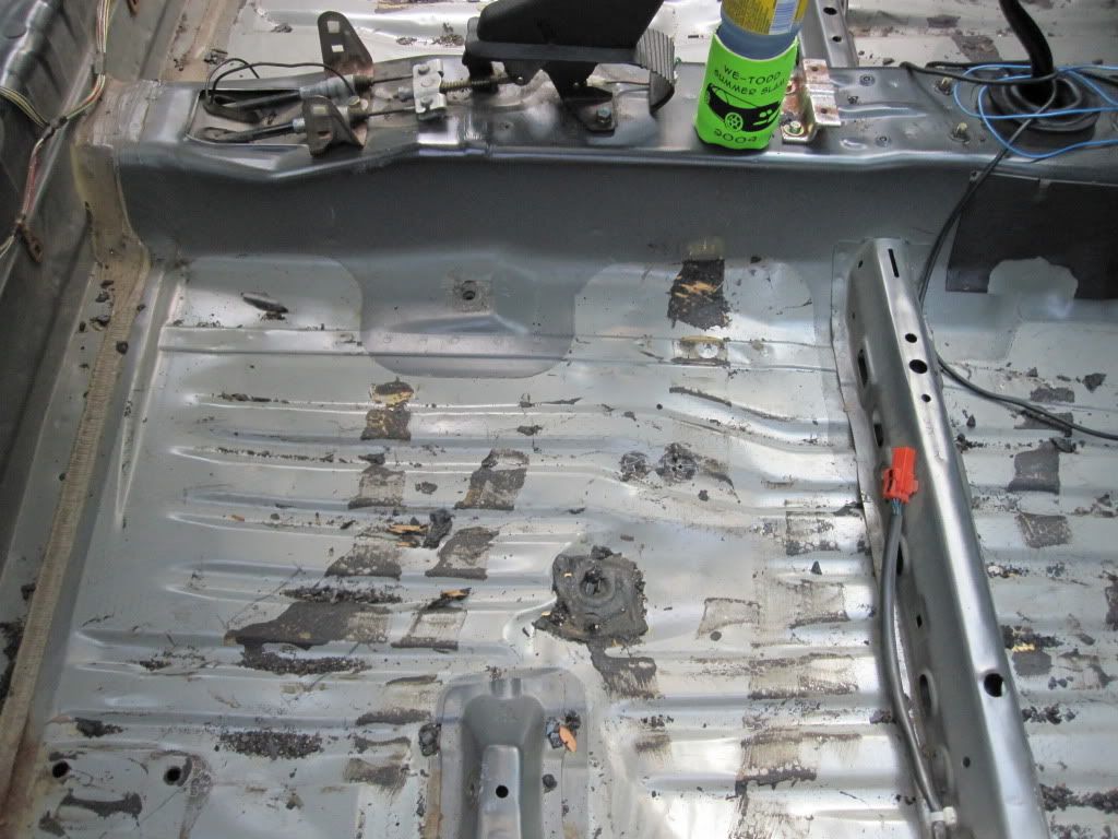

pic. of ice in action-- you may need smaller chunks for helping to freeze the curved setions-- you can see the I's I am talking about that are stamped into the material.

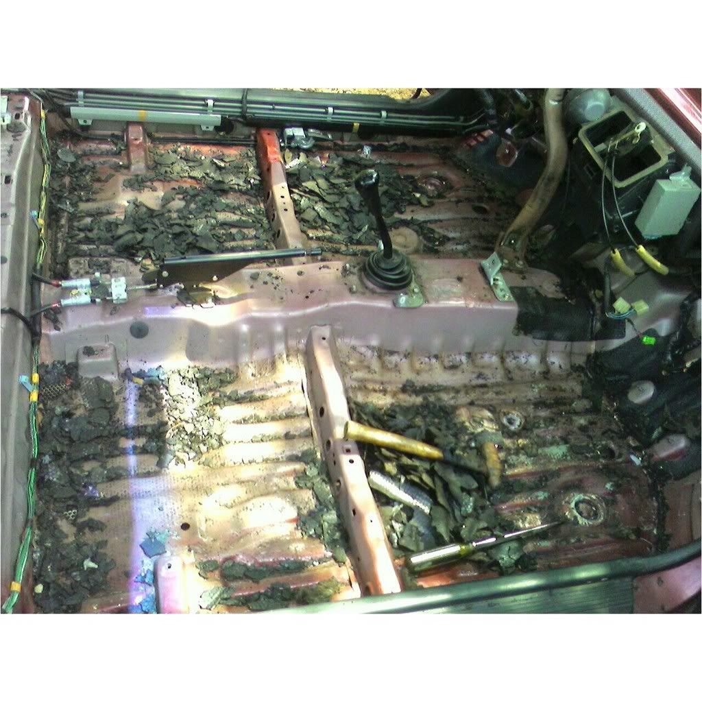

-Once a section is good and frozen use your hands first to try and peel/lift the large easy sections up. Then if you must resort to a metal paint scraper and plastic mallet, a small flat head may help in some situations. Collect all pieces and put them in a plastic trashbag, this will cut down on flying shrapnel and clean up will be easier.

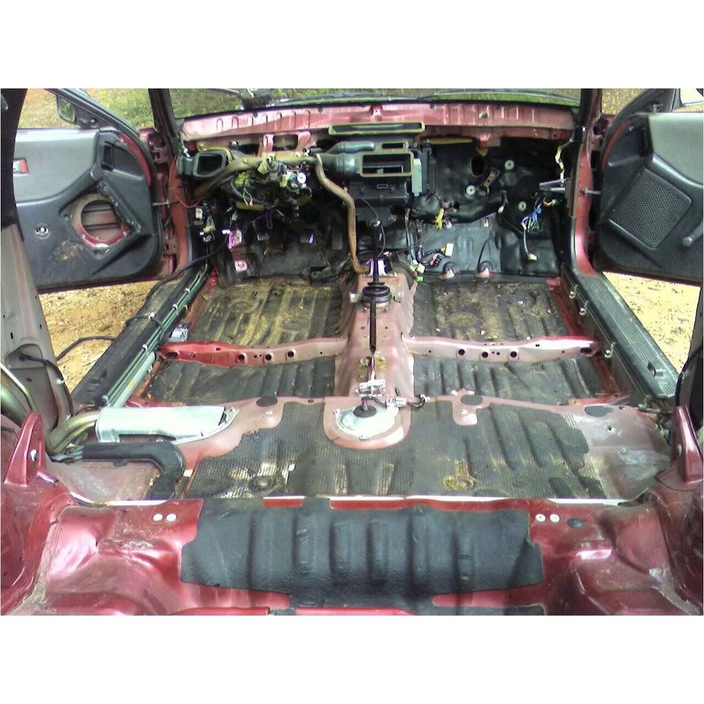

-I worked my way from back to front. There is a "rubber mat" type under the dash that cuts engine noise and that was quite heavy aswell, but most of it can be removed with careful cutting and tugging

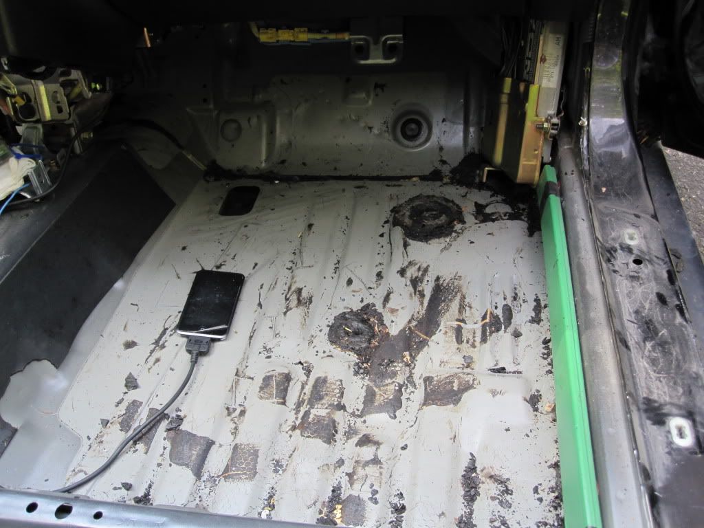

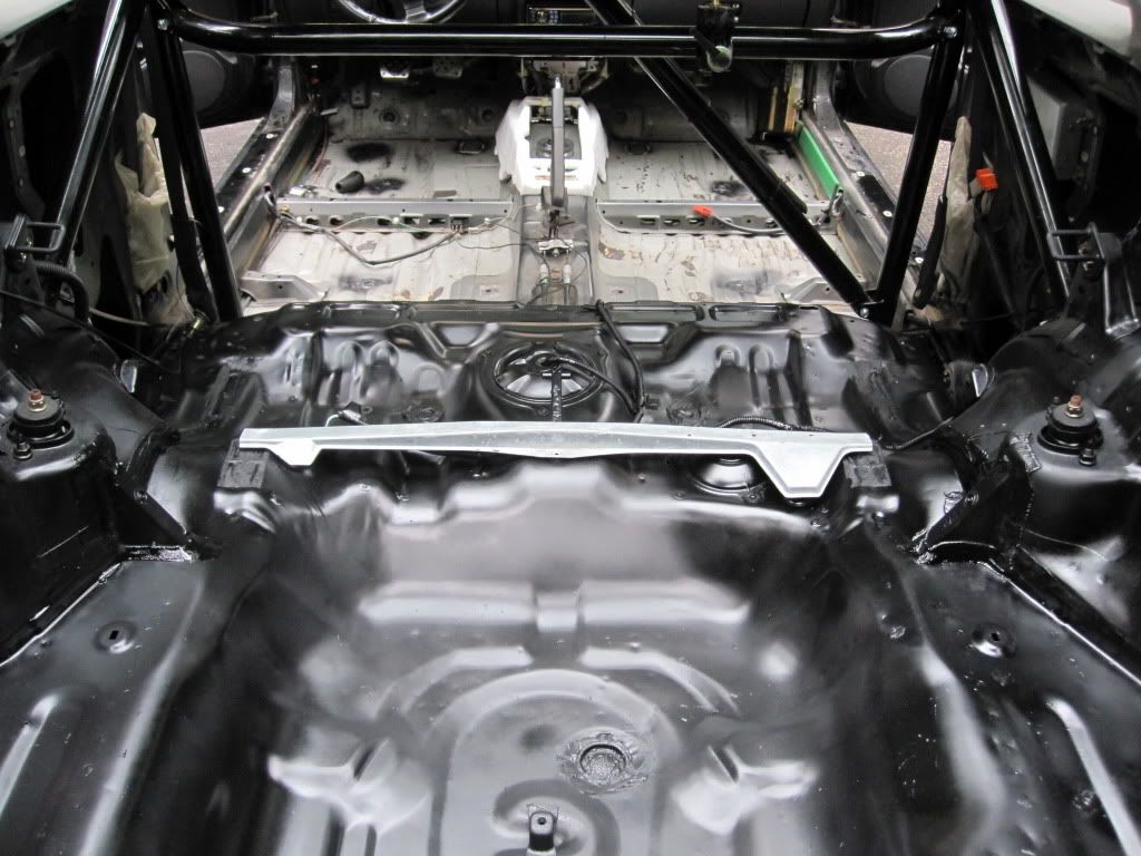

here is some pics taken later that day, including post roll bar install and painting of trunk area.
-I put all of the sound deadening material I removed in one single contractor trash bag, and I would guess it was about 27lbs give or take a few.
