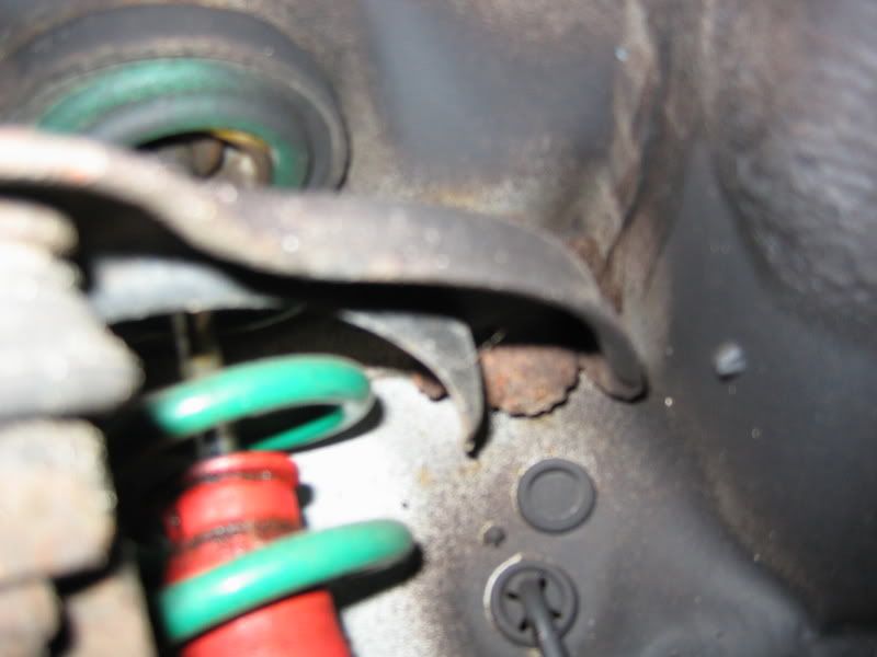

I have a 94 DX hatch the front wheel like to rub on this area wher the inner fender meet the frame

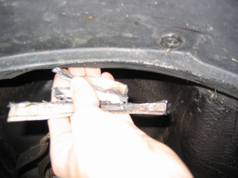

4.cut a portion of where the trim was spot welded together where your upper control arms ball joints at, about 3inches long
-I hear when you buy a camber kit like the skunk 2 this is a problem, the outer point of the Control arm wants to hit this area, if i bent it over right there it would be worse, so i cut only where the control arm travel up into my upper shock tower
Behind this plastic piece is metal like this...
(i only cut this much metal on both wheel wells, the long piece is how much i cut total) (the two small pieces are from the passenger side wheel well)
-*Cutting too much could be harmful, but this is not a structural point on the car*

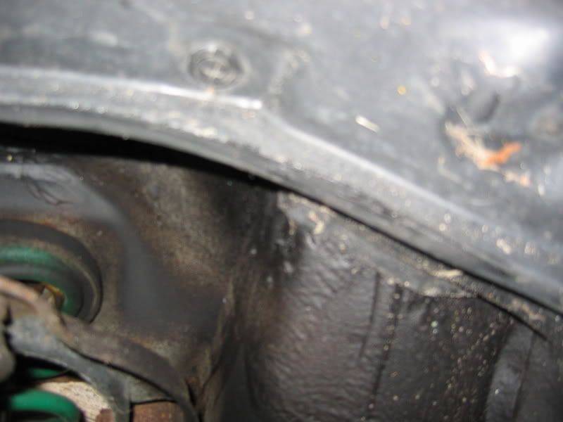

5.Bend the rest of the metal you didn't cut over with a hammer, be careful not to hit your fender
As you can see i was rubbing this trim
-I'm leaving the plastic on there with the stuff behind it cut and bent over to see how much my tires really rub
6.I then bought a can of Dupont Rubberized undercoat spray, and sprayed where i cut and bent the metal so it would not rust
