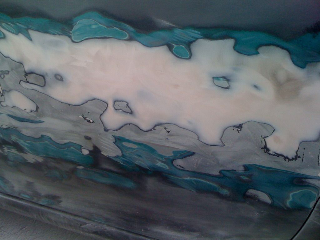

I applied the first coat and hit it with the sander to smooth it out before I went for a second coat ( Note** make sure you wipe down the surface very well before to attempt to add another coat , this stuff does not stick at all to the dust) heres a picture after a coat or 2 (cant remember how many at this point) and some minor sanding. ( I used 80-100 grit to knock down the heavy parts and 120-140 grit to make a smooth finish)
After a few coats and sanding's, I grabbed some regular bondo filler and put it on over top of the fiberglass see picture
I sanded it down to get a nice smooth finish , you can normally feel when it needs sanding , I also used sand able primer and sprayed it over , it helps to show all the minor imperfections and helps fill the small holes , did a final coat and sanding

Bondo should never be that thick, it's not going to last long. I'm not even a 'bodywork guy' but I can tell that the door isn't smooth just by the pattern of the bondo after sanding.
Body filler should only be used in super thin coats to fix small imperfections, there are other filler types available for thicker applications but welding in filler plates would almost always be a better solution than just a heavy coat of filler.

not trying to put you down or anything just maybe help someone who looks and wants to try it. you really should have welded the holes up (even better weld metal just inside where the moldings went so the filler isnt really think) dynaglass like you did then bondo then some form of glazeing puddy to finish and fill pinholes. and if i can make a suggestion use onmi base its a cheap good base coat.

O one more thing I forgot to add be careful driving with just primer over the body work it doesn't hold water out and bonding is make from the same thing as baby powerso it will hold the water in then pop out. Just try to make it where you don't have to do it again
