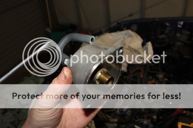

You want to remove the 2 lids that are right behind the carby:
They are held on by 2 phillips head screws.
After doing that you will see a little black stopper (little plastic) in the middle of where the spring sits inside, just remove that.
