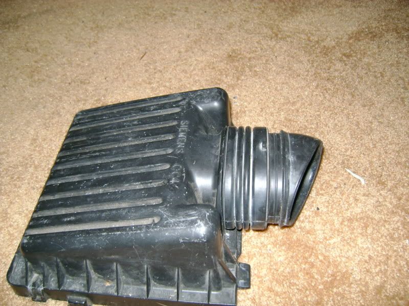

ok so here we start with our stock intake box

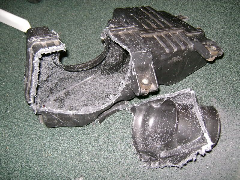

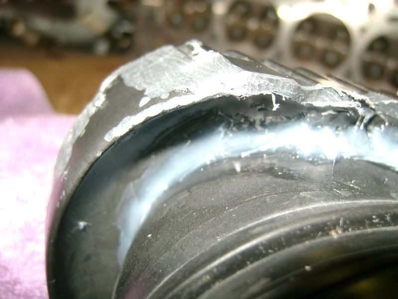

now comes the cutting. THIS IS VERY MESSY!! it makes a lot of dust, so be warned

ok now its all cut out
now i cleaned up the piece and this is all you need now

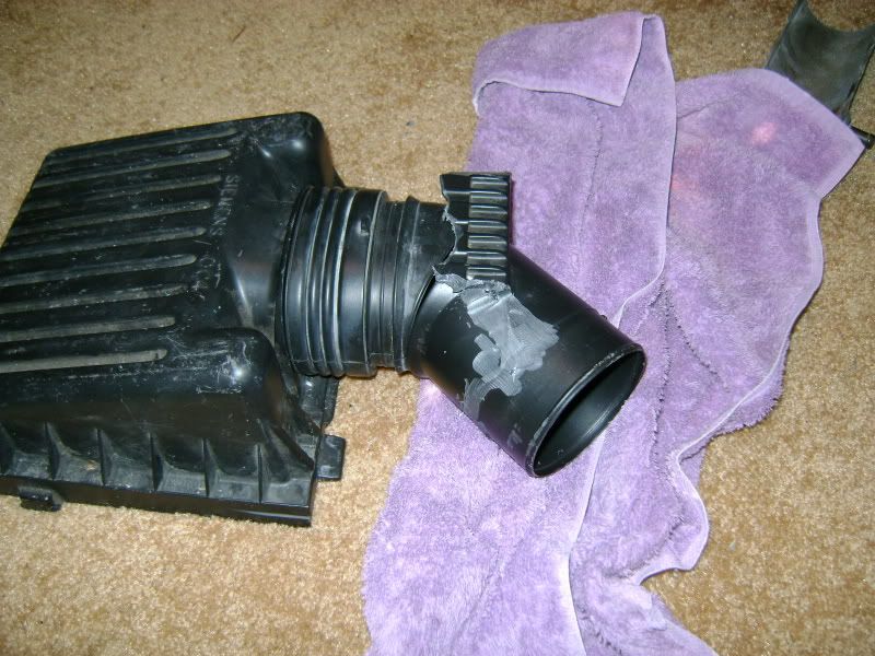

this piece goes on like so
ok this is what it looks like all together

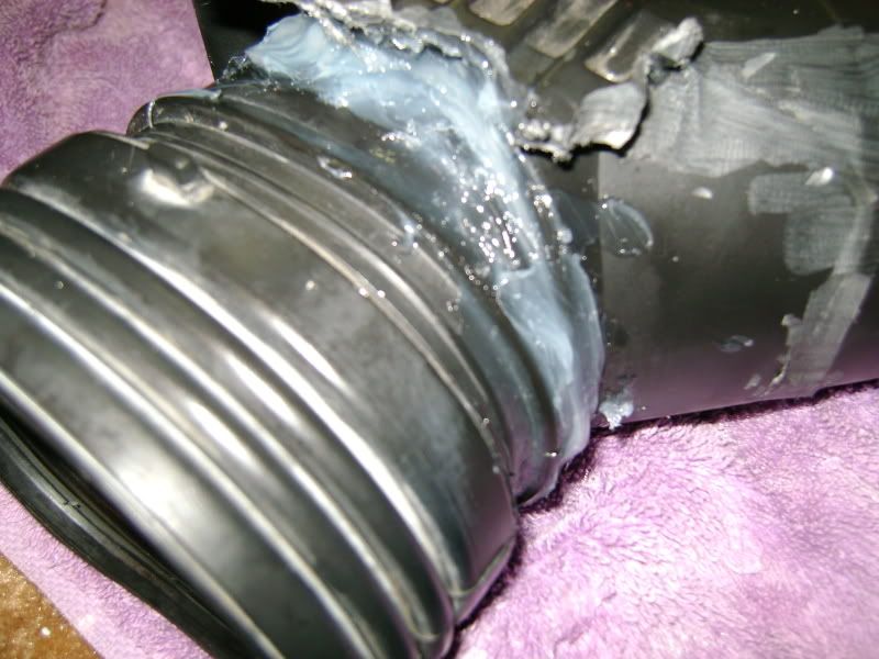

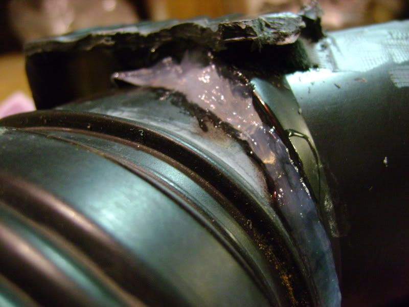

now your gonna notice gaps when you put it together and this is where this comes in
your gonna start sealing around it

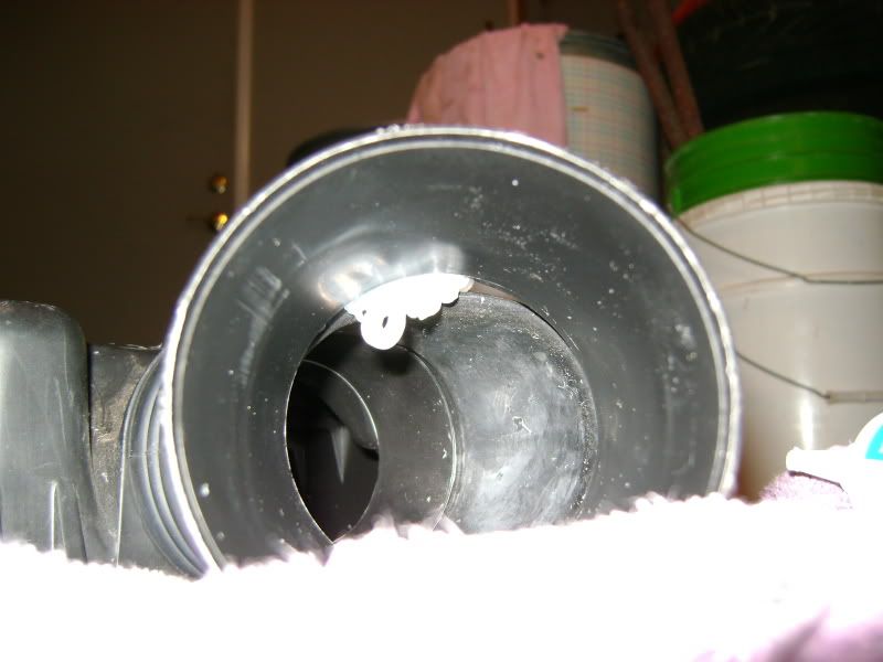

ok inside it looks like this
now you need to reach on inside carefully kinda like your reachin for a girls g-spot and wipe this away
the only light you should really see is top and bottom like this
and your gonna need a rag. Its gonna look like a 16 year olds jizz rag when its done

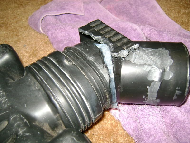

now take your finger and smear it around, but be careful not to split the seam
now let this set for 12-24 hours
than comeback the next day and you have this

now seal this up as well
when you look through the other way it should look something like this
now let this set also to dry. Moving on....

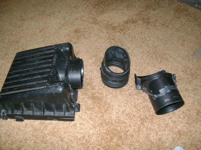

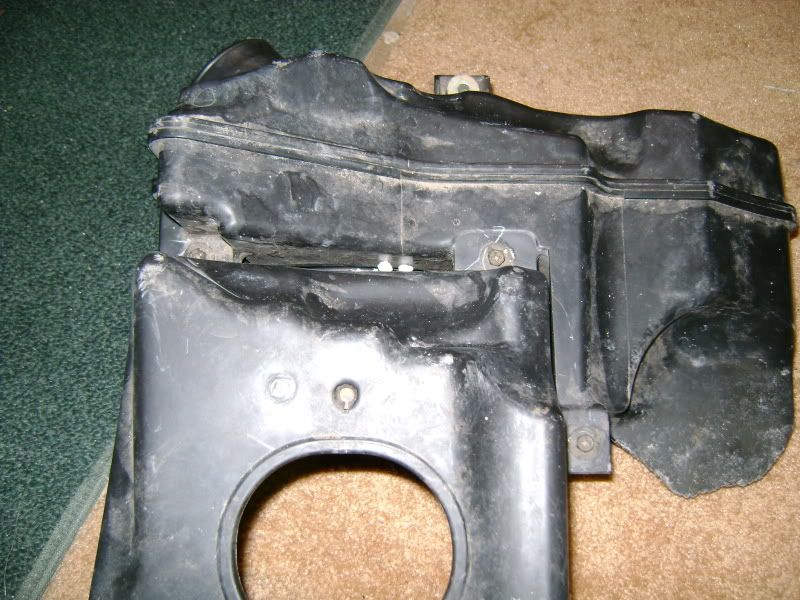

Now we take our air filter box and modify it like so
Stock
Modded
Side by Side
With filter in
Flip side
And here it is all together

Now let that dry and go work on your intake arm
Now, what i did was tae a large cork and shove it in this hole and just seal it over with black RTV

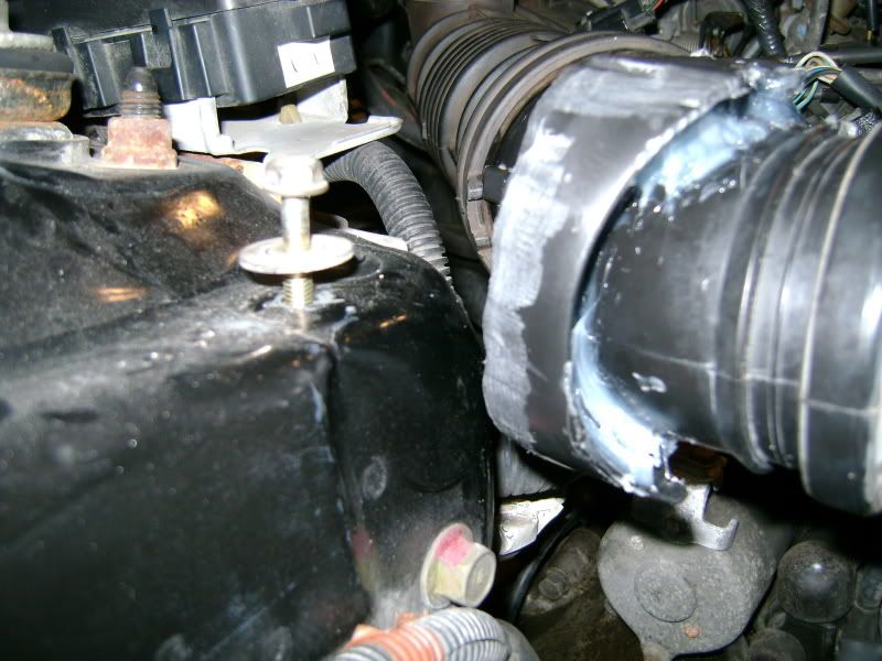

ok i also noticed a little clearance issue here
so i figured it was time for a little Nate engineering and i felt like pissin the neighbors off at 11:45 at night so i took the dremel outside(the rents were asleep) and fixed it.
and....

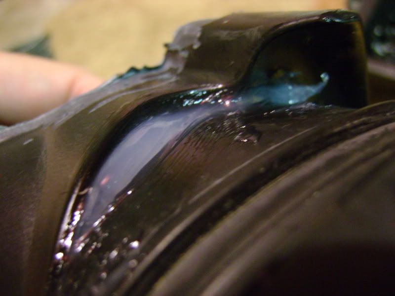

i also didnt like the way the silicone was sealing and flexing so i added a layer of RTV on top of that to help color match better and to help flexing issues
and here it is all done
