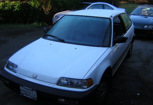

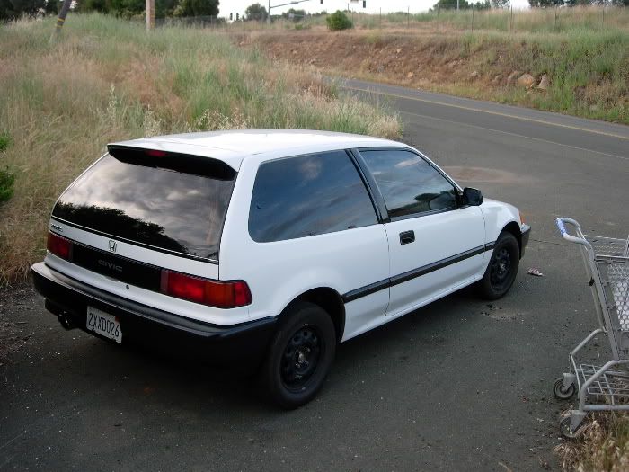

Nor Cal D-series rider
1991 Honda Civic STD
810 Posts

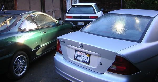

A 7th gen that is fast without a K-swap is a pretty big accomplishment. :TU:
I had an '01 silver EM2 coupe for almost a year but traded it in for an EF..I wish I could have afforded both.
7th gens are the least bouncy, quietest & comfiest of Civic's I've been in besides the 2006+ models. Their interiors are awesome.
The day me & my bro picked her up, Fall 2000. Sold spring '03
What my brother & I shared 'till I rolled it..:neutral:
R.I.P. DC4. Jan. 2006
Import Al's driveway, March '03.
The sole survivor, 1991 Civic STD, June '06.
Sorry, I still think about them.
