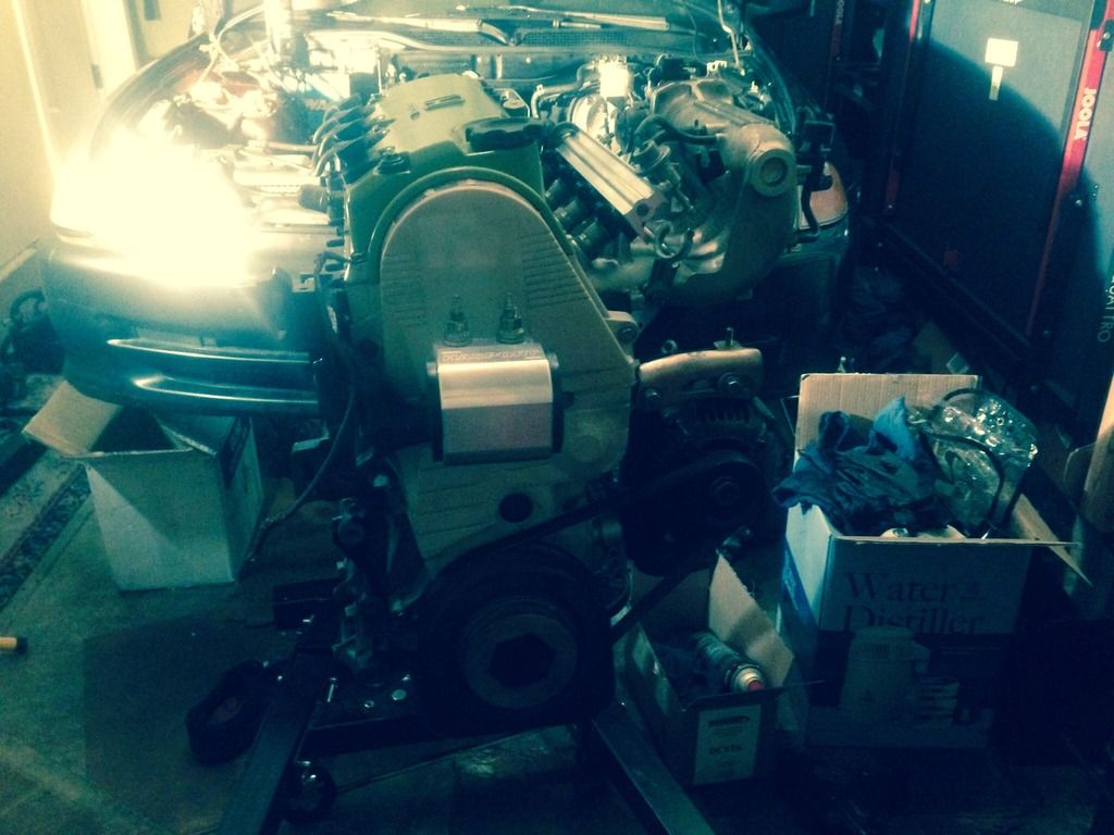

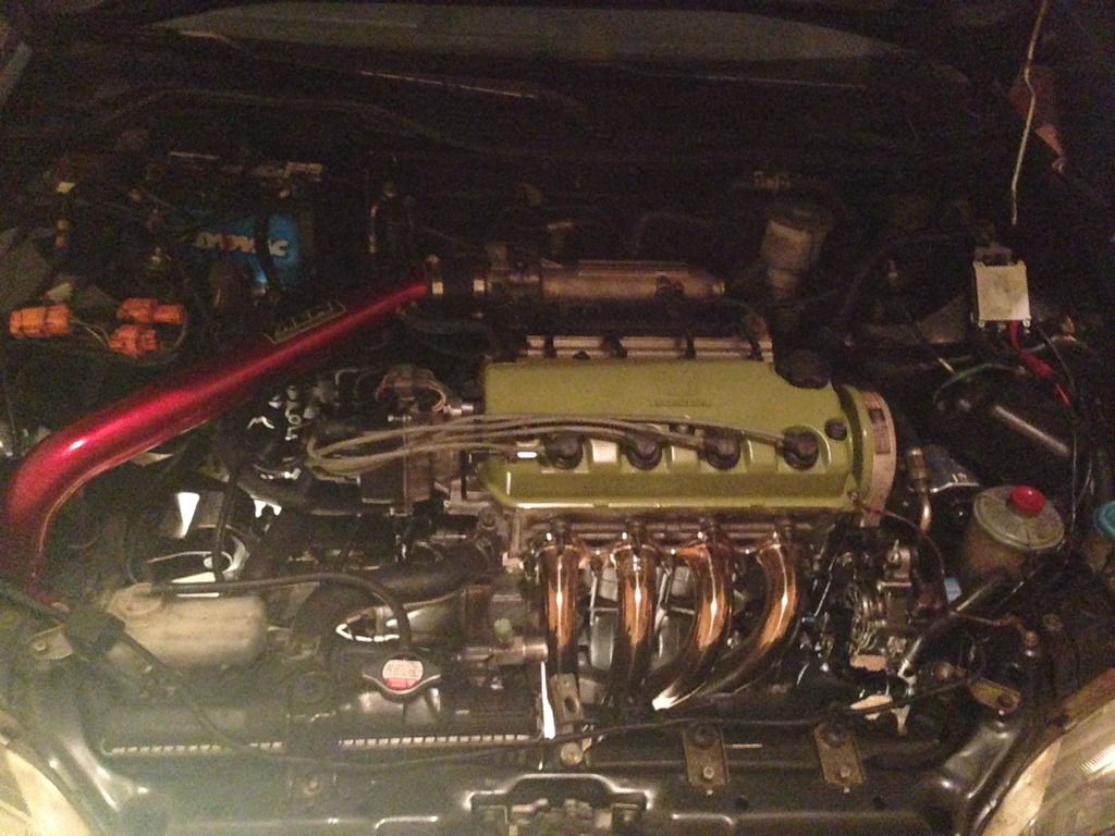

So, long story short, the first rebuild of my life did not turn out ideally. I have had numerous problems with the engine due to mostly inexperience I figure. I forgot to set my ignition timing. I blew a head gasket. Heavy oil leak. Knocking/clunking noise in engine bay.

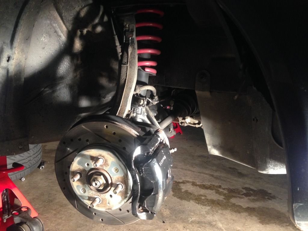

Not engine related: I have a very worn lower control arm bushing clunking around. I have a power steering leak. My exhaust is old, loud and not looking too good
My plans are to rebuild my spare D16Z6 with the bit of experience I have gained. And address the other problems as well.

Doing control arm bushings now.

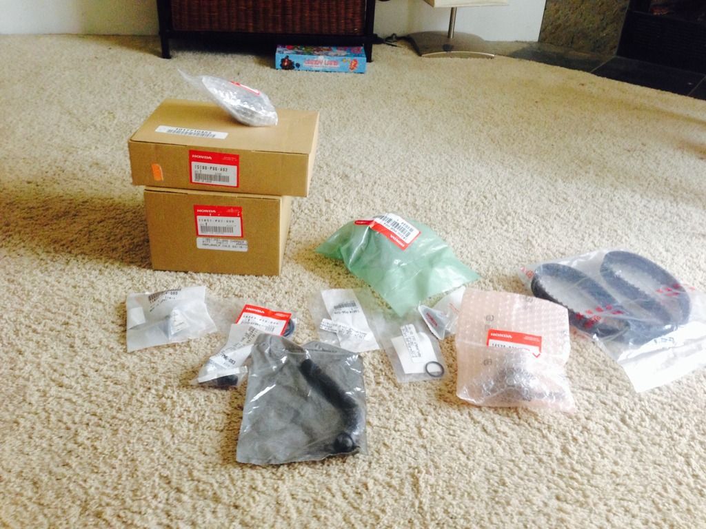

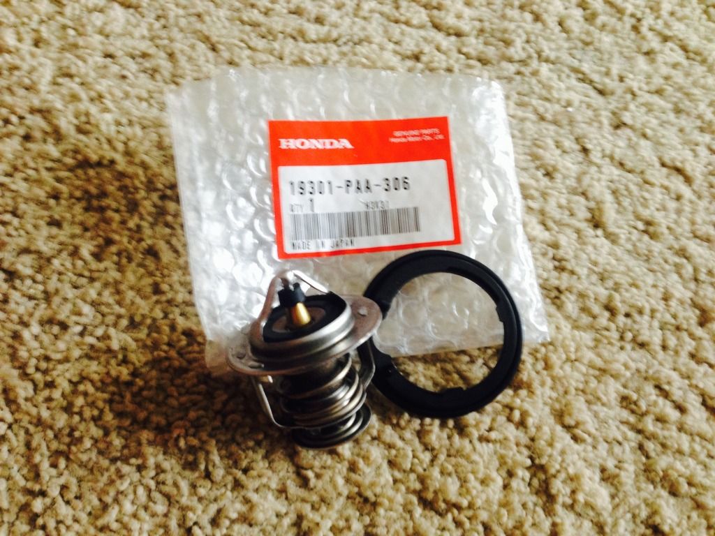

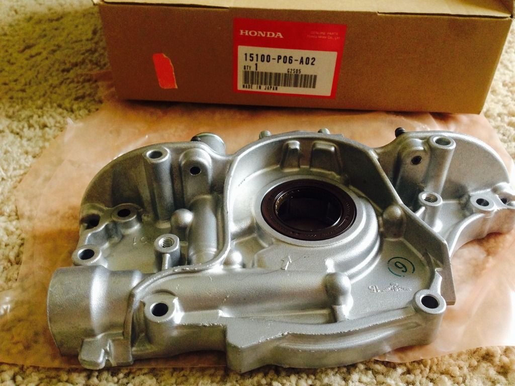

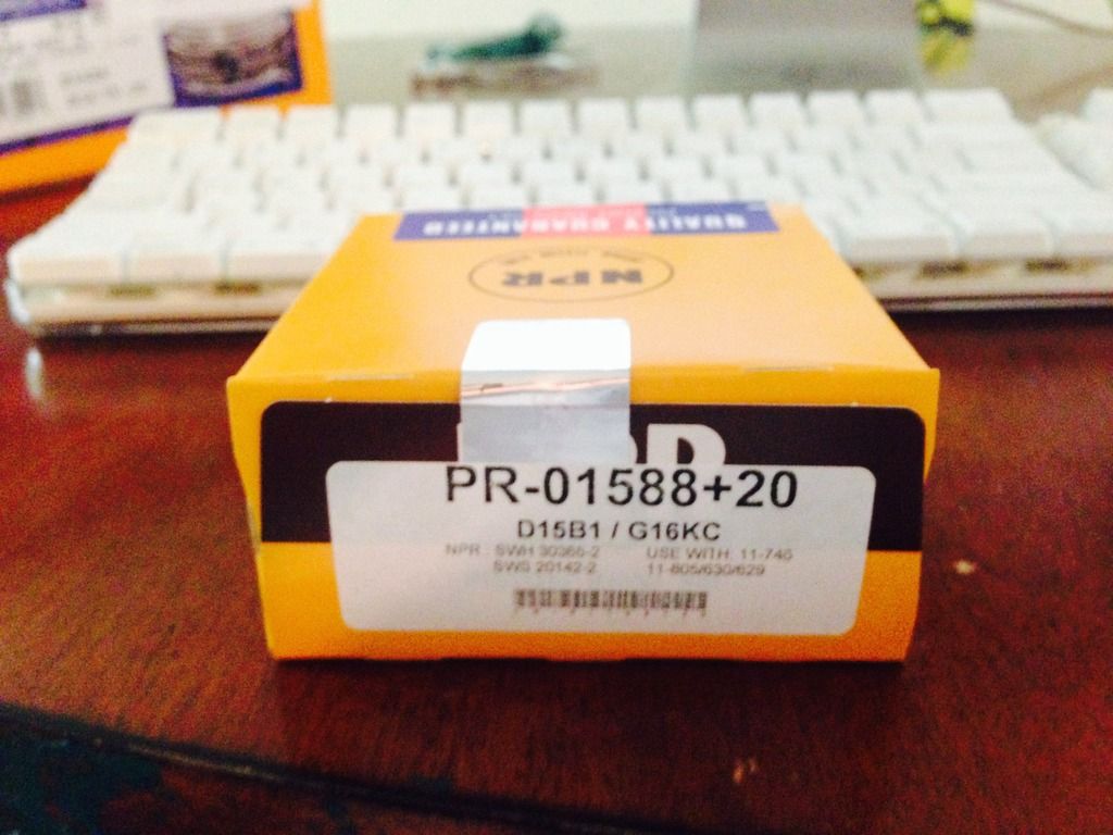

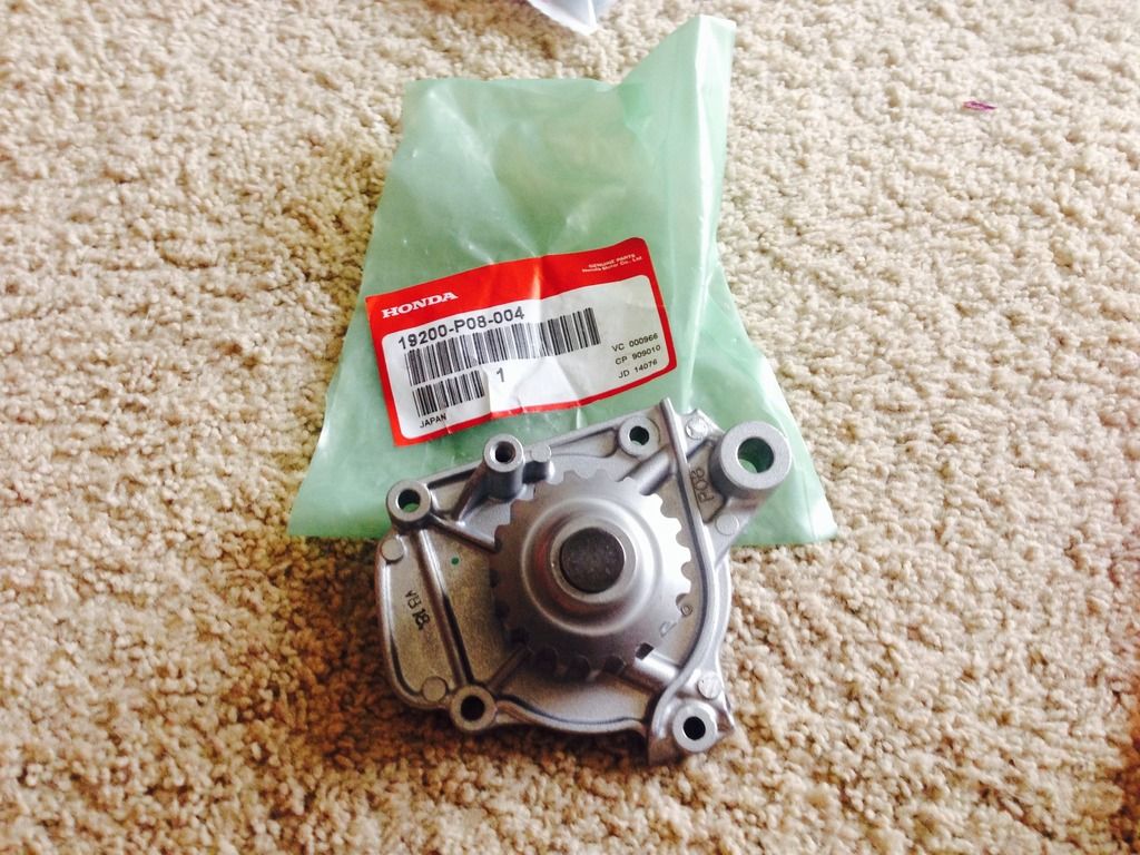

Got some OEM supplies. I want to do this rebuild as close to perfect as I can. I also got a magnetic drain plug :)
Got some tools to get the jobs done easier. Pretty stoked to use the valve adjuster tool. And, this time I will not have to use my fingers to put on my rings. I have to fix my harness a bit, hence the wire strippers.
Next step: Get stuff hot-tanked.
