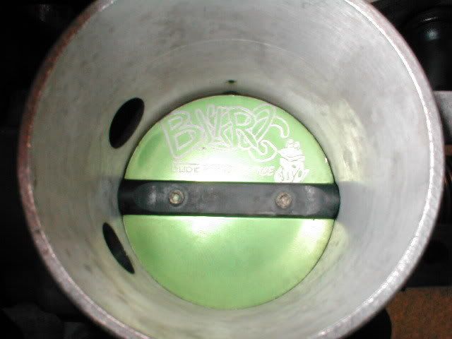

easy fix, if nothing is bad.
pop out the idle set screw. if you pretend you are the intake tube, it is upper left of the throttle opening generally.
clean the screw. check that the o-ring is clean and free of damage. carefully popit off with a eyecare screwdriver or similar, or a pick.
a drop of fresh motor oil would not hurt to lube it up to reinstall the oring and the idle screw.
before re-install though, spray some brake cleaner or carb cleaner into that small hole on the throttle to clean the passage.
reinstall screw, bottom it out (no hulk tightening!). back it out 2 full turns.
fire up the car. let it completely warm up. that is, until the fans kick on in a REGULAR interval. this generally will take the fans kicking on 4-5 times before stuff levels off.
Once that is done, shut car off. pop the backup or ecu fuse out, it is a 7.5 amp or a 10amp generally. confirm it is the proper one by turning ignition on, and seeing if CEL appears. if it appears, you dont have power cut from ecu.
let fuse sit outside for 5-10 minutes, then pop back in, fire up engine, let it idle.
Let the fans get back to a regular interval, should only take a minute or two if its warm already.
either use a timing gun or a scanner (96+ chassis), watch rpms. use idle set screw to adjust to 700-800. I prefer 800 as its smoother for me, and since I have a stereo, this gets me a little more juice from alternator
