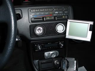

Also do they make a custome one to put them where the radio goes? I have heard that the japanease version came with the radio location down to where the cup holders are, if this is true then I can put the guages where the radio goes and my radio where the cup holder is.
exactly how I have mine. First you will need the "audio console", they are about $80. Then you will have an empty space where the radio used to be. I just took some plastic (about 1/8 thick) and a hole saw. I ran the hole saw in reverse, cut out 3 holes, and put my gauges in, viola! Ill send you a pic tonight.

i actually moved my stereo down where the cup holders were and i'm going to make a custom mount for the stock radio position for 2-3 gauges...

Here is mine in my optional audio console. I havent had time to clean up the metal trim piece.
I will cut it out a little bit better and also I will try to painted black so that it can cover and match better but i get the idea. But I will rather have my radio there and have my guages up where I can see them. Im my opinion once you turn on the radio you don't look at it that much, but the guages while tunning, racing or driving you will have at least one eye on them.
