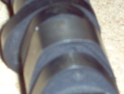

heres a pic of the cam.... low cam and high cam only

Hmm, interesting. Nice it performs good, what valvesprings/retainers you have? That ramp profile looks pretty damn steep, like it would just pop the valves open, keep them open and suddenly slam them shut.. Works good for a while, but is extremely hard for valvetrain.

What is the Gude part number for that particular cam? It's supposed to be like HCCS?? with two numbers.
Any idea about duration/lift figures?

stock springs and stock retainers... just like my last setup with his 10 second cam.. no problems at 9000 rpm's on stock springs... there is no part number.. its a custom cam made for me....
but one thing.. i had to take it out.. its too big if a cam for my low compression motor, hes making me a new one in a couple of days soo ill see how that goes..it would take off in vtec... but sometimes it would studder and pop right before vtec crossover and i didnt like that...soo new cam in a few days
