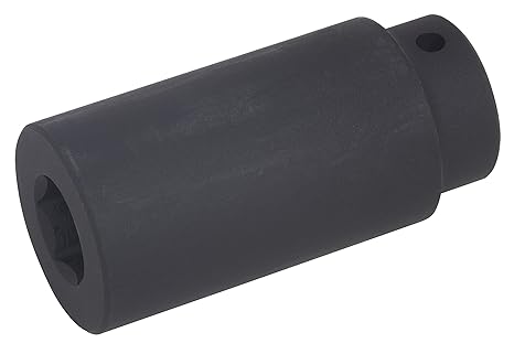

If you have airtools, this is what practically everyone used back when I was a tech at a Honda dealership.
I just googled an image, since mine is at work in my toolbox. Snap-On makes one I believe. So does Matco, Ingersol Rand, and some other companies as well. It truly does work. Hell, you can even make one by just welding some thick piping to the outside of a cheap socket you don't care about. That's what I did before these were actually produced by anyone.
Basic concept is the extra mass that's further away from the center of rotation gives the impact gun more "leverage" and thus more twisting force. That's my 2 cents on the subject.
