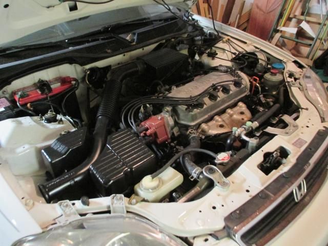

1997 Honda Civic Sedan
D16Y7 - 176,xxx miles at the time of purchase.
All Original , EVERYTHING
