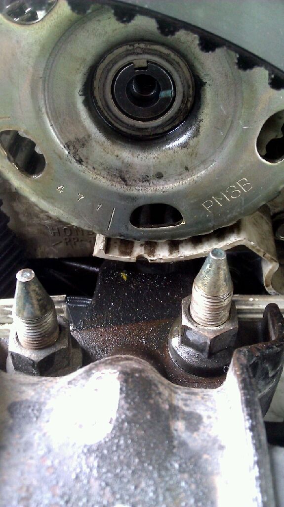

I stole this photo cuz I didn't take a pic of my stock gear on the cam -
After you've verified that the gear is at TDC, mark the top tooth of the
timing belt with a grease pen or goats blood. Your choice. Then remove
cam gear bolt and slide the cam gear off with the belt on it.

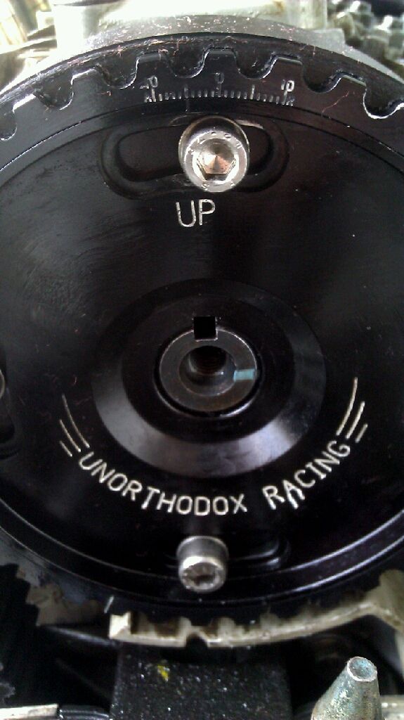

This is my cam installed with the timing set at "stock" or "zero". It is
visibly off time.
Here's where the WD40 comes into play. It should help the center of the
cam gear spin with a little effort without moving the cam. Spin the center
until it lines up with the cam keyway.
Now that my cam keyway is lined up properly with both the gear and the
cam, the cam key should easily and freely slide into the hole. Tighten your
cam bolts and you are truly where your stock gear was. Notice that my
gear is not at "TDC"..it's 2 degrees off. So, 2* retarded is really TDC for
this particular cam gear.
Retard or advance to your liking from there. Set your ignition timing and
rest assured that your cam is really where you want it to be.
