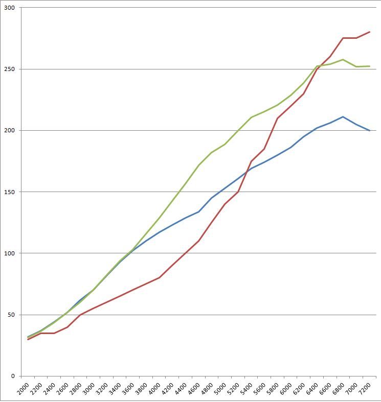

So I posted this in my build thread http://www.d-series.org/forums/showcase/157028-my-d16y8-turbo-build.html but I thought people would want to read it without having to go through my whole thread.
Beating a Dead Horse: The Great Torque vs. Horsepower Debate
So this thread by ddd4114 made me want to calculate the average horsepower that my car makes since average horsepower means more than peak horsepower.
Calculating average horsepower would have been easy if I had the formula for the line on the dyno plot because then I'd just take the integral of that line to find the area under the curve and divide that value by the rpm range (in my case 7200-2000=5200). Except I didn't have the formula for this line and didn't know of any programs that could generate it. Since I was just wanting a rough estimate of the average horsepower I decided to just transcribe the dyno plot onto a sheet of graph paper and enter in the horsepower values into Excel with their respective rpms. I used the trapezoid rule as opposed to the rectangle rule, just so I wouldn't be too far off.
So the trapezoid rule:
∫f(x)dx≈(b-a)*[(f(a)+f(b))/2]
or
(2200-2000)*[(32+37)/2]=6900
I went up by increments of 200 starting at 2000 (where the dyno run started) up to 7200 (where it ended).
Using Excel's handy autosum feature I was able to quickly calculate the sum of all these values: 691600
This obviously isn't my average horsepower lol I needed to divide this number by the rpms, in this case it was 5200
691600/5200=133 average whp from 2000rpm to 7200 rpm
If there's an easier way to do this, cool, but this is how I did it and it makes sense. I think it would be interesting if people would list their average horsepower along with their peak horsepower. In addition, you could find your average horsepower for any rpm range, such as the rpm range that you're in while drag racing e.g. 4800-7200.
Tell me what you guys think, have any of you ever calculated your average horsepower?

start with average torque.
For once I sort of agree.
You'll have a lot more accuracy if you take points on the torque curve. However, you'll need to associate an rpm with each torque point to calculate power afterward.

Dan, I did it your way (and bone's way as well) by starting with torque. I did the same thing, entering all the torque values and rpms going up by 200. I found the average torque to be just over 145 ftlbs. Then for each torque value I calculated the horsepower for their respective rpm. The new horsepower values were very similar to the ones I first used. Average horsepower in this case was 132.455 which is very close to 133!

read dan's thread about torque versus horsepower, average horsepower or average torque (over a given rpm range) is much more important than peak hp or tq.
I could calculate it by using any rpm range, that's in the first post. For drag racing I would use the range from redline down to where gearshifts take me. The reason why I used 2000 rpm was that was where my dyno plot started as well as most plots I have seen. Most tuners I guess can't go WOT from idle on the dyno, that's just a guess.
And dividing your peak horsepower by 2 does not get you average horsepower. You could have two cars with identical peak whp (or torque) but very different averages. For any given rpm range, the car with the higher average (all else equal) will be faster. A car that produces 50 horsepower until 5000 rpm and peaks at 400whp will have a lower average than a car that produces 150whp until 5000 rpm and peaks at 400 whp.
I don't know if you read dan's thread but it's very informative. What I'm trying to say is that peak horsepower/torque doesn't matter as much as averages over whatever rpm range you drive in. For me, I'm not always drag racing so I used the entire dyno plot, 2000 rpm to 7200 rpm. I could calculate my averages for whatever range. When I drag race I may never be below 4800 rpm so I'll use the range 4800-7200.
Again, not flaming or anything, but taking the sum of the starting whp and the ending whp and dividing by 2 does not give you the average.
E.g.
Range: 5000-8000
Car A: 200whp-300whp
Car B: 200whp-300whp
Adding and dividing by 2 gives an average of 250 but this means nothing. Why? Well lets add more rpm points:
Range: 5000-6000-7000-8000
Car A: 200-225-275-300
Car B: 200-250-280-300
Car B would have the higher average horsepower despite having the same beginning and ending horsepowers.

Assuming the power or torque curve is perfectly linear, that is fine. The reality is that they are not as a general rule.
Using a calculus based approach is far more accurate.
Precisely, it would be so much easier if I had some way of generating the equation for any particular lines- maybe Excel can do that? Regardless, the trapezoidal rule will suffice since I have no equation to integrate. And as we see so often, torque and horsepower curves are hardly ever perfectly linear.
4,670 Posts
Trapezoidal rule is perfectly acceptable in this case.
You could always increase your resolution, but then you run the risk of inducing more reading error ASSuming you are reading the values off of a dyno plot print out or some other visual representation.
Data collected directly by the dyno would be better obviously.
We aren't sending man to the moon here, but some amount of accuracy is certainly desired.
Props for actually taking the time to even do such calculations.

exactly, instead of going up by 200 rpm increments I could go up by 50 or 10 assuming I could get precise and accurate readings off of the printed dyno plot. I agree with you 100% I wanted it to be accurate enough while accepting that there will be human error involved.

I think you're overcomplicating the concept a little bit, but it's good to see that you're using it. If you're set on calculating this, I would just take points every 500 or 1000 rpm and average them. Just keep it simple.
As mentioned, different dynos read differently. If you're not paying a lot for tuning, you're probably just using a cheap Dynojet. In that case, the shape of the curves will be relatively consistent, but the magnitude will probably be worth fuck-all. In this case, the value in average horsepower is seen when doing back-to-back part comparisons that dramatically change the shape of the torque curve. In those cases, a part change might give you more peak power but make the car accelerate slower.
I never actually calculate average power. If it's not critical, I just compare the shapes of the torque and power curves and use my best judgement. If it is critical, I'm going to be using simulation software that does everything for me anyway.
