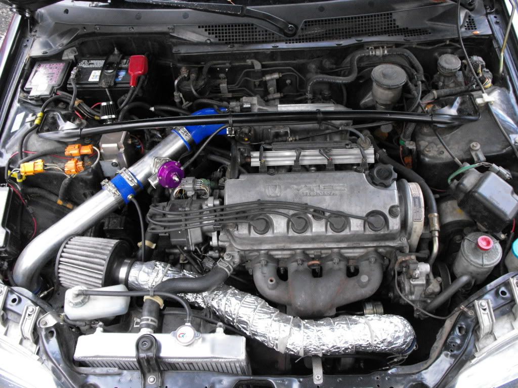

New to the forums, just thought I would see what you guys think of my eg. Had it for about 2 years now. It was completely stock when I got it. Now not so much.
Mods:
t-25 turbo 10.5psi
egay intercooler/piping
crome tuned
dsm injectors
greddy knockoff bov
2.5" exhaust piping
Sleeper
No rice here.
Sorry about the bad engine pic. Took it at night.
Happy with the way my gauge setup turned out.
Best time so far is a 14.8 at 93mph. Keep in mind this is at almost 6000ft above sea level.
Car on the right was a '10 Camaro SS. Almost had him.
Future plans include getting a high flow cat, and getting a less restrictive muffler, and lowering it about 1.5". Currently have the stock cat and a flowmaster 3 chamber. Makes for a really quiet car, but I'm sure I'm losing some power because of it.

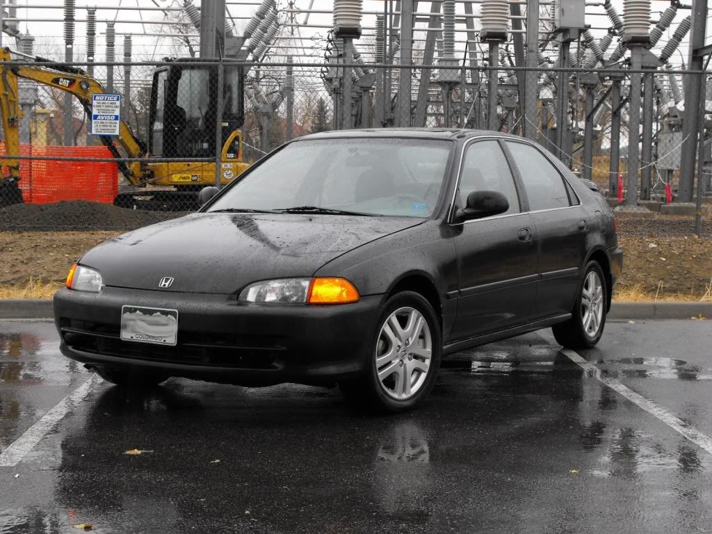

Damn that car is clean, where you live? Im in Greeley
I'm in longmont. The pics hide some of the flaws. Shes got some scars.
super sleeper, im on the fence about the fit wheels
I like it, The wheels match real well
The wheels will probably look better once it's lowered.
Nice! Get some clear pictures of the engine bay yo!
More engine bay pics!!!
New cxracing radiator. Works really well.
Did something different with my intercooler piping routing.
Boost referenced after the intercooler.
Basic catch can setup.

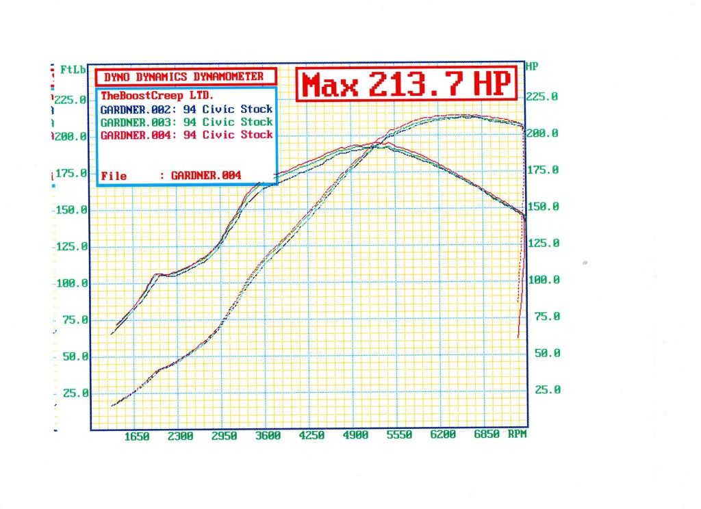

Installed a new vibrant 2.5" high flow cat and 2.5" flat black muffler! They both really changed how the car drives. Boost is available pretty much off idle. Also got the car dyno tested today. Pretty happy with the results.
I bet the car is running much better now.
Thats bad ass yo! Done any type of internal work or is that completely stock? Love that TQ at such low rpms. LOL
:TU: Now drop that 60'!

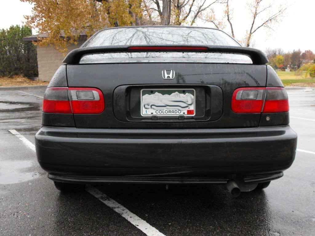

uhhhh sorry, but i have non-sleeper question lol..
Are these Egay red/smoke tail lights?? Am asking coz I was also gonna get these
Totally stock internals.
Those are the egay red/smoke tails. Fitment was great, and I'm really happy with the way they look on my black car.
