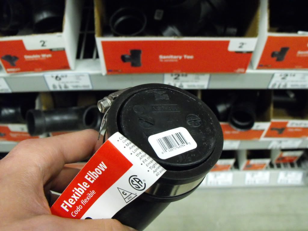

Now go and get this plug. Which despite the 1.5" description will fit nicely in the 2" elbow. I'm no plumber, I can't explain it.

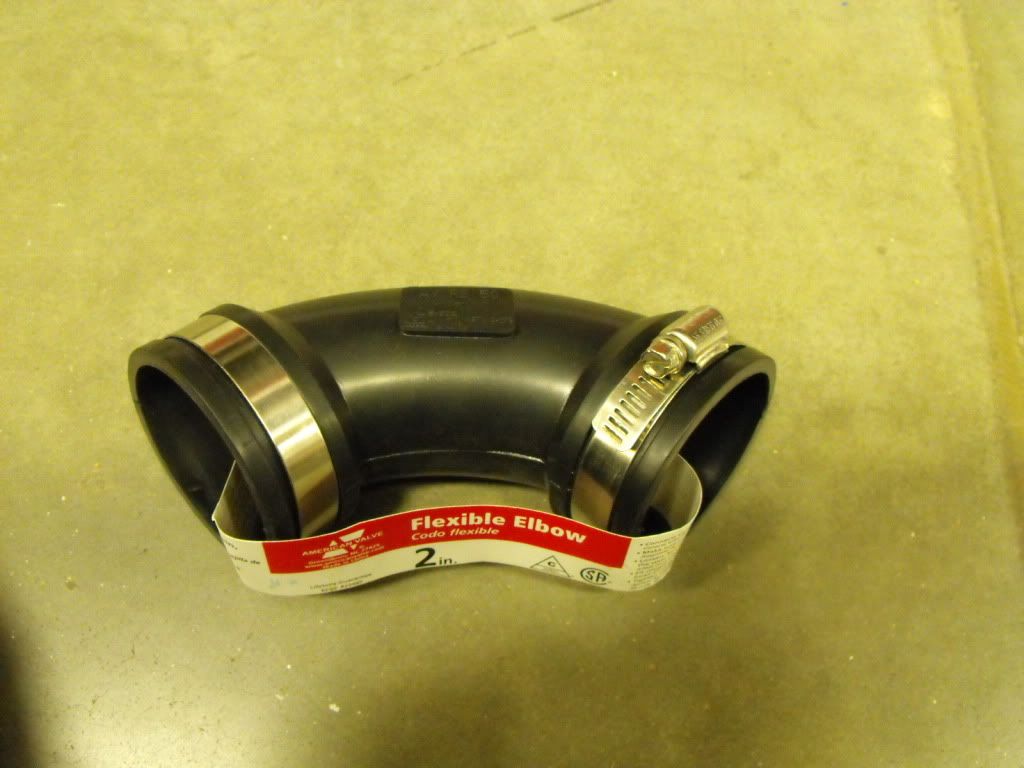

Should fit together for something like this.

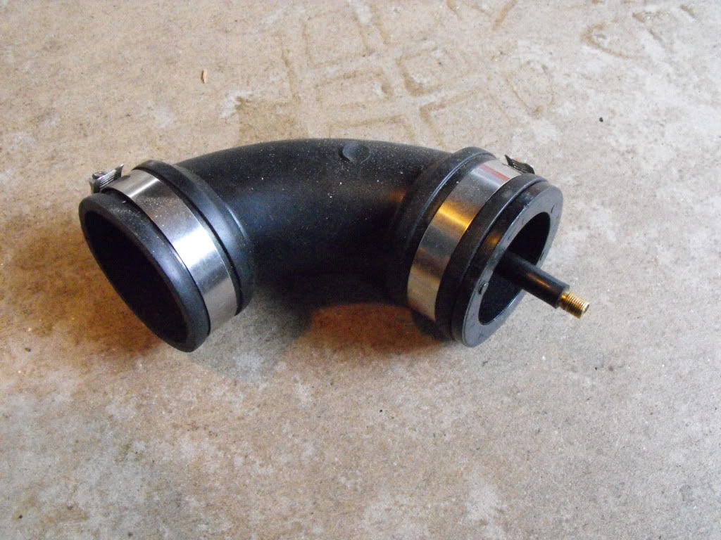

Now go to your favorite auto supply store and get a tire valve stem. You are going to drill a small hole into the 1.5" cap so that you can stick the tire valve stem through it.
* Alternatively you can install a compressor fitting into the cap that you can attach to directly to your home air compressor line. However you will need some sort of regulator on the air compressor.
You should now have a boost leak tester that looks like this:

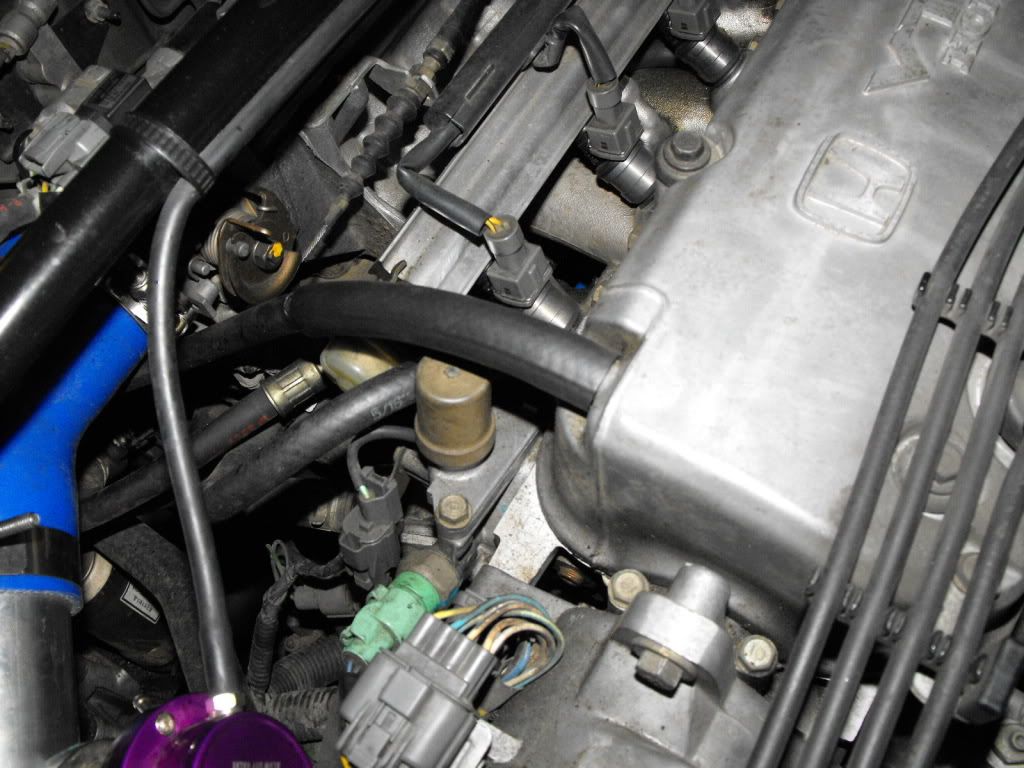

You can now attach your new boost leak tester to your turbocharger inlet. You will also need to block some lines in order to get the best results. Block this guy so that air cannot escape out of the valve cover:
And block your pcv hose.
