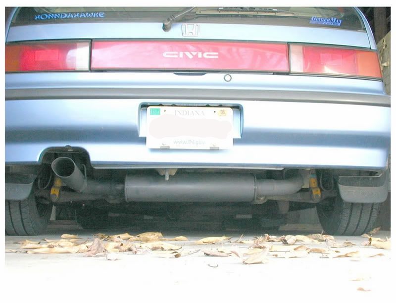

I've used that paint on mufflers and brake drums. It holds up fairly well, but the finish turns more flat black over time.
