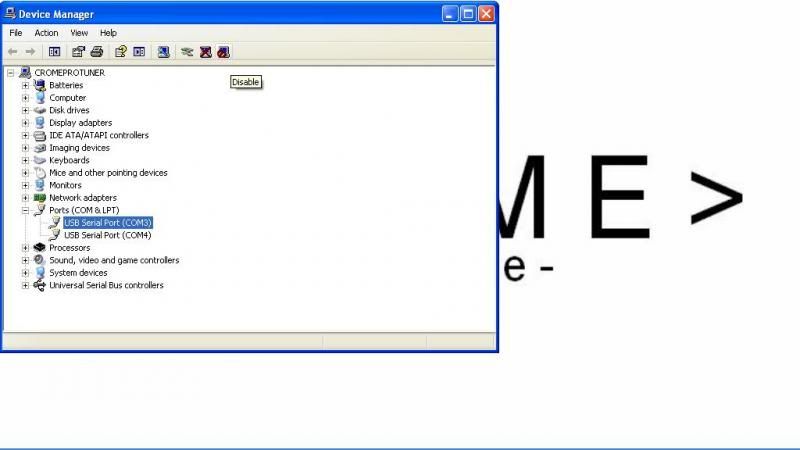

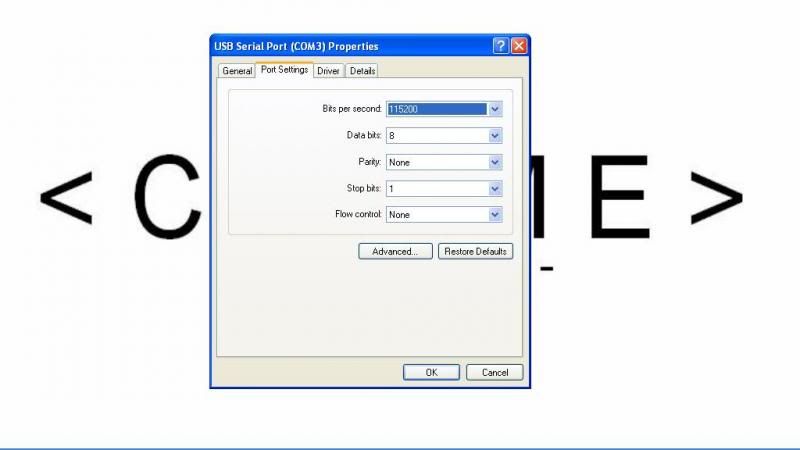

1. Device Manager Port Settings Tab: Windows XP
Bits per second: 115200
Data bits: 8
Parity: None
Stop bits: 1
Flow Control: None
Advanced Button:
COM Port Number: COM3
USB Transfer Sizes:
Receive (Bytes): 4096
Transmit (Bytes): 4096
BM Options:
Latency Timer (msec): 1
Timeouts:
Minimum Read Timeout (msec): 0
Minimum Write Timeout (msec): 0
Miscellaneous Options:
Check next to Serial Enumerator.

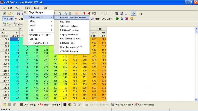

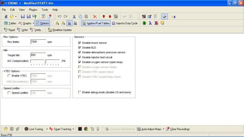

Before you write the basemap to Ostrich 2.0 make sure you go the [Plugins] tab at the top of the CROME Pro window. Under [Enhancements] be sure to [Reove Checksum Routine] as well as add [Quick Datalogger +RTP].
Then in the [Options] button be sure to adjust all the parameters you’re wanting to modify, also be sure to put a check mark next to [Disable oxygen sensor (open loop)] if you plan on using your wideband sensor for datalogging.
After all of that has been done, you can now [Write] the map to your Ostrich 2.0, after it has been written it is always a good idea to [Verify] the data written to the Ostrich 2.0. If all checks out you can now attempt to start the car.

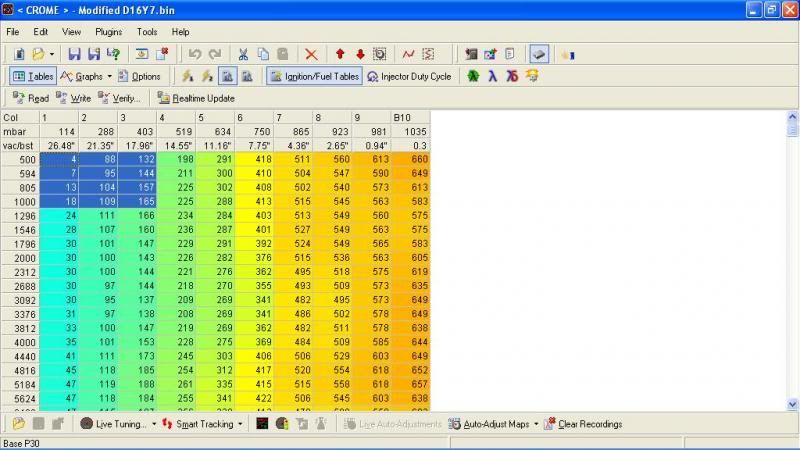

Also another thing that is good to note, is under the Settings window of CROME Pro under the [General] tab is the [Selection Adjustments]. Here you can setup the adjustments for how much you increase or decrease the individual cell numbers when leaning out or richening the fuel map. I personally like to adjust by 1% at a time.

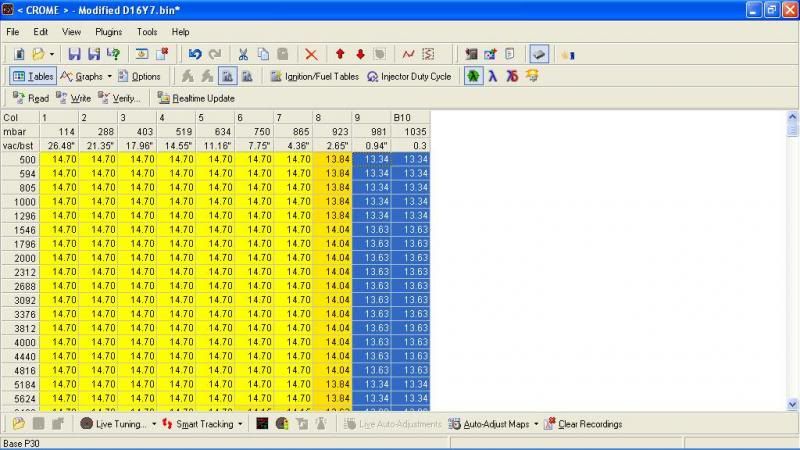

Now that we have a few of the basic settings setup to our favor the next step is to open up the [Show Target Lambda] window or (F10) shortcut. This window is what you want your target AFR to be, for an example I setup rows 1-7 to 500RPM-7936RPM at around 14.7:1. Column 8 to around 13.6:1, and column 9 and 10 to around 13.3:1. You’ll notice that if you select the entire row at once to adjust that the top row will be obviously richer than the bottom row. But once again these are going to be the target AFR, you’re not going to get every cell in every row and column to these target numbers. But you do want to get as close as you can. You’re numbers will most likely be different from mine. I used these above just as an example.
Also notice that when you’re in F10-F12 windows, whatever cell, row, or column you’ve highlighted will also stay highlighted when you go back to your [Ignition/Fuel Tables] or F9. This way you do not lose the spot on the table you were working on.
With an understanding of everything I’ve explained above you are now ready to start adjusting and tuning your engine. As stated before starting with your idle range 500RPM-1000RPM which would be the first four rows and columns 1-3. Highlight all of these cells, and use your shortcut keys (pg up) to increase the value or richen up the tune. Or (pg dn) to lean out the values and the tune, if you are doing real time tuning you will actually notice instantly a difference in the behavior of your engine. And it should reflect in your AFR gauge readings. I’ve always tried to be around 15.3:1 AFR at idle…

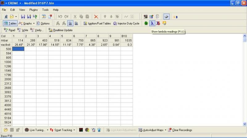

Now that you’ve made your first changes and you’ve noticed the difference in how the engine is running. It’s time to hit the road and start datalogging while you drive around town. It is always smart and safe to have a friend in the passenger’s seat working the laptop while you drive the car.
After you’ve driven around getting a good amount of data in your [Show Lambda Readings] of F11 window. You can take it home or park somewhere to make your adjustments within the cells, rows, and columns of your fuel map. Remember whichever row or column you have highlighted will also reflect in the [Ignition/Fuel Tables] so you can compare the current value to the data retrieved from datalogging.
Within the data retrieved if you see a value for example -6.78% within that specific cell that means you need to ADD roughly that much more fuel to hit your target Lambda value. If you are to see a value such as 6.78% (without the – sign) that means you need to lean out the value by roughly that much. But instead of adjusting that individual cell by itself it’s actually a good idea to highlight that entire column and make the adjustments together. If you go about adjusting each cell by itself you can get a rough tune where in the [Graphs] window you will see the tune have jagged lines and not so smooth transitions from one cell to the next. If you adjust each column together there is a much higher chance of a smooth tune throughout the RPM range and map.
So for example we are looking at column 5 from 500RPM-8000RPM, we notice that the whole column is running a little too rich. We see values going down the column such as .50%, .68%, .72%, 1.10%, 1.80%, 2.05%, 2.61%, 2.94%, 3.20%, 3.05%, 2.90%, 2.66%, 2.10%, 1.83%, 1.55%, 1.09% ect… You can look at the entire column and notice as the RPMs rise the tune becomes increasingly rich and then starts to lean out a little bit. You can take all the values and get a general idea how much you want to increase or decrease the values. As for the example you can get a general idea that you can lean out the values by around 2% over the whole range. You do this to each column until you’re happy with your adjustments. You then clear out your data recordings and go back out on the road for another round of datalogging. You repeat these steps over and over until you have your tune at its target AFR and you feel your engine is running smooth and efficient. Next step after that is to take a look at your map through the either or both of the 2D and 3D graphs. You can look at the maps to make sure that the lines are a smooth transaction throughout the whole range, no jagged sharp jumps anywhere. If there is you can actually take the line and move it where you see fit. Then to be on the safe side, after you’ve adjusted the map go out and do some more datalogging.
