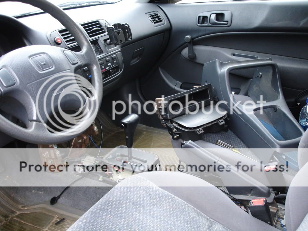

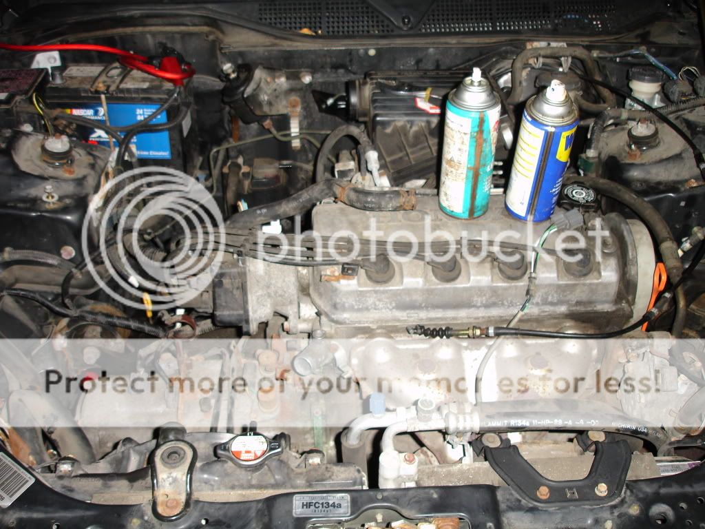

Well figured I would post the project in works here. For starters its a 98 dx hatch. Auto was the suck so that has been the first project. hopefully done this weekend. But also the spring turbo project in the works! here are a few pics of whats up thus far.
The stock DD..... before I started ripping her apart.

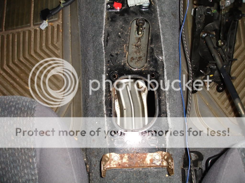

The beginning of loosing the auto

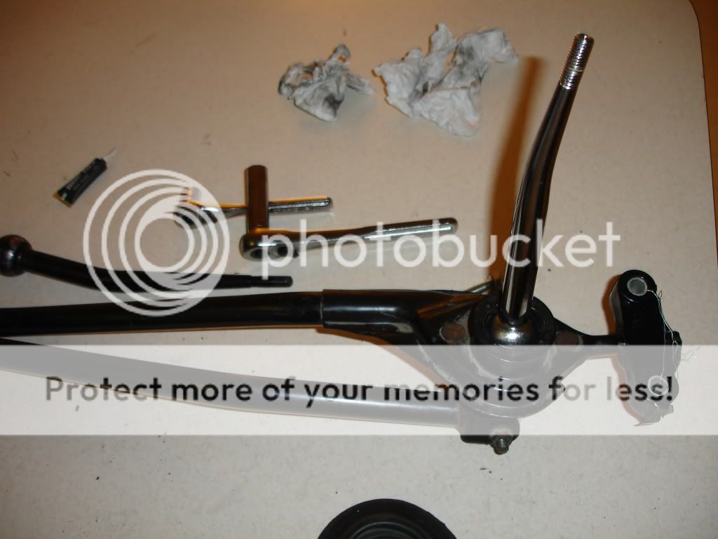

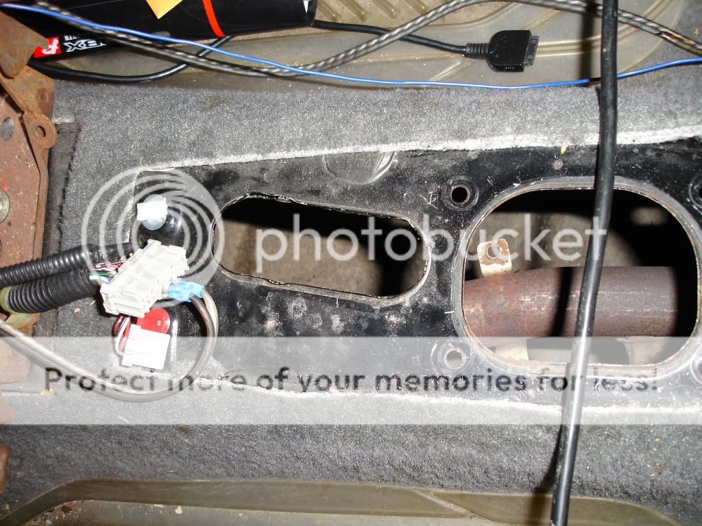

Shifter out

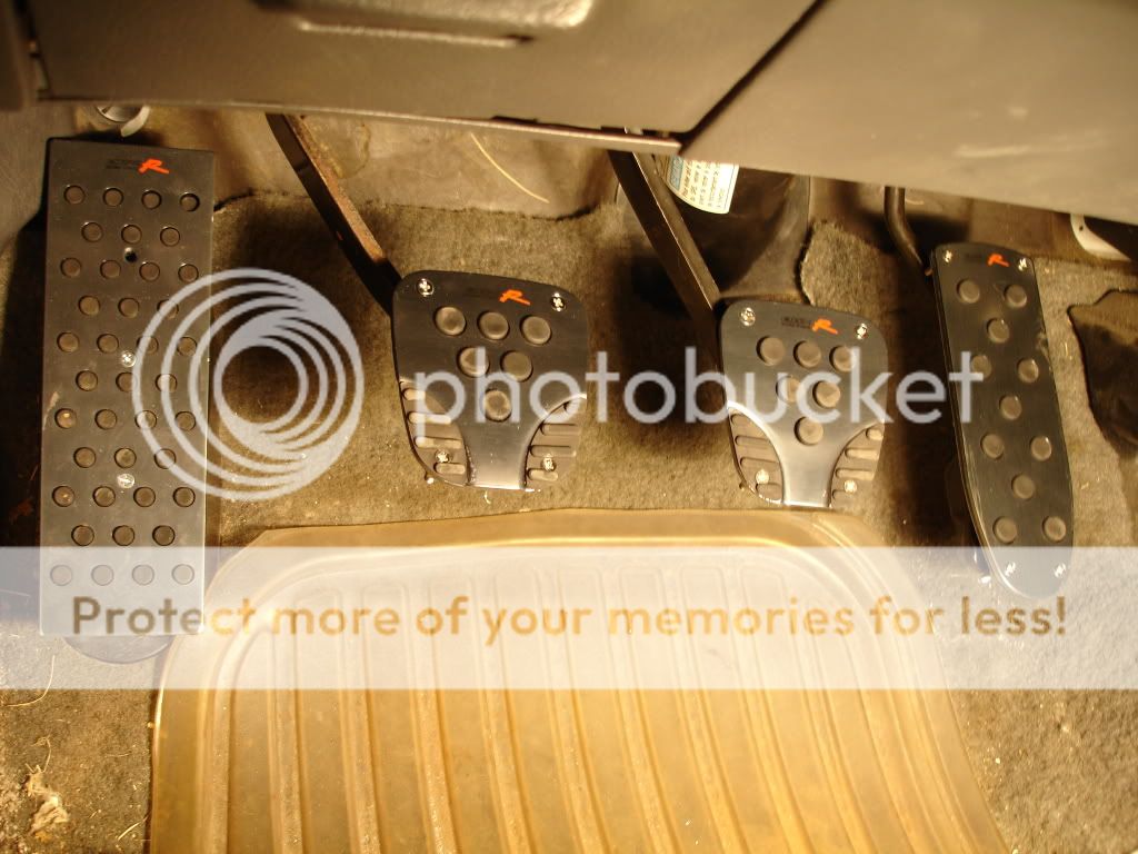

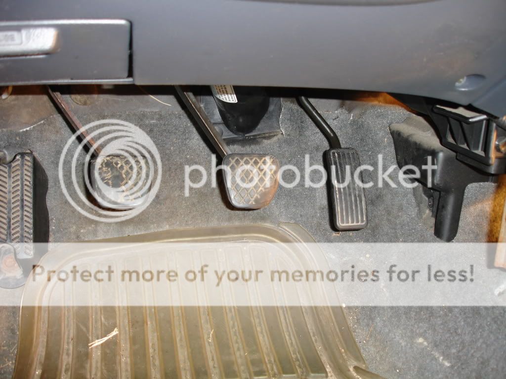

Pedals in! shit, what a pain in the ass!

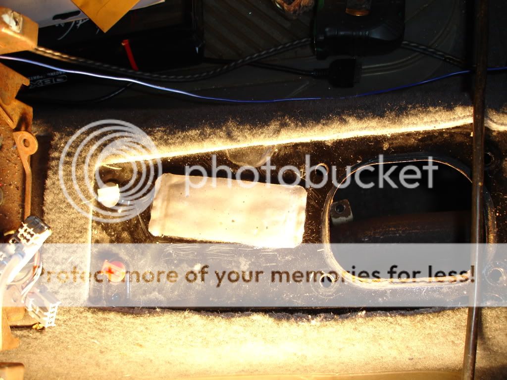

Some covers for show.......

please... no covers.
also. got pics of the E-bay. and the shifter in the cabin ?
good start. I am doing the same thing. good luck!.......

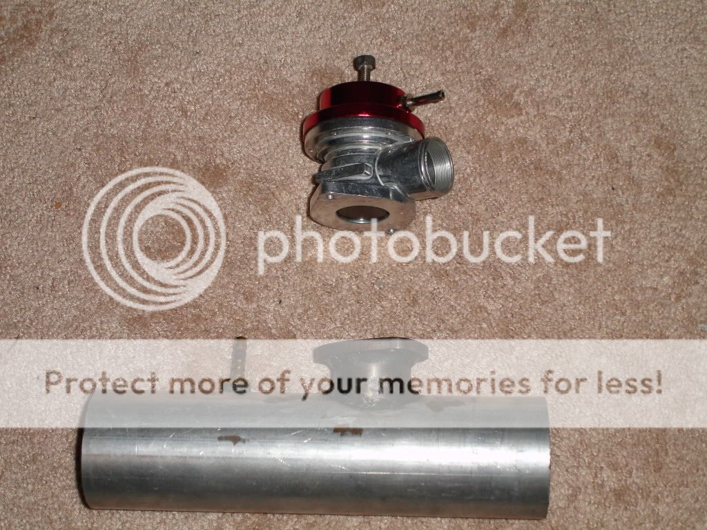

And for the turbo parts.... thus far anyway, and some I missed that are sitting in the buddies garage.

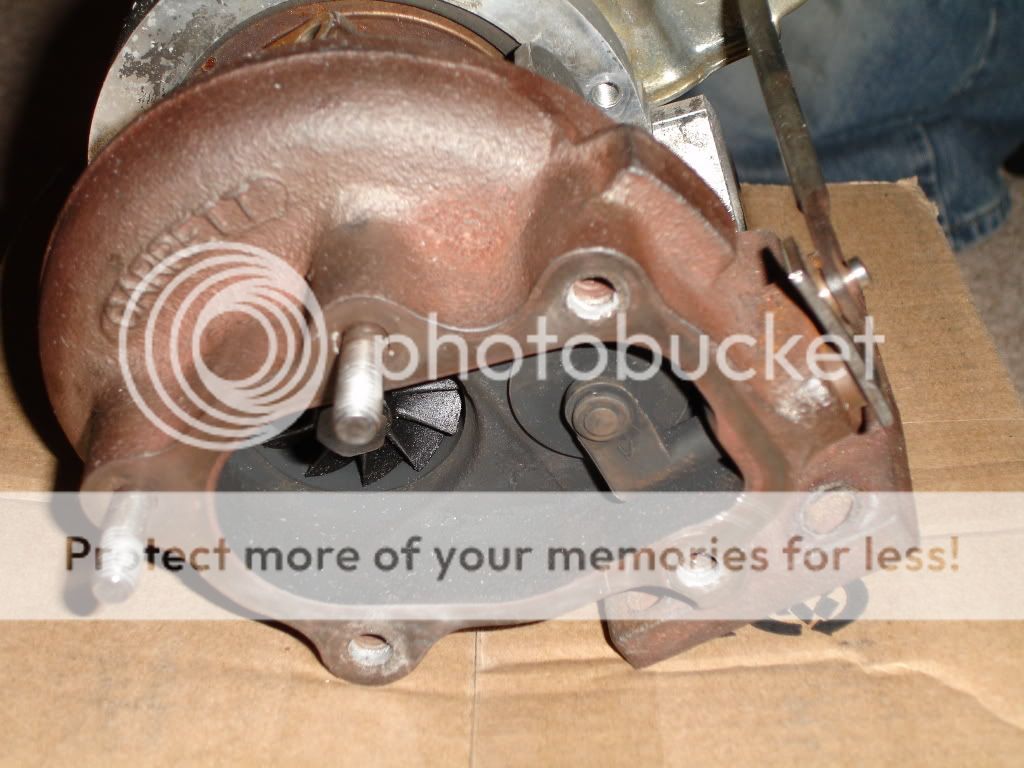

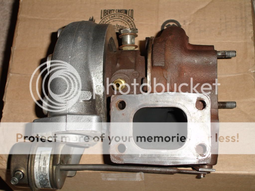

Snail
Cheap ass BOV

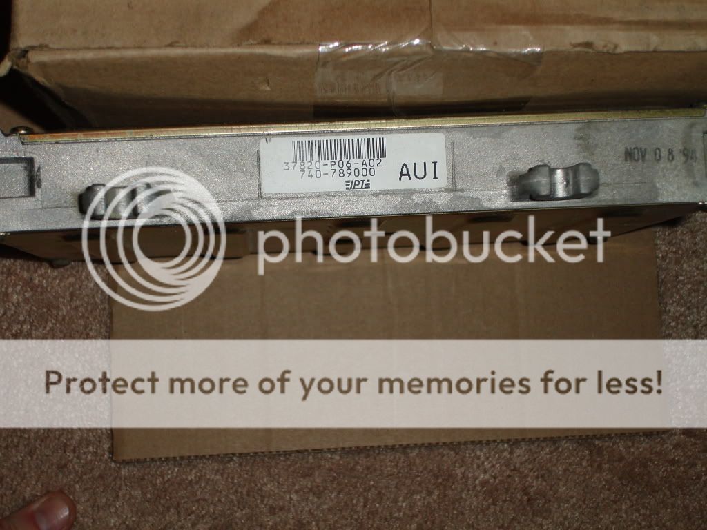

P06 ecu, waiting to be sent in to be chipped when I get my shit all figured out

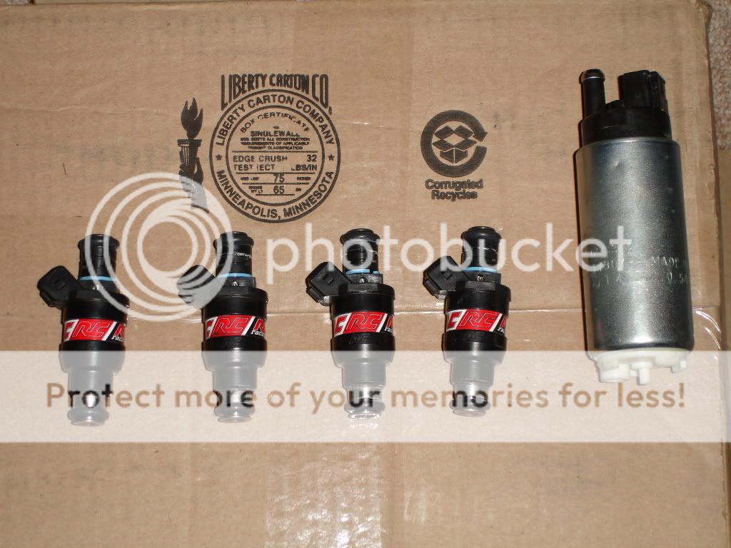

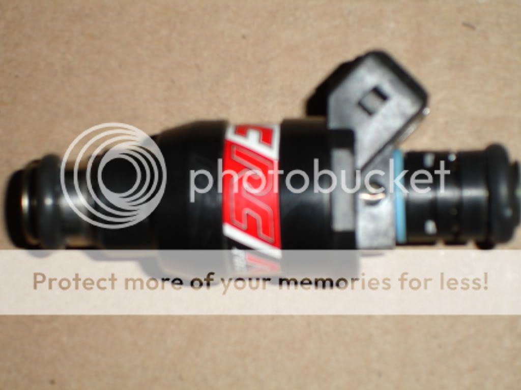

Walbro 255lph and RC 370cc injectors

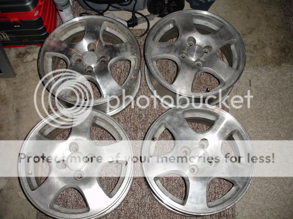

AND some old school GSR wheels waiting for some gunmetal powdercoating

Aw now, I like the covers, they are in there proper..... no clips. And besides the old pedals were teh suck.
and yes bay pics and shifter in pics this weekend after I get that nasty wind tunnel hole coverd, bleh.

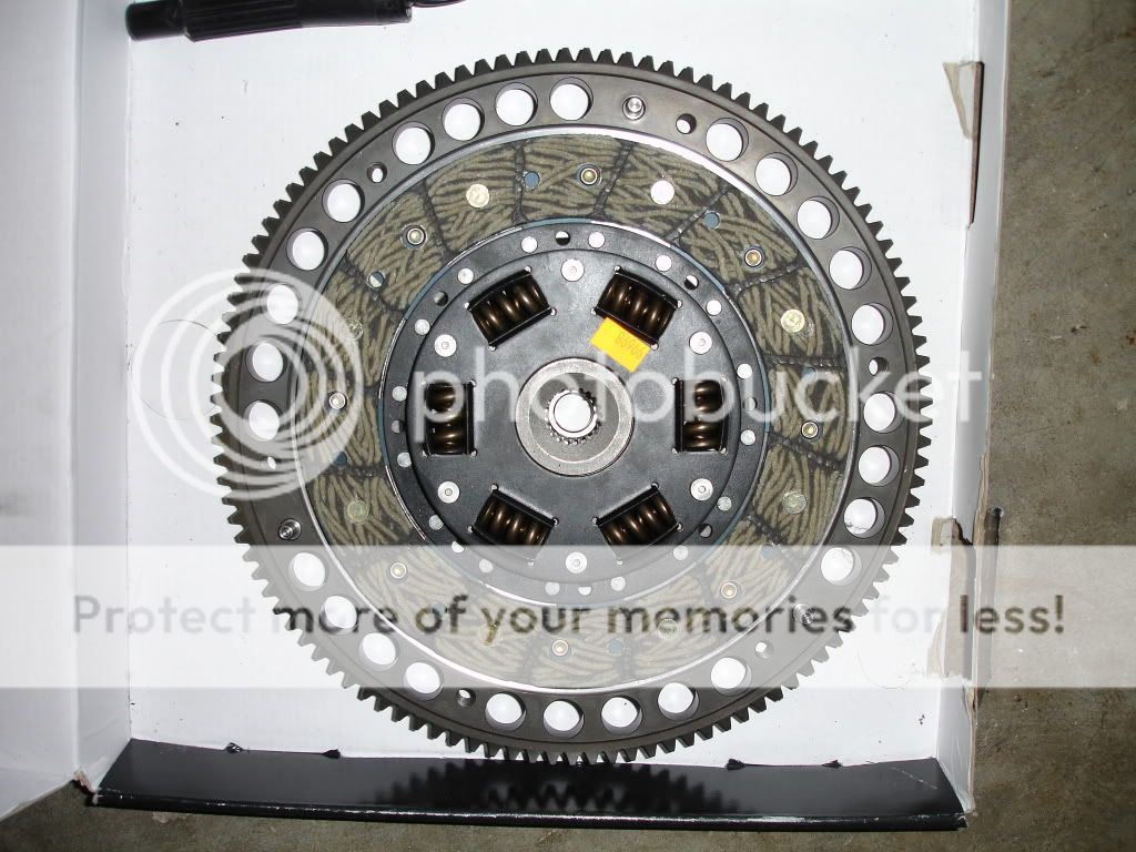

Stage 2 F1 clutch kit and 8lbs flywheel.

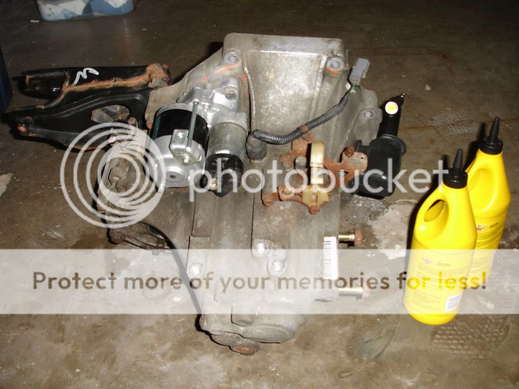

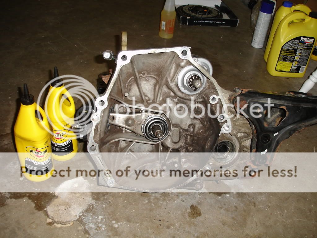

95 DX tranny, would have prefered an EX but found this one local for a good price so went with it.

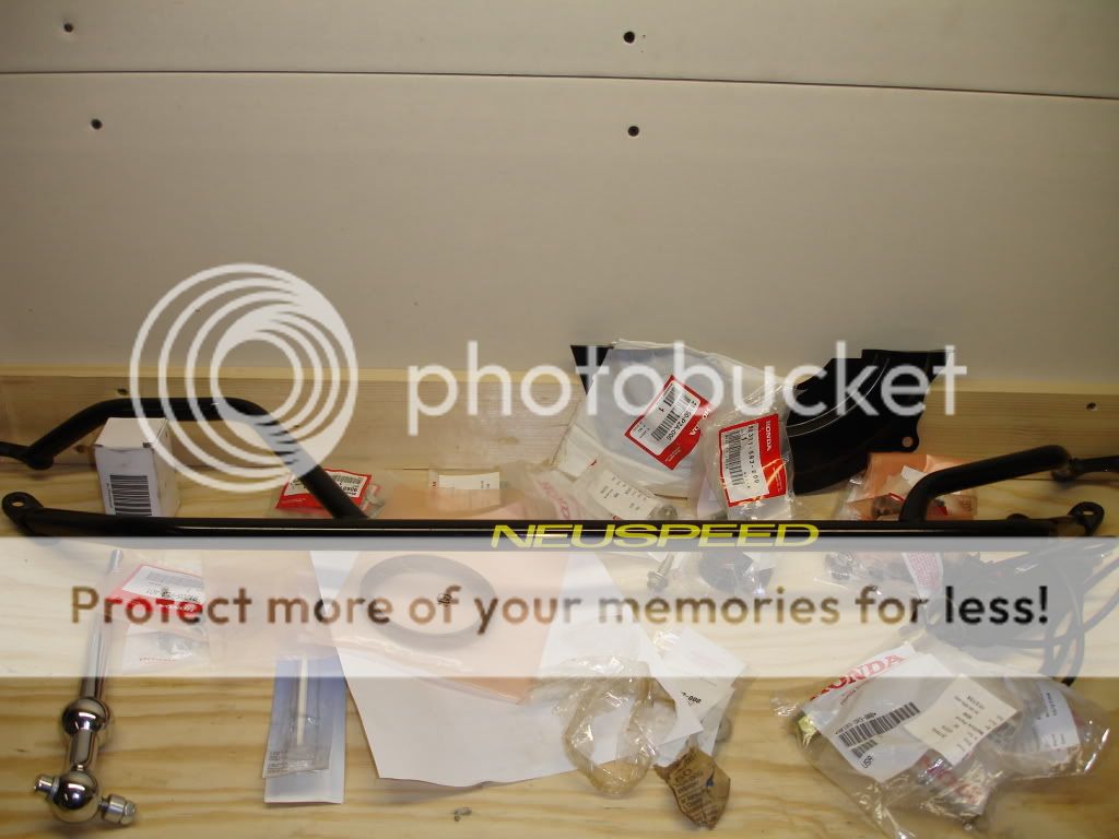

Strut bar

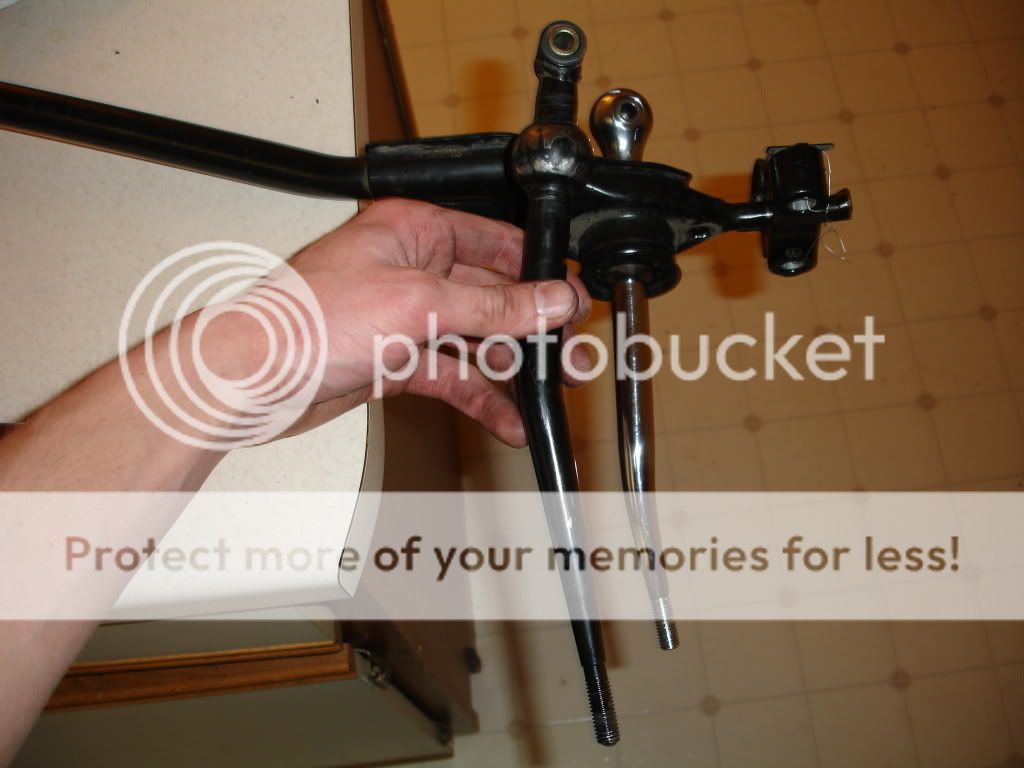

Short shifter

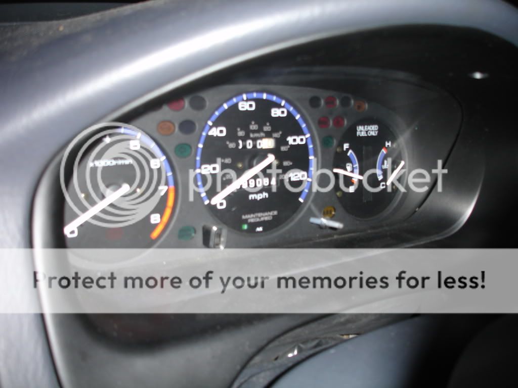

cluster with tach... for an a/t with my little... ummm ghetto fix for that

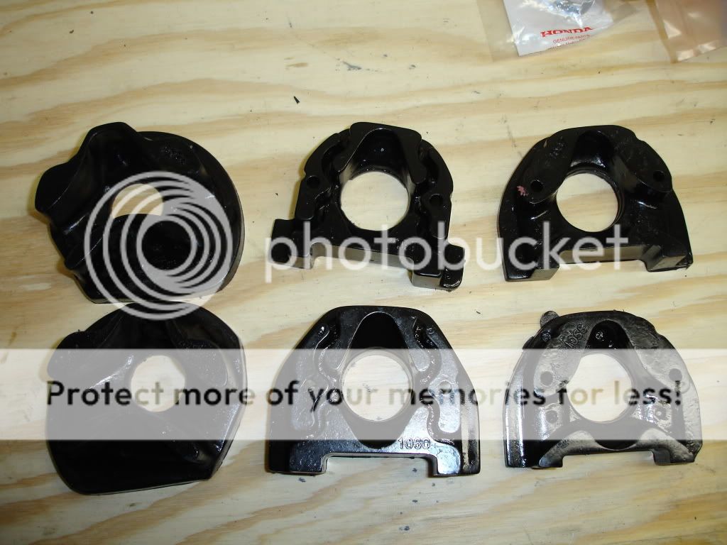

Mounts and poly inserts

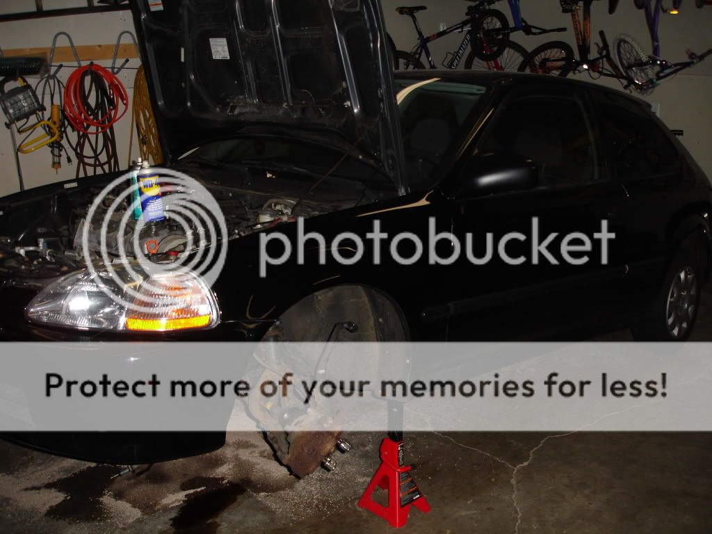

As she sits, waiting for the motor to come out

what turbo is that?
