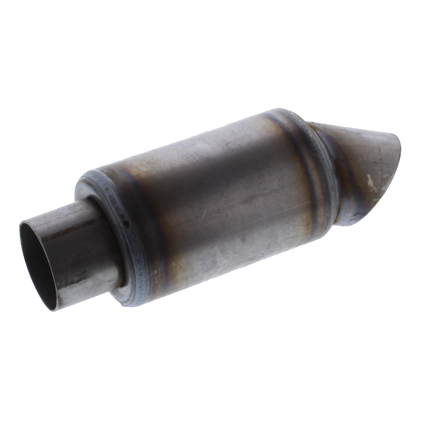

So back to hondas. If i am looking at compact mufflers do anybof you guys have experience using them?
Im assuming its gonna be loud no matter what but am looking at the vibrant ultra quiet resonator and then finishing it with a unit I found online that looks like a compact race bullet style thing with a 45 degree tip. Search beyea 2.5 inch header muffler to see it, im not sure if im supposed to post links. Its 2.5 into a 6 inch body with a 3 inch tip.
How much clearance do I need for things, and should I be looking into blankets and wraps?
you can post links, if its something that shouldnt be here, Im sure someone will take care of it ;)
  • Haha
Beyea 2.5-3" header muffler as tip
vibrant ultra quiet resonator 2.5" 9.75" long case, 4.75" wide x 6.5 tall oval, 13.75" overall length
plan would be turbo to vband 90, flexpipe, 90 off flexpipe, short pipe, resonator, pipe, header muffler
just worried that oil cooler plumbing and intercooler piping will be complicated by this, and how close is too close. I have some gold reflective tape and am not entirely opposed to header wrapping the exhaust.
Wrap would help keep slow moving iats down, about 1.5" clearance between things should allow enough movement to keep things from touching under power.
