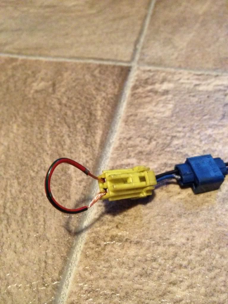

5,819 Posts
Unplug the clutch switch and stick a piece of wire in both ends. Pic shows what I mean.
I was wondering what my boy was doing he already checked it that way when we checked the grommet and it wouldnt start either. but i will check again the only problem is that i wont be able todo so till wednesday or saturday. If this works what should be the next thing i check?

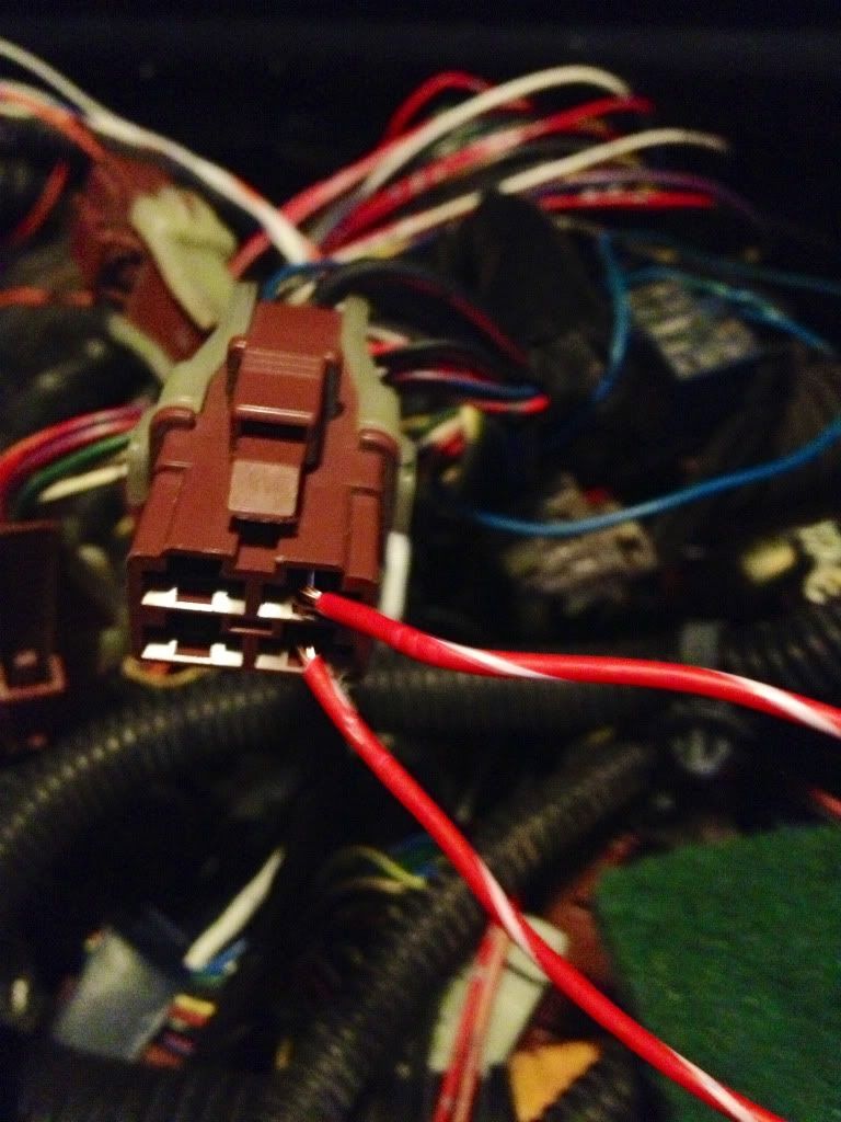

5,819 Posts
If jumping the clutch switch doesn't work then the problem is else where. If it does the the clutch switch is the problem.
Before doing this next step make sure you have power going the both black/white wire at the starter relay plug while cranking.
If jumping the clutch switch doesn't work the next step is to jump the starter relay plug. The pic below shows how to do it exactly. One black/white wire jumped to the black/red wire. It doesn't matter which black/white wire you use as there the same. Once jumped turn the key like you normally would and see if it starts. If it does the starter relay is the problem.

So I jumped the Clutch Switch and the Starter Relay and neither items worked. I also checked the voltage on the starter signal wire and it shows that it is getting about 12.3 volts. I googled how to check the ignition switch but its a bit confusing hoping to figure it out by friday since then i have been jump the starter signal to get the car on.
