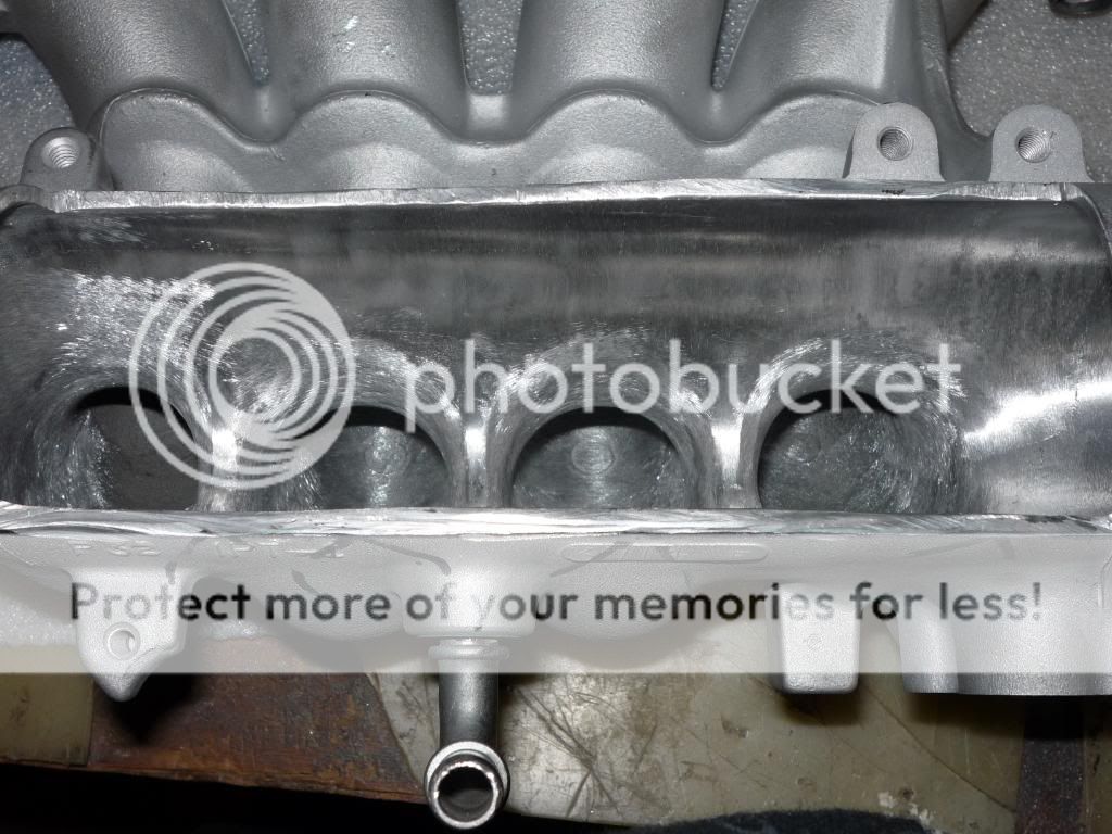

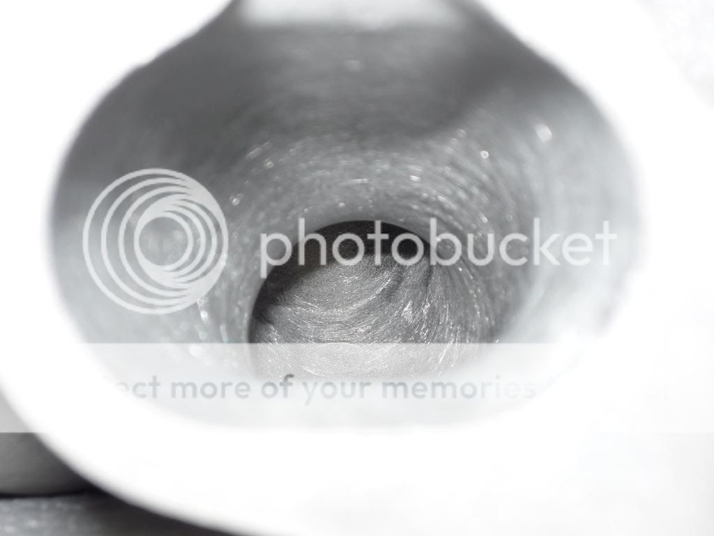

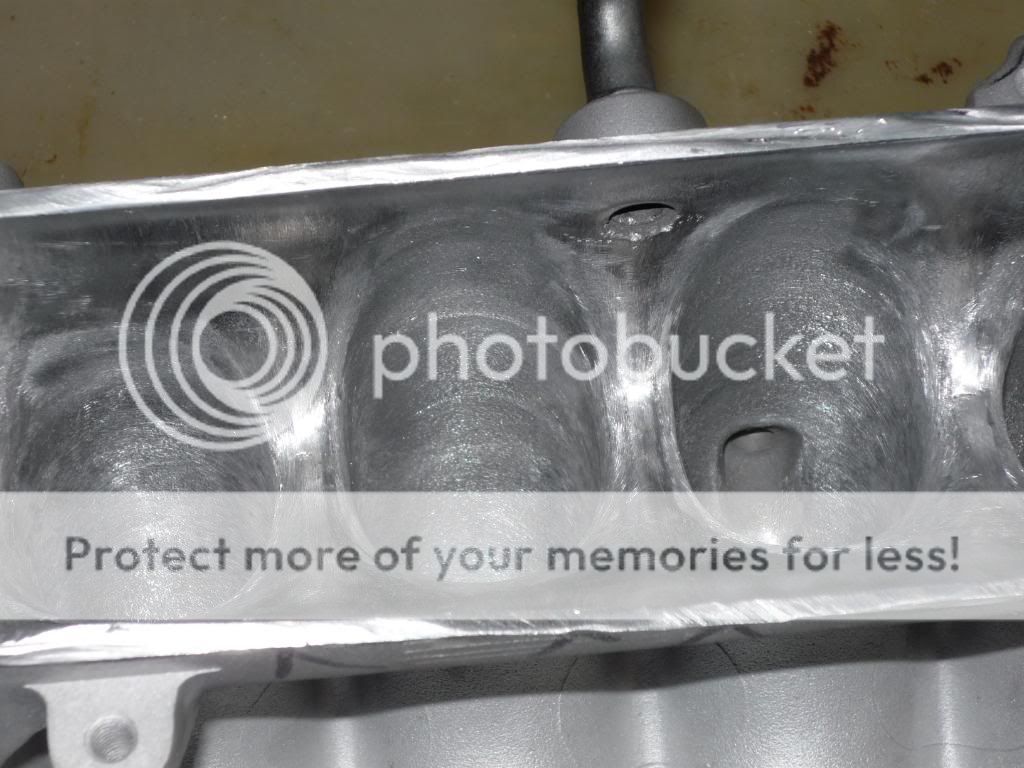

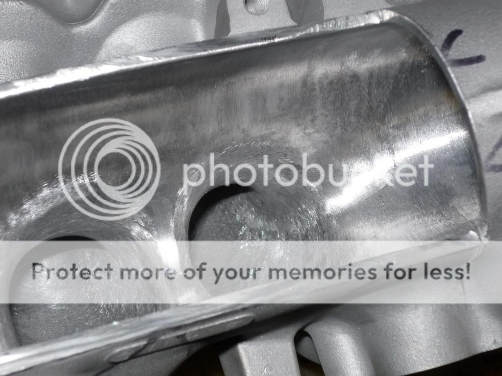

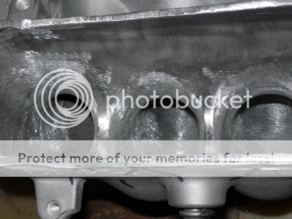

My head in the process of being Ported and Polished By ME!
Intake Manifold
Well?

look up my post in this section about Porting a Z6 mani. You'll thanks me later

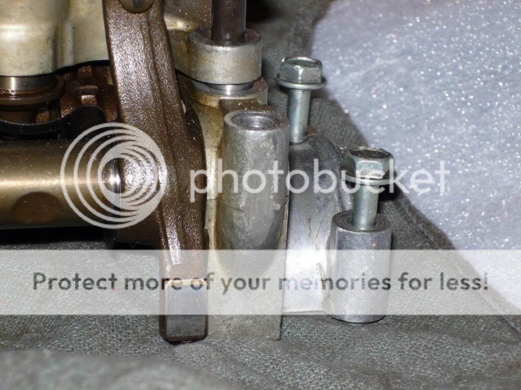

I had to fix one of the camshaft holders, it had a broken boss where the thread was. I welded it up, honed out the bore where the rocker shaft is(it had moved a bit from heat of welding), machined it down, re-drilled and tapped for insert. Here are some pictures.
My repair pic is kind of blurry, ill re-take. unfortunately i dont have the valvetrain with me right now and i didn't know the picture was so crappy. 2nd picture is of what a normal camshaft holder(although it is an end one, and looks a little different but you get the idea.)
Lol, what do you think?
