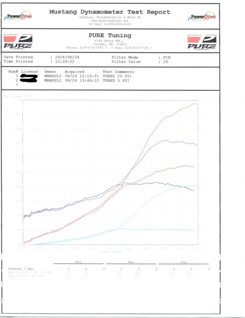

I just got my car tuned yesterday. I made the short drive from Detroit, MI to Toledo, OH to see Aaron at Pure Tuning. I got there WAY too early so I went and grabbed a coffee, washed and vacuumed my car, etc. then headed back. First of all, Aaron was super friendly and knowledgeable. The shop was nice and clean, easy to find, etc. Aaron had never tuned with eCtune, but agreed to give it a shot. I showed him where a couple features were, and that was it, he took over from there. Full tune from scratch cost $600, which I felt was fair for the amount of time he spent tuning the car, and touch up tunes are just billed hourly. Overall the experience was great, and I will be going back to Aaron for touch up tunes as I continue to build my motor.
On to the fun stuff. The car put down 270whp/207lb-ft at 20.5psi. I was really hoping to crack 300whp, but alas, 270 it is. It was an AWD Mustang Dyno set to 2WD mode. Revving it to 7100 rpm, so stock revs. The car pulls hard, and is a lot of fun. I think my head is really choking me up. The lower graph is 207/136 @ 5.5psi. He said this was the highest pump gas D16 he's tuned, which was cool. Also he said it was NOT the rustiest :) He did a 305whp D16 on e85. I can't wait to go back with a built head.

hmmm.... power numbers seem low to be honest.
stock heads have went 400whp, and yes they choke it up but at your power level it should not be that big of a deal
at 20psi I would expect to se another 100whp out of a holset....take the thing to Milan and lets see what it puts down.
and research that 272-2 before you buy....there is a reason im back on a stock cam

I also felt the numbers were a little low. But hearing the number from other D16 builds, I was wondering if maybe this wasn't one of those "heartbreaker" dyno's? Where the numbers just aren't there. Not sure.
I need to get some slicks and go out to Milan and get some numbers. We'll see when I can scrounge up some cash for slicks. I'm getting married in September so cash is thinnnnnnn haha.

I think only spinning it to 7k is why your power seems low

Mustang dynos seem to show the lowest output, if it were on a hub dyno then you would easily see over 300whp. Also revving a little higher might bring power up a little higher. The trap speed in the 1/4 mile will give you a good idea of power, so if you ever hit the track you will know. Or just find a hub dyno near you and see what power you make on that. Remember HP/Tq numbers are just that, numbers.
That's exactly what I figured. I'll take it to the track and put it to the test. It could have dyno'd at 500hp, but that wouldn't mean shit if it didn't have better than a 14 second pass in it. People get hung up on dyno numbers and forget things like suspension, driver skill, weight, etc. I admit, I did get a little hung up on the 300whp number, but I just had to remind myself that, like you said, it's just a number.
I was planning on waiting until I get a set of slicks before hitting the track, but I'm thinking maybe street tires so I can get used to a FWD turbo car and everything. I've done AWD turbo, and RWD n/a, but nothing like this. Might save me from breaking something too.
