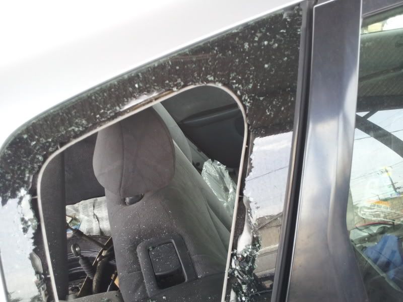

Monday morning, I went down there to find this:
A clickable video for comparison:
For those of you who know my car, the glass is supposed to look like this:
It goes without saying how upset I became about the situation. *Then I got depressed when I saw this:

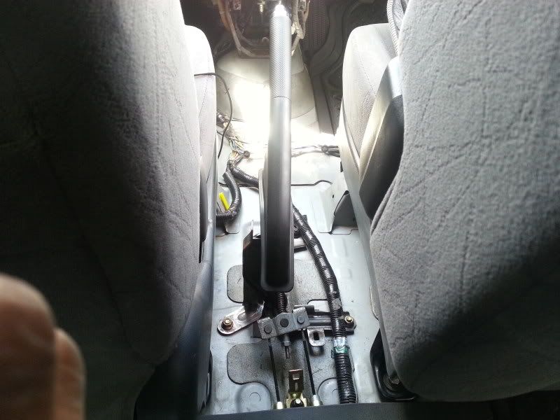

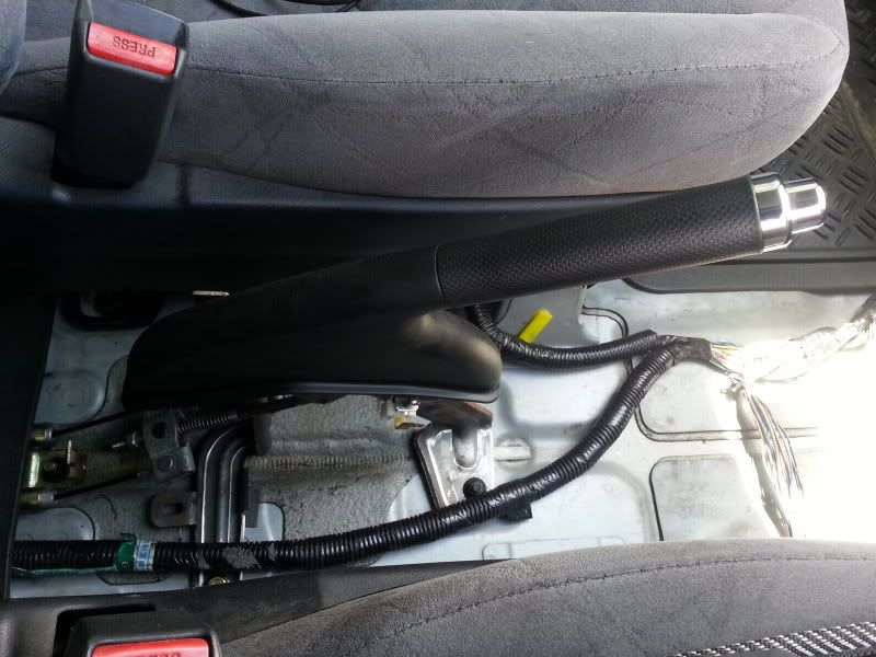

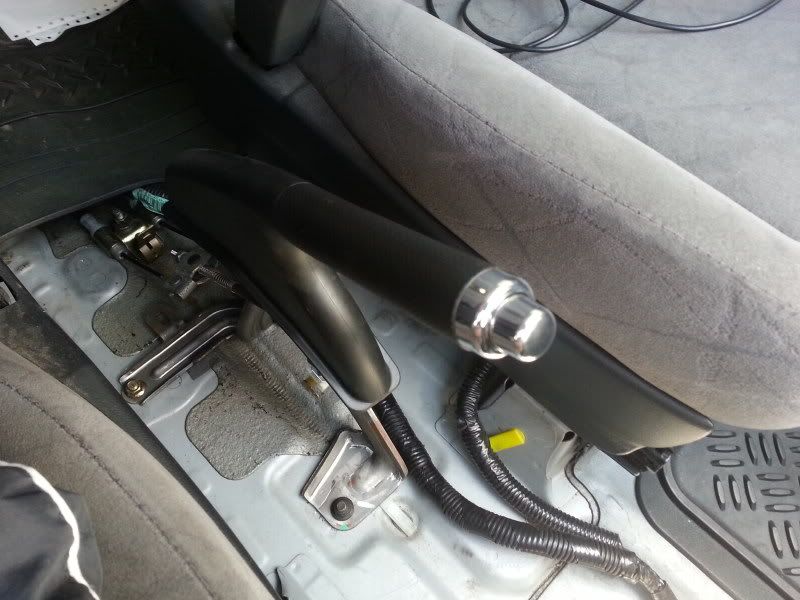

Andrew finally brought down the EP3 handbrake for me. At that point, I had realized that there is a difference between the LHD & RHD handbrake, but it fits my application quite fine and I just need to remember to get the LHD center console for it. I wasted no time locating the three holes that would need to be drilled and the section of the chassis that the two slots would need to be drilled to accept the pair of handbrake cables.
This is where the pair of handbrake cables currently originally came through under the passenger seat for the foot operated handbrake:

I had someone else do the actual installation as didn’t have a hydraulic lift to raise and lower the vehicle several times to meticulously check for the alignment of the holes and the protruding cables that would have to be made. The operation of the handbrake proved that the rear brakes need to be replaced as I had replaced only the front ones the other day. I’m looking to get some custom carpeting done to the floor as I no longer like how the stock one looks. There is also the plastic center console that should surround the handbrake that needs to be ordered. This will also contain the ash tray and cup-holder. This will be added weight, but I think its aesthetics should complete the project.
These are a few photos of the handbrake finally mounted without any carpeting or center console:
