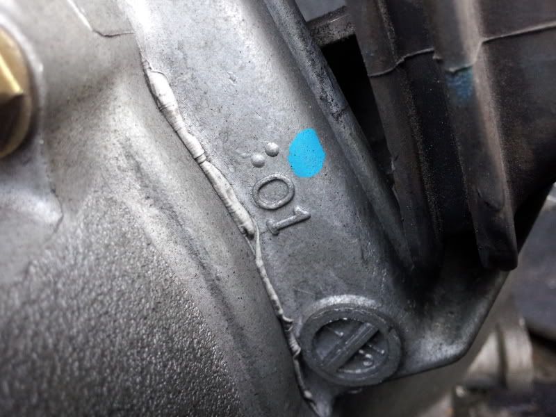

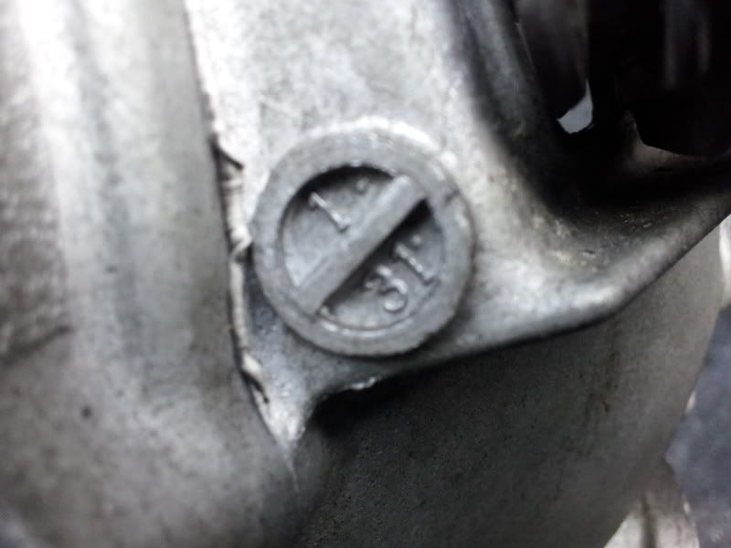

Anyone know what # is on these transmissions. Like p4a b000 or s40 b000???
My gearbox has PLW 3, D5A, and SLW-xxx stamped on it.
I don't know which one it is. I know it came from the seventh generation ES1/2/3 civic. I tried calculating the ratios by turning the input shaft and counting the number of turns required to get one turn from the output (for a specific gear), but I kept loosing track and getting frustrated during the process to the point where I simply gave up.
\/Your Mom Was Here\/
Vibe GT
4,833 Posts
I will have to look at the other stamping marks on my tranny but the sticker is "SLW" and it is the EX short tranny for sure.
Will post up pics of all the markings once I get her back in the air.
All from my 2005 EX civic ES2
