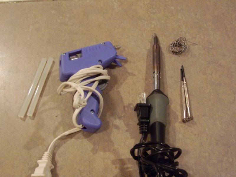

First your going to need tools and the parts.
For tools you are going to need the following:
Hot glue gun
electrical tape
soldering iron
solder
scissors
Phillips precision screw driver
heat shrink tubing
wire strippers or whatever you want to use.
marker

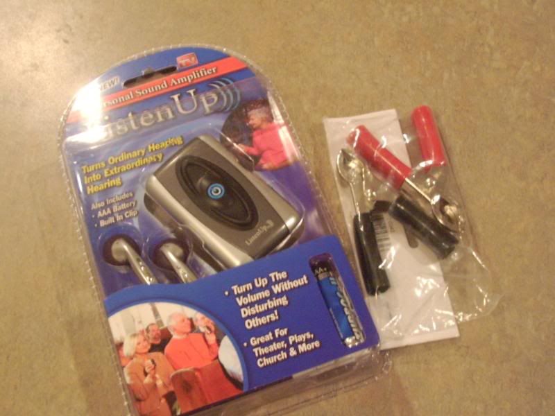

For parts you are going to need the following
1 alligator clip
1 "listen up" personal sound amplifier device. http://www.radioshack.com/product/in...entPage=search
about 20 ft of red and black wire (10 ft of black 10 ft of red)

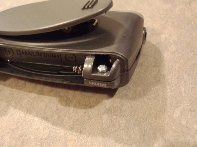

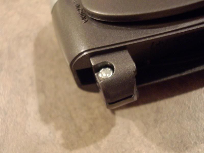

Undo the side of the unit where the battery goes.You will see two screws.One on each side.Take your small screwdriver and undo them.
one side
the other side

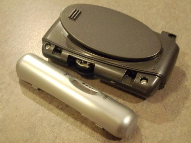

Step 3:
on the opposite side GENTLY pry up the gray part.You will see two more screws.Undo them
step 4:
Now we can GENTLY pry the case off.You will be left with this.

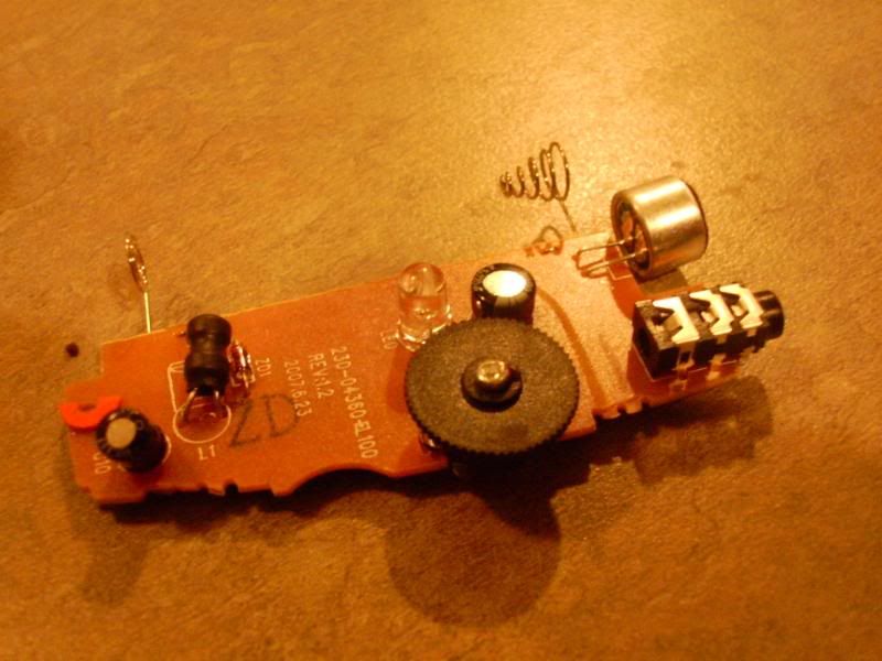

Go ahead and undo the small screws on each side as well once done GENTLY lift out the circuit board and you will have this
This is the part we are after

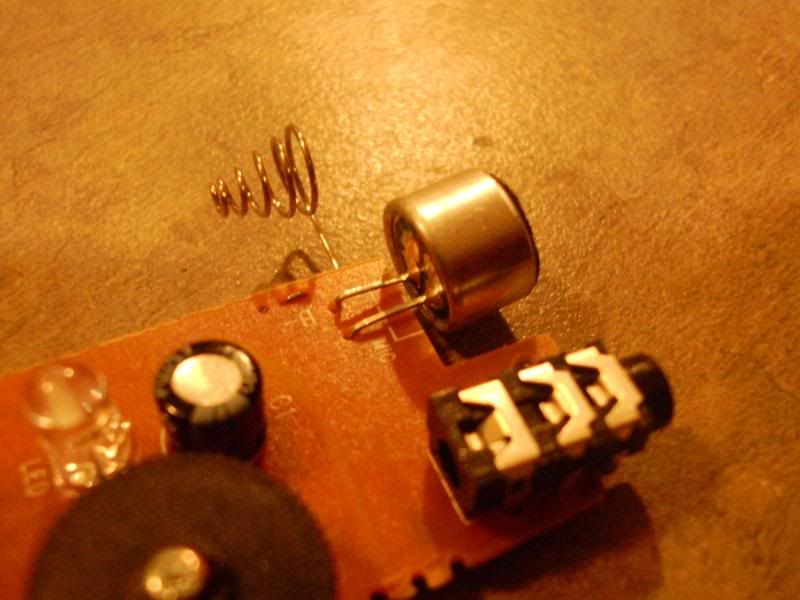

Step 5:
The next few steps can vary. I suck at soldering small components and didn't have the right stuff to de solder the microphone from the board.If you do have the proper equipment and skill to de solder the go right ahead and do it that way.This was easier using what I had.
GENTLY bend the microphone upwards.
It's important to keep the polarity correct, and since the microphone isn't marked positive or negative go ahead and take your marker and make two marks, One on the microphone and one on the circuit board
go ahead and take your scissors and snip the microphone off. Leave a little bit of the leads still attached to the microphone and to the circuit board so you can solder your new wire leads to them.
Step 6:
go ahead and take your soldering iron and solder the wire you have to the circuit board.If you are using red and black wire like me,go ahead and solder the black wire to the side that you marked with a black marker and the red side to the other.
get your hot glue gun and cover the area you soldered.This will act as insulation,and help the wires from ripping out if you tug on the wires too much in the future.You can skip this part if you want
