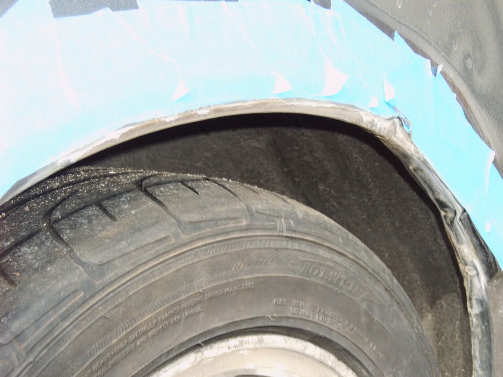

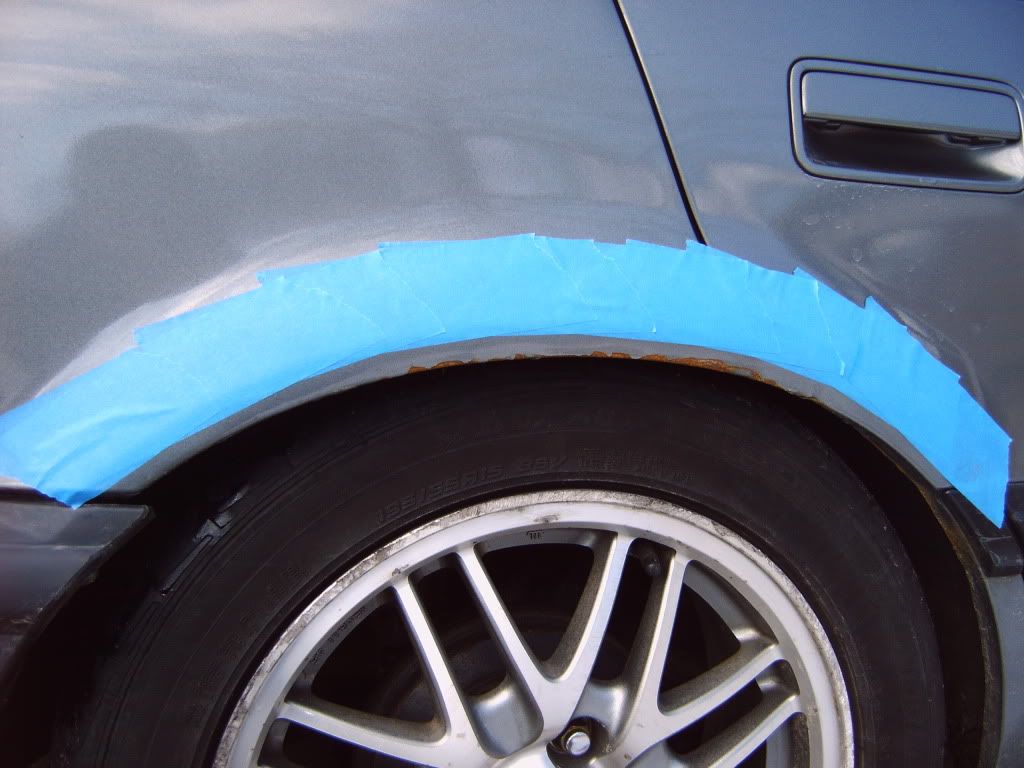

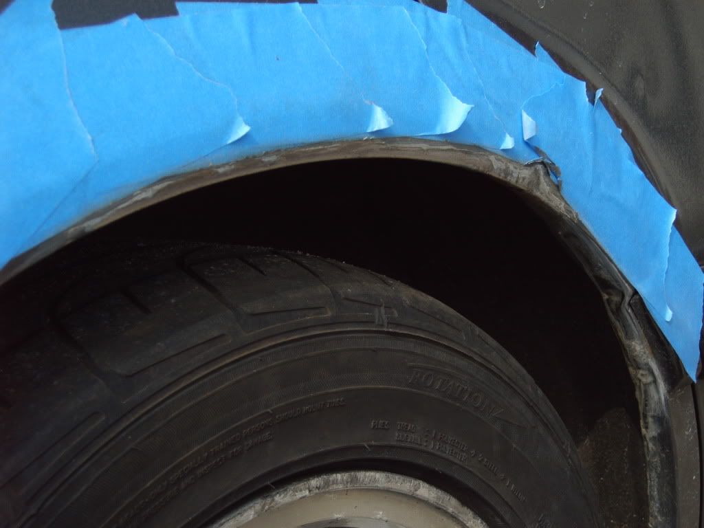

well when my fenders got rolled alot of cheap maco paint got chipped off. thanks to the wonderful city of stl who use way too much salt my cancer spread quick so today i decided enough was enough.
so i got some rustolium primer. then chipped away the paint till i got to good metal. sanded it cleaned it then sprayed. this was just temp so i was just gonna call it good but then decided to touch it up with the maco paint. well that did not match so i tried tibby paint and it matched perfect. so i brushed it on i will sand/ fill/ and paint it correctly when it warms up but just did not want to make the rust worse this was the only bad fender. all others was just the lip so i sprayed those too.
yes all of under the tape had rust fuckin maco

quick tip put a peice of sandpaper over a scotchbrite pad youll get all the cranies

I'd recommend using a sanding block in most cases to avoid getting what the old timers call 'finger fucks' where the pressure from yourfingertips causes a lower spot in the finish while sanding... if you have nooks and crannies...you need to do body work son! till all is flat and even.... but I know when it warms up, you'll do it right, as this is just for now...right?lol

i did
